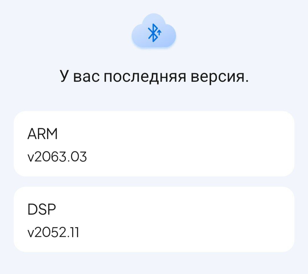

Can I have update of firmware? I have the same issue with overload, when plug AC and don’t charge. Use this device 3 years((((
My serial: EB3A2246001459860
ARM v2063.03
DSP v2052.11
