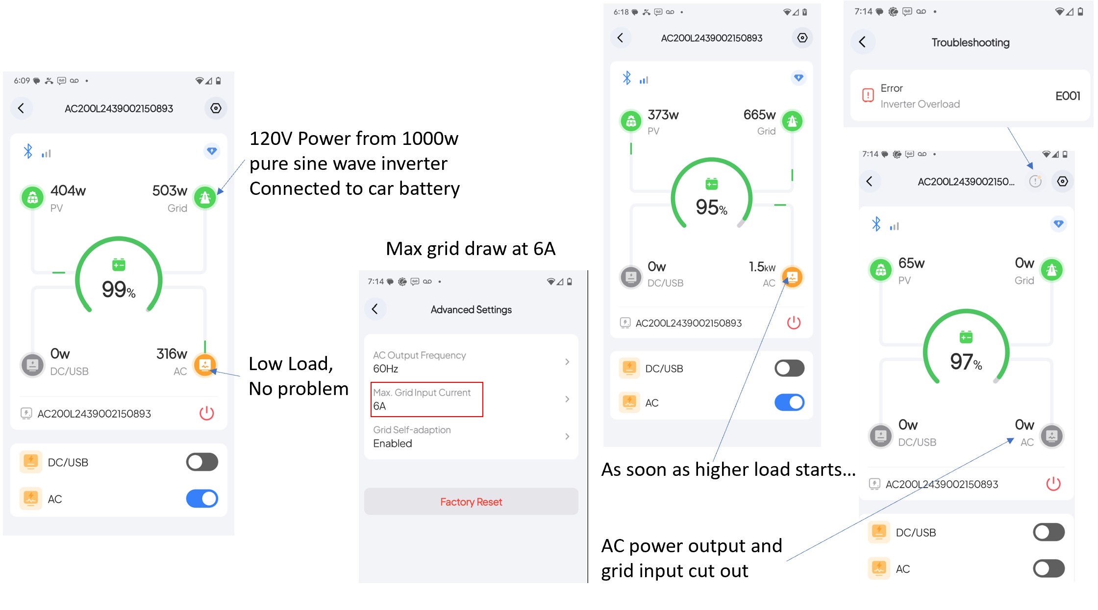

Thanks for the response. Sounds like I need to clarify. I want the power station to charge both with solar and grid without passing the load through to the grid. Attached are some diagrams showing what is happening. Two important things to note while interpreting this diagram. 1. The AC200l has no problem running the air conditioner without the grid connection. The power output from the 30A socket is enough. 2. If I plug the power station into the household outlet, it can work as I intend and will run the air conditioner but draw a reduced amount of power based on the charge limit (set to 6 amps). I believe it works because the household outlet can handle the momentary power demand of passthrough as the relay clicks over and then dials back the current to 6 amps.

As a suggestion try starting the Aircon without the input into the AC200L turned on… and with the 6 Amp grid input set, then turn on the inverter feeding into the AC200L… The challenge is the AC200L can’t predict the load of the Air con… thus it “just” passes the spike through to the source… which can’t handle the spike and it then shuts off… the AC200L goes WTF… and shuts down…

Hi @Thor, Thank you for providing the detailed information. We believe this is an overload caused by exceeding the load range.
Please note that for some machines with built-in compressors or condensers (such as fridges, air conditioning, pumps, and freezers), the surge power will be 3-7 times higher than the rated power, and it will keep several seconds after it is just turned on. Then we will check if our machine can afford it or not. Please consult the supplier of your device for more information.
The starting current of your load is too high, making it impossible to operate. You can use a larger power station to power the air conditioner.

We suggest you set the AC input current to a lower value and enable the Grid Self-adaption mode.
