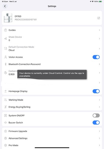

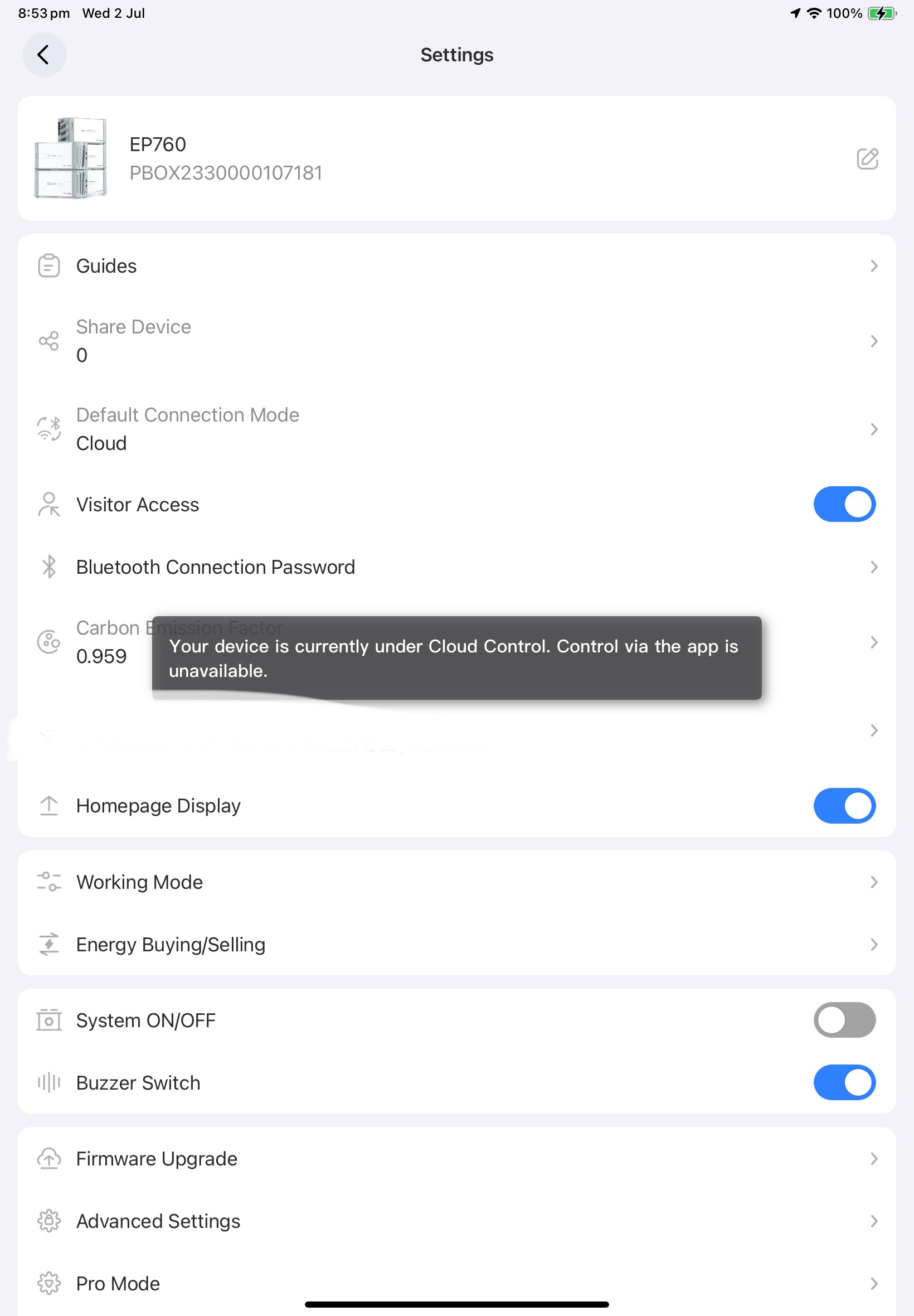

I just received an error when trying to change some settings on my EP760…
“Your device is currently under Cloud Control. Control via the app is unavailable.”
This is a big red flag for me… if there is a safety issue on site I need to be able to turn the EP760 on or off.

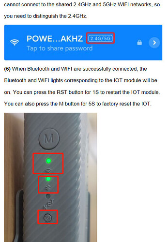

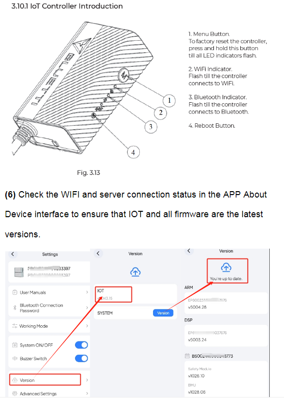

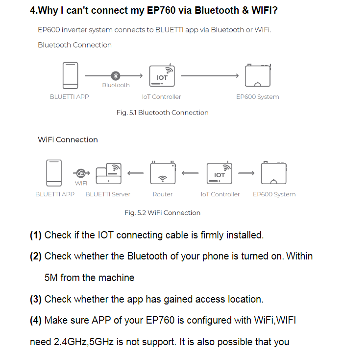

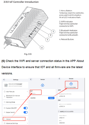

Hi Andrew,

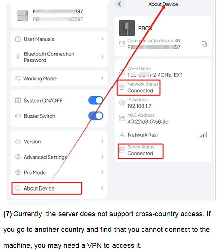

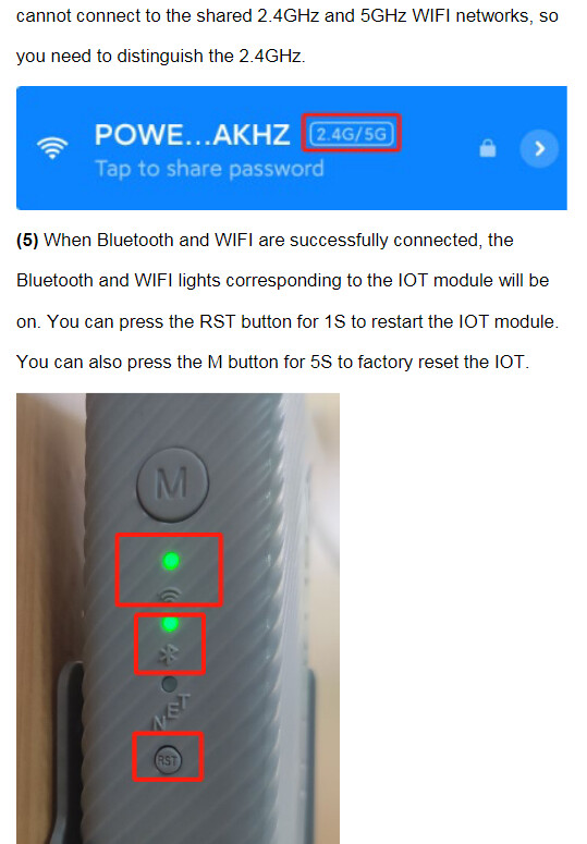

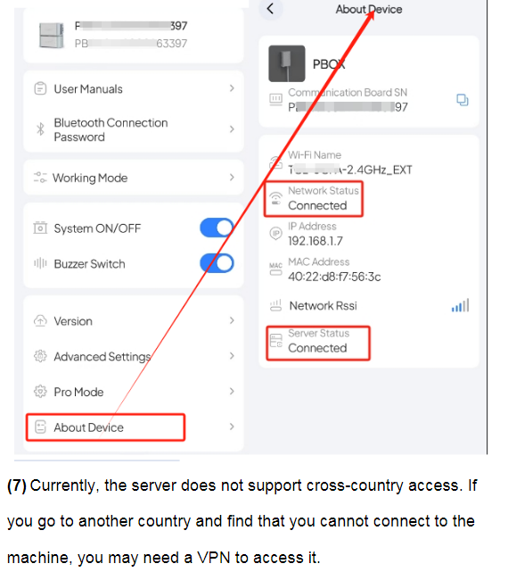

Sorry for the inconvenience. After confirmation, we learned that the app has released a new version. Please upgrade to the latest version and follow the method in the images below to troubleshoot the Wi-Fi connection issue.
