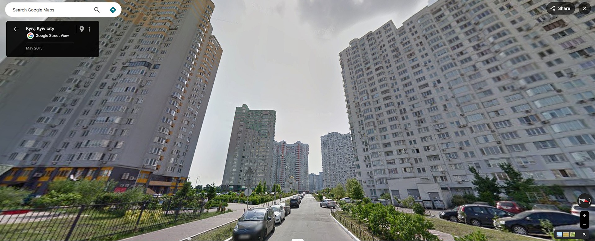

@sealy1986 Here’s a typical apartment block from Kiev. Imagine thousands of people come downstairs and listening to your speech about “just get a gas generator, my dudes.” :joy:
Try to apply your logic to New Yorkers.
Everyone in the suburbs already has gas generators and 10-20 kWh solar systems.
We’re “unlucky” urban dwellers.

I get that, but it still doesn’t change the parameters of the situation. It still makes them glamour items and not reliable. If you want reliability you have to change the parameters, but you cannot because you live in a densely populated urban area. Most home backup units are just massive amounts of battery storage with zero solar potential. You don’t plan around having solar, you plan around having battery for a few days to cover the outage. And even then, you still have hundreds of pounds/kilos worth of batteries that becomes paper weights until you get power back OR have solar (which you don’t) which still means its NOT reliable. Even if you could tap into the roof of your building and have unlimited solar, it does you no good if the rest of your city has no power because there needs to be electricity to pump fuel to the vehicles that deliver your food or supply heat to other buildings for survival. You would ALL collapse if the primary grid went down. Having solar would not protect you. Having extra power so you can watch recorded shows from your phone is a glamour item, but if there’s no way to keep essential services running, its CHAOS. To be fair, even those in suburbs are also co-dependent on the exact same set of circumstances because guess what? They also need to eat and consume resources from those same services. The only difference is they have the luxury of keeping their personal stuff running. Energy grid trumps personal needs. Solar energy marketed to consumers is NOTHING but a cash grab. That’s all. It doesn’t gain you energy independence or reliability, it just keeps you afloat for a few days or a week until the primary grid is restored. I live out of my truck camper and have been able to sustain my personal energy demands 100% from just solar and propane alone, but it still doesn’t change the fact I’m completely dependent on the energy grid when I walk inside the grocery store to get a loaf of bread and milk.
I was just stating a basic fact and not implying that it meant you should also do the same solution for a populated area. What I meant was simply having a gas generator or an open space with lots of solar potential gains you more energy independence. It still doesn’t change that gas generators are more simplistic by design, having higher temperature tolerances and are often more reliable. That doesn’t change. It also means that if you live in a densely populated area, you are NOT going to have reliable power. Your best case scenario is energy potential. A crap ton of batteries to sustain you through several days/nights and pray the power comes back on.
@sealy1986 Вы мыслите правильно. Улицы наших крупных городов сейчас покрыты генераторами. Возле каждого магазина или аптеки стоит генератор. Весь бизнес использует генераторы. Город шумит от уличных генераторов. В многоэтажных домах иногда используют генераторы на балконах, но это заканчивается очень плохо.
That makes sense. It’s all about aligning the correct application to the right job. If I told you Michael Jordan was really good at basketball, but I stunk at basketball, it still doesn’t change the fact that MJ is great. Both statements can be true. You can’t use gas generators in a high rise apartment, but it also doesn’t change the fact that gas generators are more reliable. With that said, Ukraine has taken an entirely decentralized approach to its energy demands which is a large part why they have not collapsed along with resilience among other things. It is much harder to attack 15 solar power plants rather than one thermal power plant. It would make sense that villages and cities near frontline areas experience blackouts more often because Russia is concentrating most of its efforts to disrupt those areas first.
