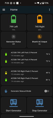

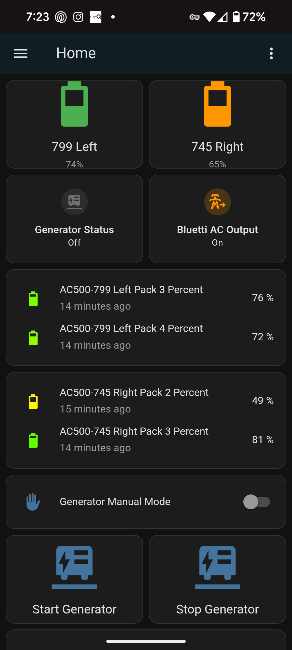

I’m chiming in to voice my support for this project as well. I have a Home Assistant server and two AC500’s in split phase mode with five B300S.
Currently I’m using the Bluetti2MQTT integration. It’s great when it works, but after some hours or days the AC500’s stop communicating. It can only be restored by rebooting the AC500’s which isn’t easy. It requires a trip to the basement, disconnection of both solar panel arrays, using flashlights, etc. Not optimal for my elderly father so we usually just go without. As the app still reports battery level I’m guessing local WiFi or cloud-based API access may be more reliable.
The holy grail for us it to have HA monitor battery level and turn on the generator when they get low and turn it off when they get near full. I have everything working successful currently, with the exception of consistent communication between HA and our two AC500’s.
Regardless, I welcome any and all Bluetti involvement to improve Home Assistant integration.

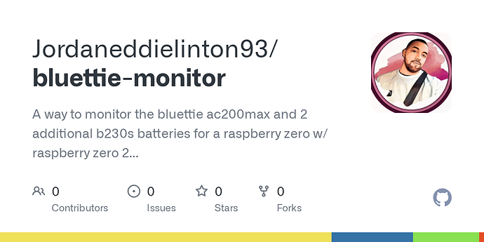

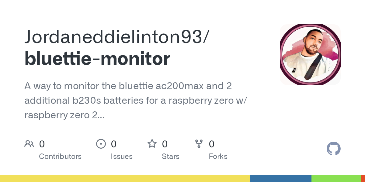

I made a version/fork for my Bluetti AC200max , it just uses the already built bluettie MQTT/home assitant to send it to a web browser as i dont use home assistant and couldent get websockets to work with my Pi so it uses basic https fetchs , i intend to hook it up to other thing but as a template it works for what i need, just thought id drop it here as Cursor AI did 90% of the work.:
