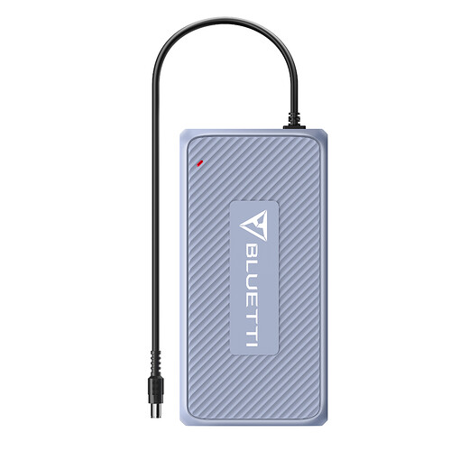

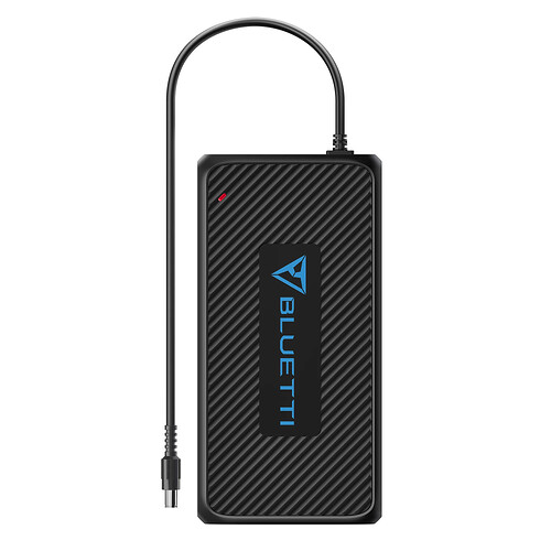

Hi guys, I just got an EB240 and wondering which of the 400/500w chargers works with it.
What’s the difference between
and the product listed at
The 1st charger claims to be compatible with EB150/240. What about the 2nd?
Thank you!

They are both the same charger but the first one has the XT90 adapter which you won’t need with an EB240. I use a T500 on my EB150 and it works great.
