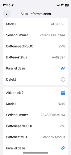

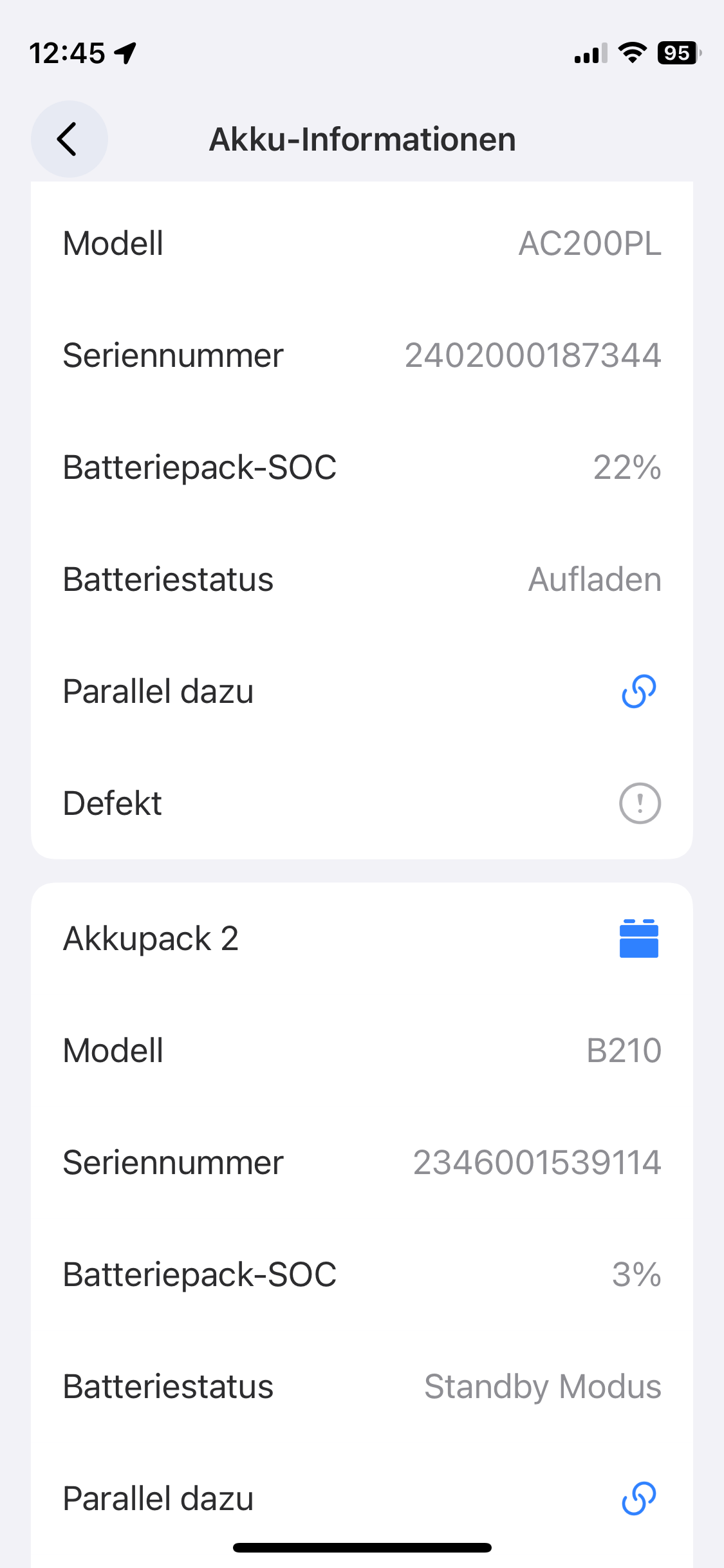

An one remark: I am pretty sure this is not a calibation issue. E.g. I just had the case where the system was only charging the internal battery although it had 22 % while the external B210 was put on standby instead of charging although it was on 3% only.
I think the Energy Management is simply missing a rule, to give charging priority to the battery with the lower SOC and to primarily discharge the one with higher SOC.

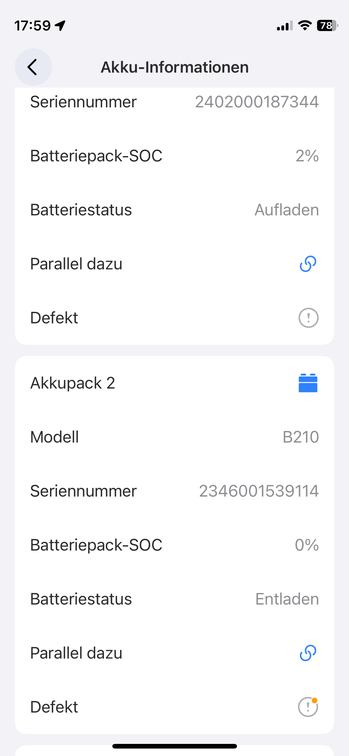

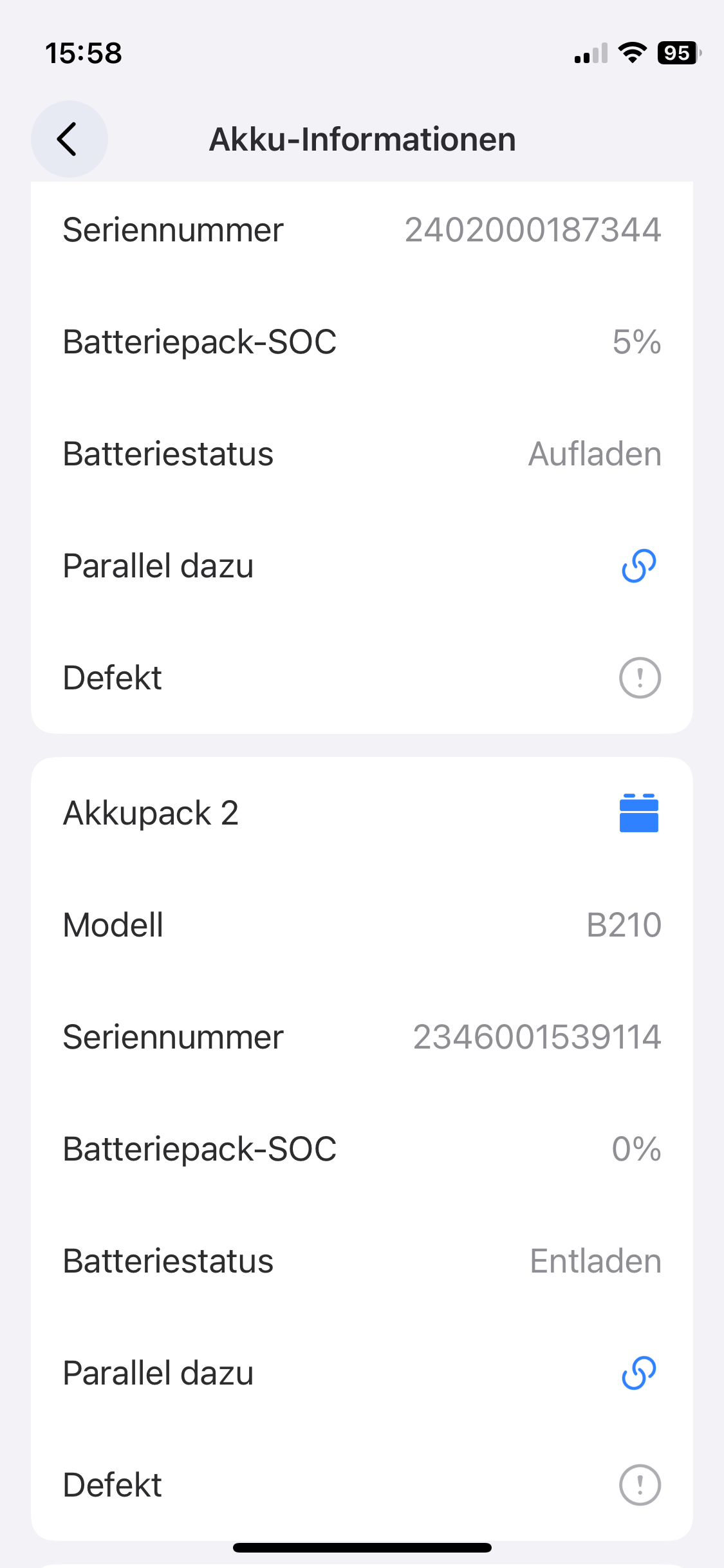

While trying to calibrate, this is happening:
  1. I emptied the whole system with all inputs disconnected.
  2. After the system shut off and rested for an hour, I plugged in mains and switched it on.
    → The AC 200P L came on and started charging
    → The B210 initially also came on but then switchef back off, without charging.
  3. After Switching B210 on again,

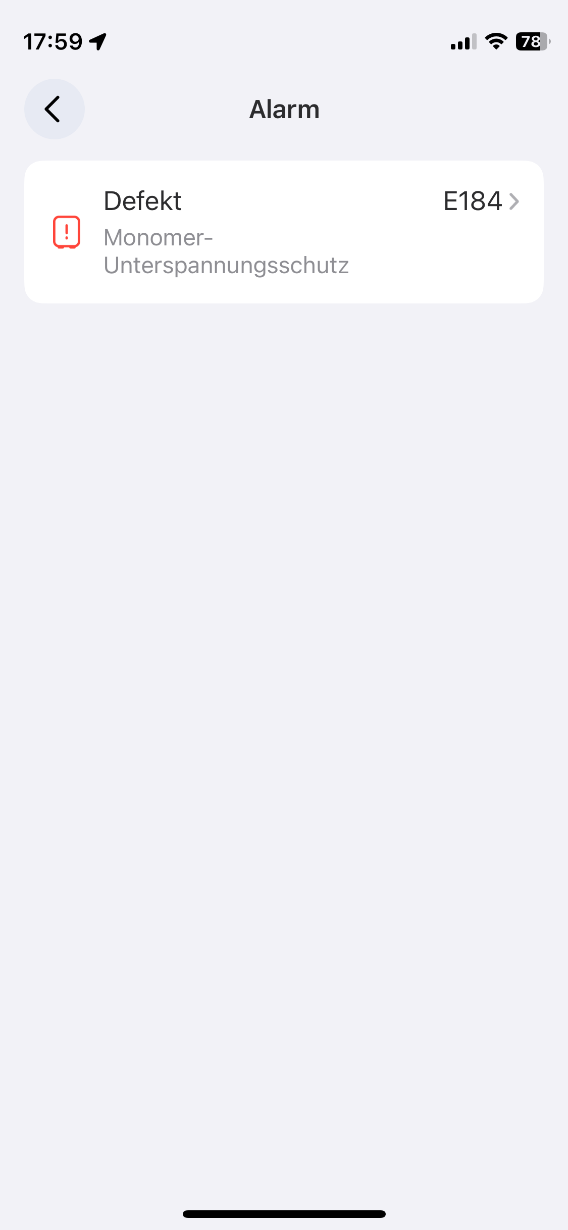

    → B210 came on but showed up the app as still not charging and with a “Defect E184 Monomer-Unterspannungsschutz” (German for ‘low voltage protection’). It even showed to be discarging for a short while in the app, although already empty and no outputs activated, while the internal battery is charging. See Screenshot.
    → After a couple of minutes, It switched off again, without having charged.
Is it broken? Maybe the deep discharge because of improper balancing has harmed it already.
It is only 16 months old. Should I return it for warranty?
Hi @Heiko, From the error code, it appears that the B210 has been over-discharged and is in urgent need of charging.
We would like to confirm whether the B210 has been disconnected from the AC200PL during this process.
Please charge the B210 separately. You can try charging it with an adapter and a solar panel, respectively. When using solar charging, please select a solar panel with an open-circuit voltage between 11 to 60V.
After the B210 is fully charged and its power level is consistent with that of the AC200PL, you can parallel them again. We look forward to your reply.

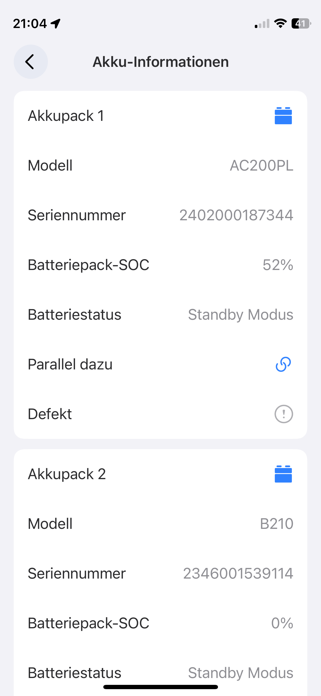

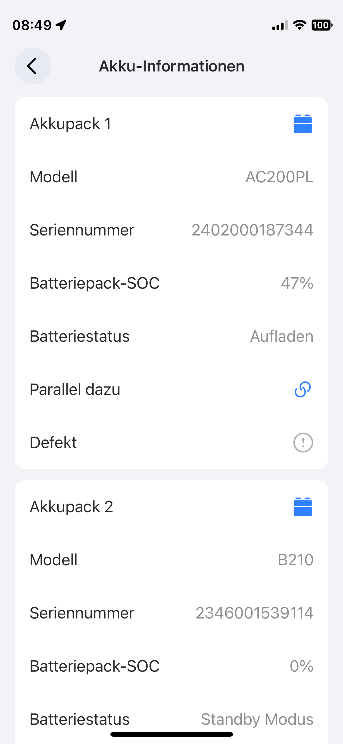

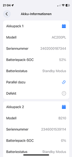

For the record, here is another extreme example from this morning, 36 hours or one charge cycle after calibration:
I had custom USP set to minimum SOC of 20%, and the main unit was at 47% while the B210 had been emptied to 0% SOC.
And the available Solar input of around 300 watts was exclusively charging the main unit instead of the B210, which was sitting in standby instead of charging, although it was connected and online :

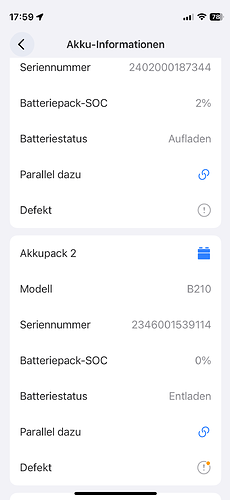

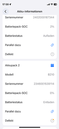

So, now I am recharging for calibration (both PV and AC combined) and while the internal battery is charging, b210 was first remaining in standby, then after some minutes, it was displaying discharge (German „entladen“) although it was displaying 0% and no outputs are activated:
