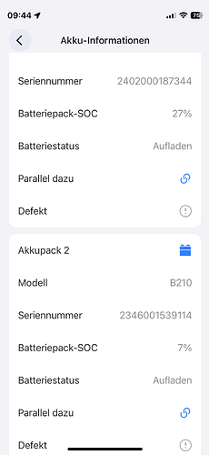

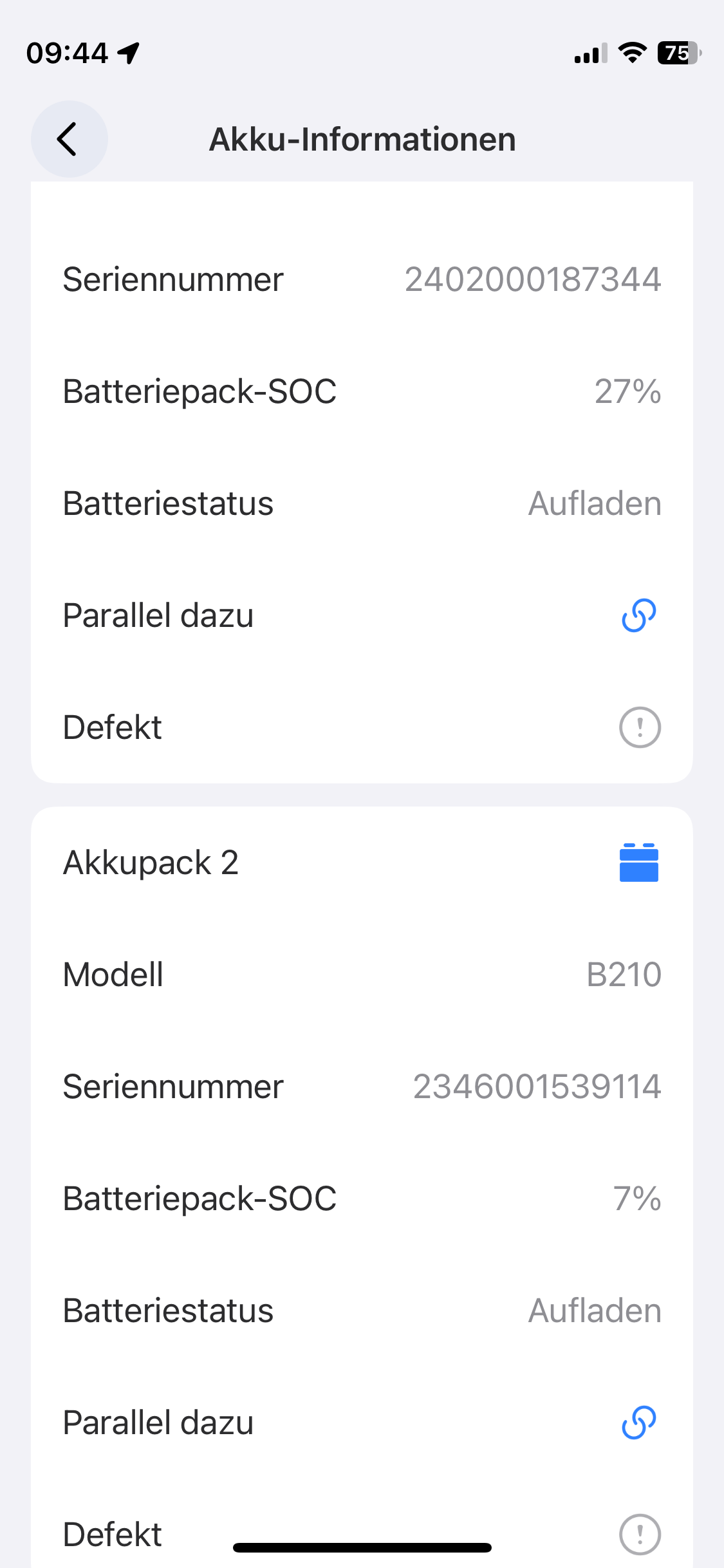

The Problem still persists. Yesterday, one was 27% and one 7% although minimum SOC was set tob15%. And it was PV charging both, instead of the lower one only. (300 Watts, no near maximum charge rate).

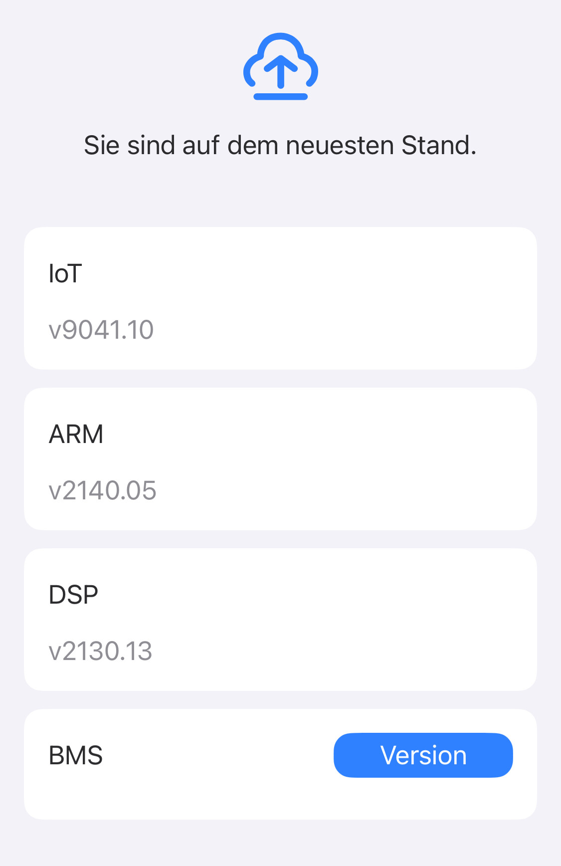

Hi @Heiko, It seems that the firmware information you provided is about BMS, right?

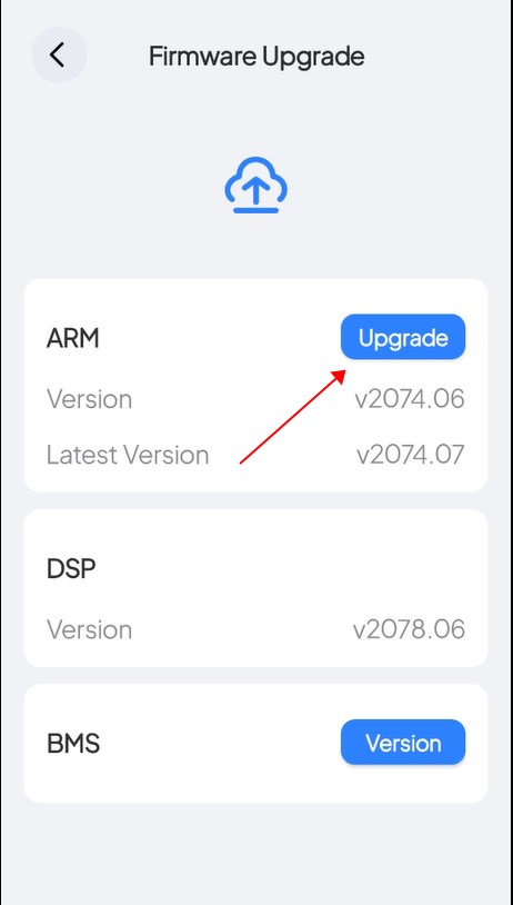

Could you also inform us of the DSP firmware version? Please provide a screenshot of the firmware - upgrade page.
We have attached a photo for reference.
Hi @Heiko, Yes, we have found that your DSP is indeed already the latest version. Under normal circumstances, the Relay-Click-Clack issue should have been fixed.
