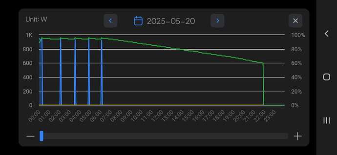

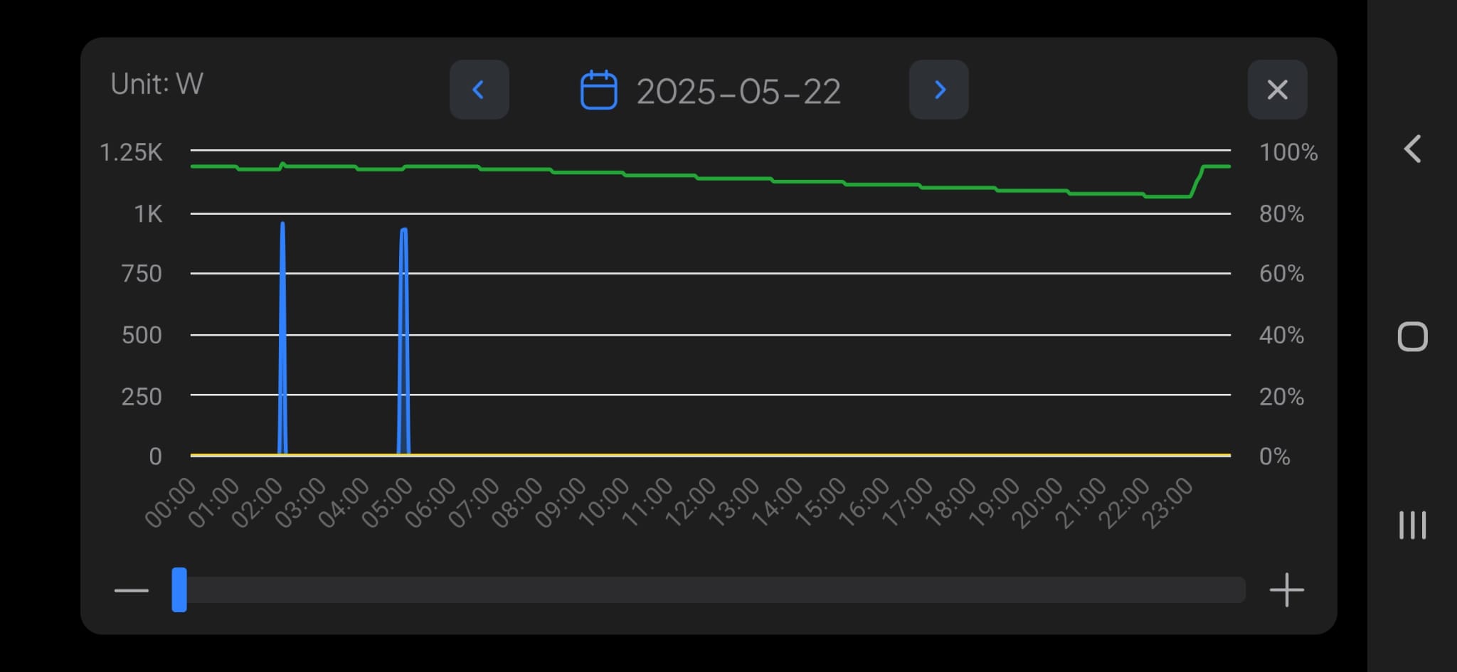

What % daily discharge should one expect with the absolute minimal load (only native Bluetooth and Wifi)?
The ac300 is slightly less efficient just multiply the numbers by 24 for daily usage.
Thanks Kit,
Very useful.
So, even without load (AC&DC off), would it be normal to see a discharge of approximately 15% per 24 hours on an AC300+B300K combo? i.e. less than 1 week (without load) before needing recharging? ~2.4kW per week to get remote access???
Tad less efficient than my expectations.
