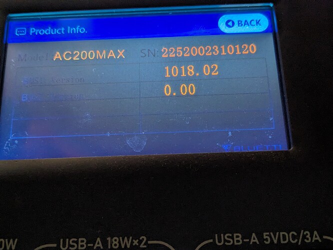

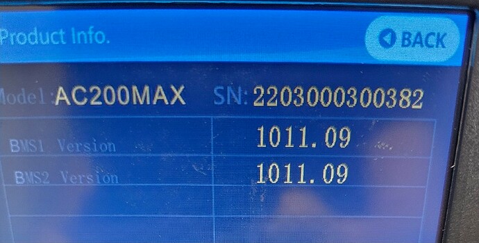

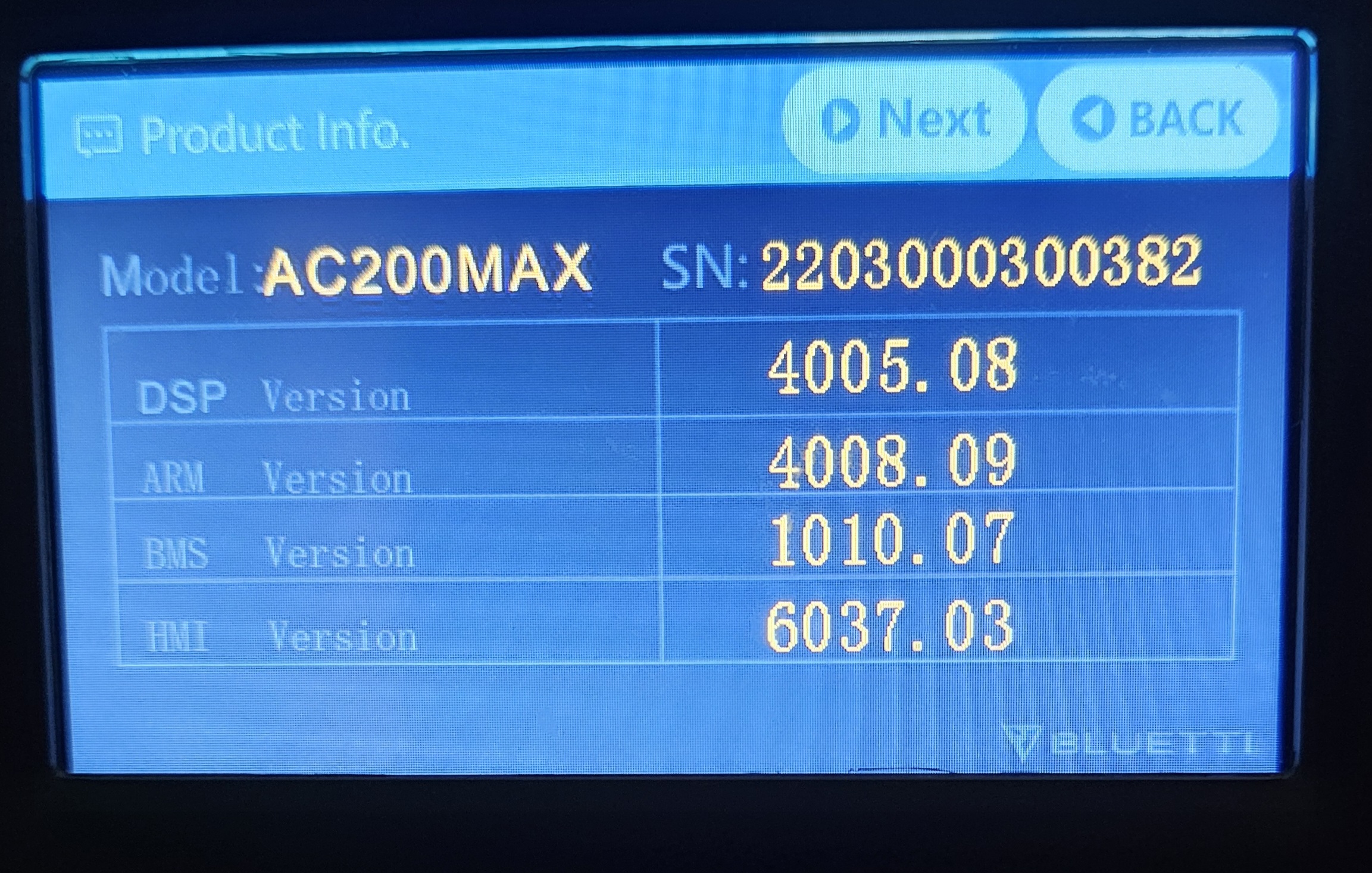

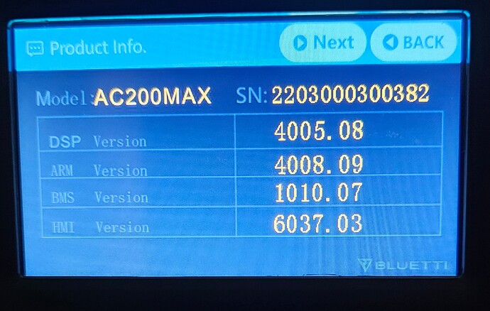

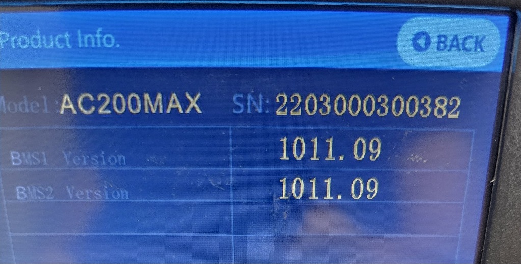

Please find S/N and software versions below.
I updated the firmware to the latest version using the Android Bluetti app a few weeks ago, hoping that would solve the unstable SOC after shutdown/on, and after the update I charged/completely discharged/recharged to 100%. Firmware update cured SOC of AC200Max but had no effect on the B230’s Alzheimer SOC.
Yesterday I charged my AC200Max+B230s to 100%, then verified once again they are at 100% after turning them off. Today I turned them on to get a snapshot of S/N and software revision, and got a surprise - the B230 says 81% SOC. Turned them off and back on to see that the B230 now says 64% SOC. It will then take a 30Wh charge (2 minutes) and report 100%.
