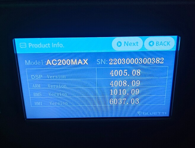

See attached my firmware.

I have two AC200Max and one B230, and you released the special firmware for one of my AC200Max to fix the SOC issue on my B230. This firmware works very well.
For various reasons, I now need to connect my B230 to my other AC200Max, which doesn’t have the special firmware to fix the SOC issues on my B230. Can you release this firmware for my second AC200Max? Data Below. Thank you very much.

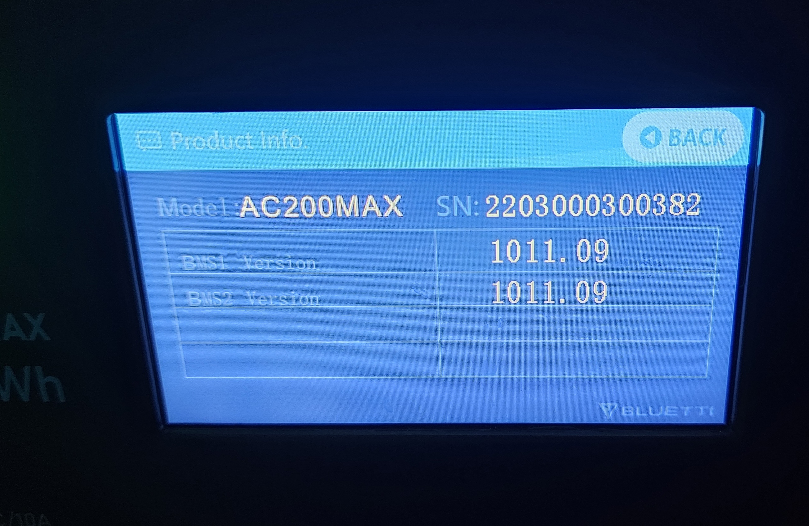

When connected to my AC00MAX the BMS version shows as 1011.09

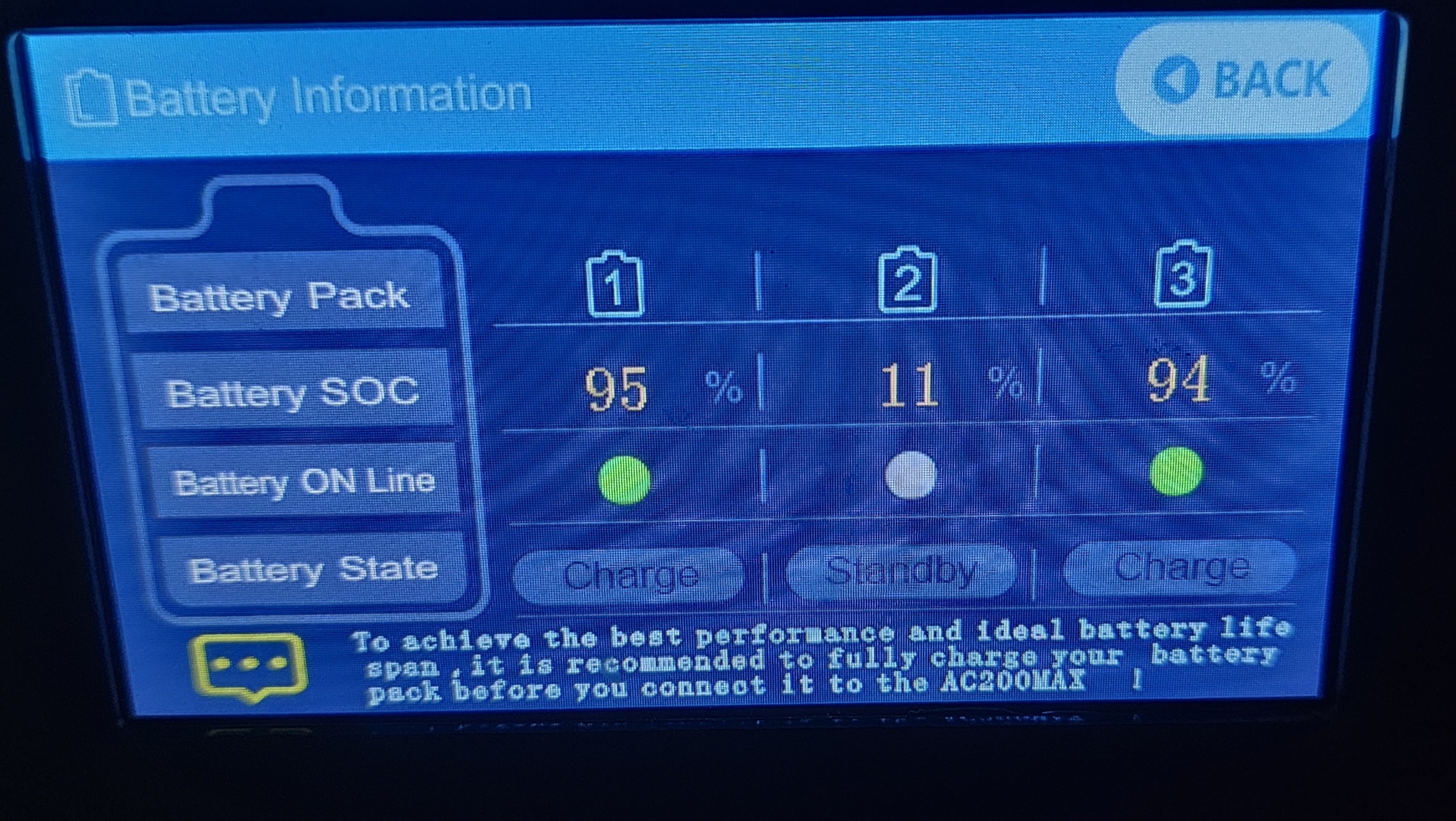

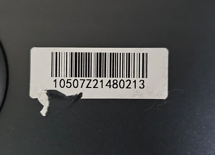

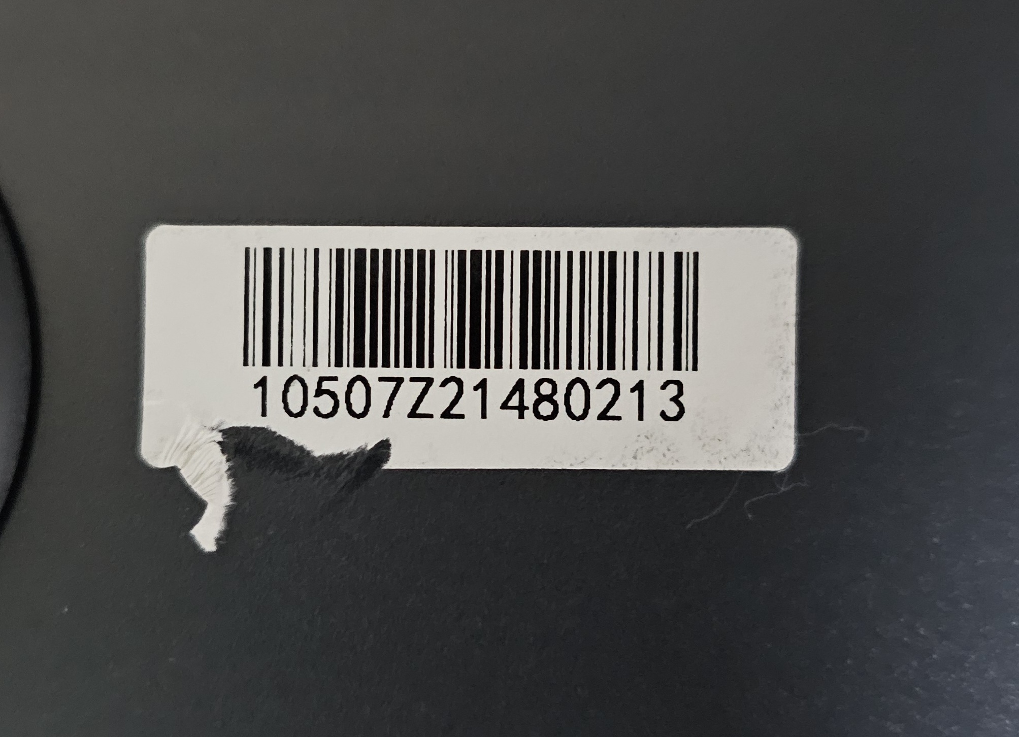

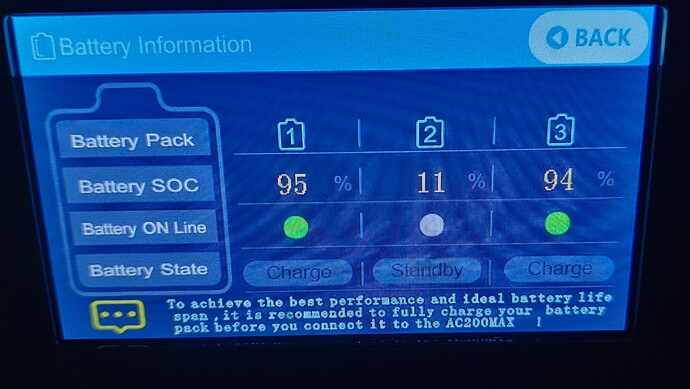

I have an issue with one of my B230 batteries that are attached to my AC200MAX.
1 B230 is working fine the other 1 (serial number 10507Z21480213) is showing charging problems.
I have already performed the battery state of charge calibration 12 times now.
B230 is empty, showing as 0% charge via AC200MAX display and battery indicator on B230
B230 is then disconnected from AC200MAX (Isolated) and charged via Bluetti T400 mains adapter with no loads connected.
T400 shows charging (red LED) and B230 shows charging as well. B230 battery indicator showing a charging cycle.
After less than 5 minutes, the charging stops, and B230 shows 100% charge. The T400 mains adaptor stops charging, green LED.
I if then Reconnect the B230 to the AC200MAX, the charge state only shows 11%.
I have already had a ticket for this issue, and the latest firmware updates where sent to my AC200MAX.
This has made no difference to my faulty B230.
I have 2 B230’s, and the other one charges fine and discharges as expected.
So this can only be the B230 (Serial Number = 10507Z21480213) is faulty and will not accept a full charge.
Please advise on a fix.

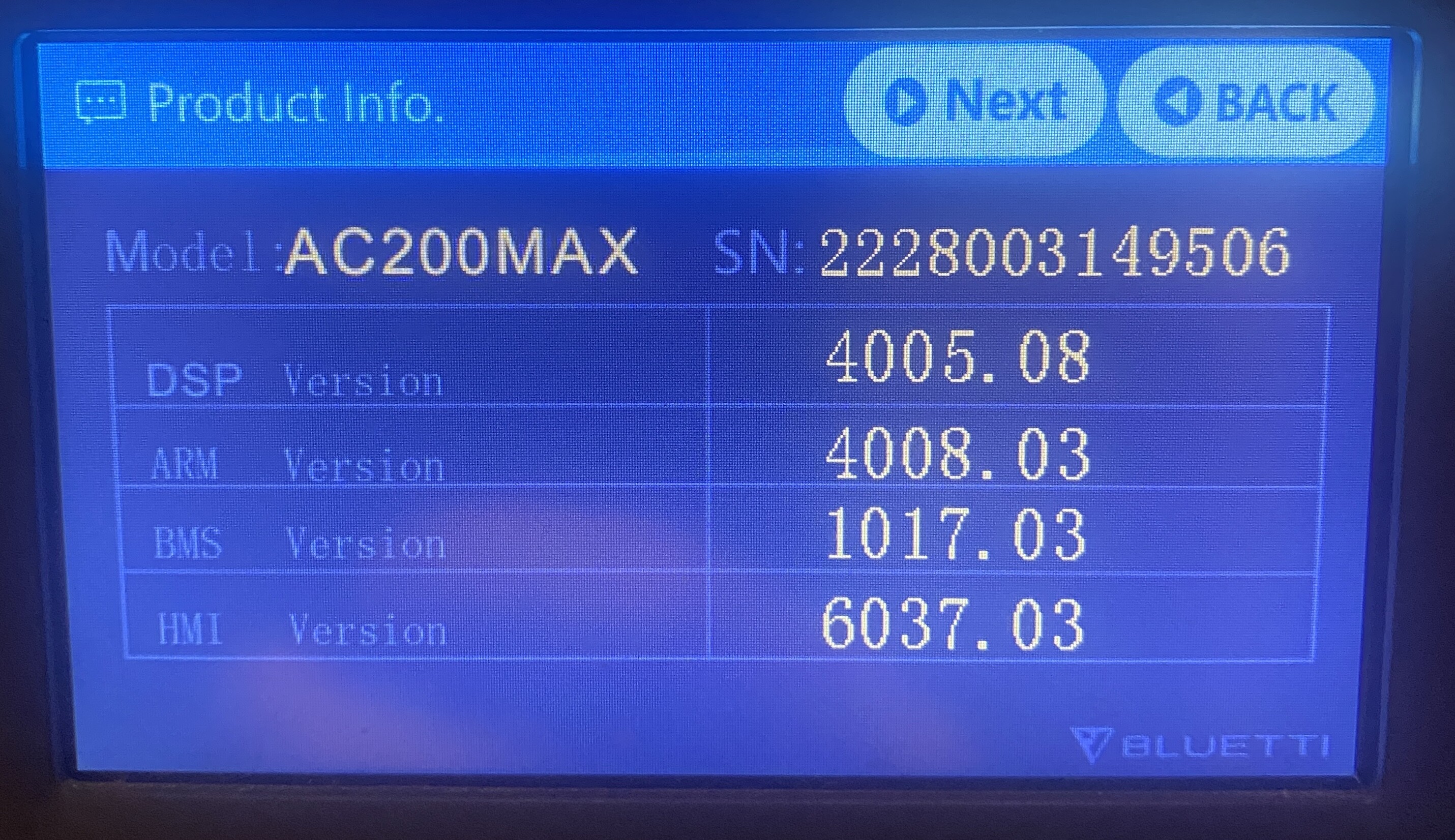

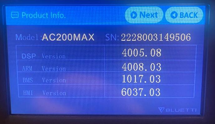

@BLUETTI, @BLUETTI_CARE, I also have the same SoC problem with two B230 batteries connected to my AC200Max.
My current firmware:
DSP: 4005.09
ARM: 4008.03
BMS: 1017.03
HMI: 6037.03
BMS1: 1018.02 (b230)
BMS2: 1018.02 (b230)
Please, push the updated firmware to my device (AC200M2228003149506).
Hello, I have registered you for the firmware upgrade.

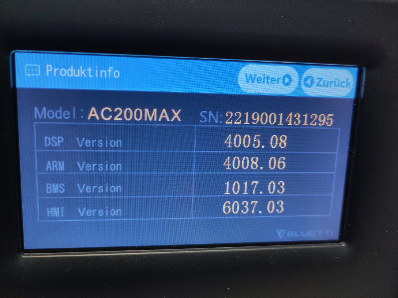

Dear @BLUETTI @BLUETTI_CARE ,
I also have the same SoC problem with one B230 Battery attached to my AC200Max.
Please find my current Firmware and SN Information on the photo below.
Please register my Serial Number for the firmware update as well.
Many thanks,
Michael
Hi @Michael22, thank you for getting in touch with us.
We have applied to upgrade your BMS. Our IT department will push the latest version of firmware to your machine within 24 hours. Please upgrade it tomorrow.
Please disconnect the B230 from the AC200MAX, and do not load any device when upgrading it.
After that, please recalibrate the system.
