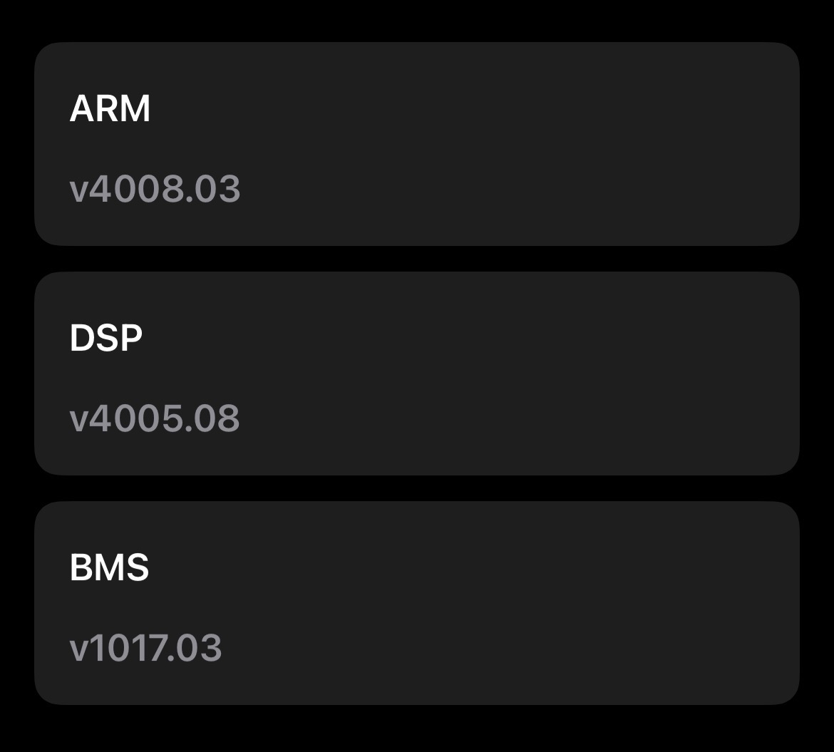

SN and other info in the pictures attached.

Hi @Basti_D, It seems that this is indeed the case. Solar charging can wake up the AC200MAX but cannot activate the B230 battery pack.
We have requested an upgrade for the BMS firmware, which will help maintain and synchronize the SOC (State of Charge) between the AC200MAX and B230. Normally it will take about 24 hours, please upgrade it tomorrow.
Note that if your AC200MAX is connected to a B230 or B300 battery pack, please disconnect the batteries and update the AC200MAX separately.
After the upgrade, you can reconnect the B230 with the AC200MAX and recalibrate them together.

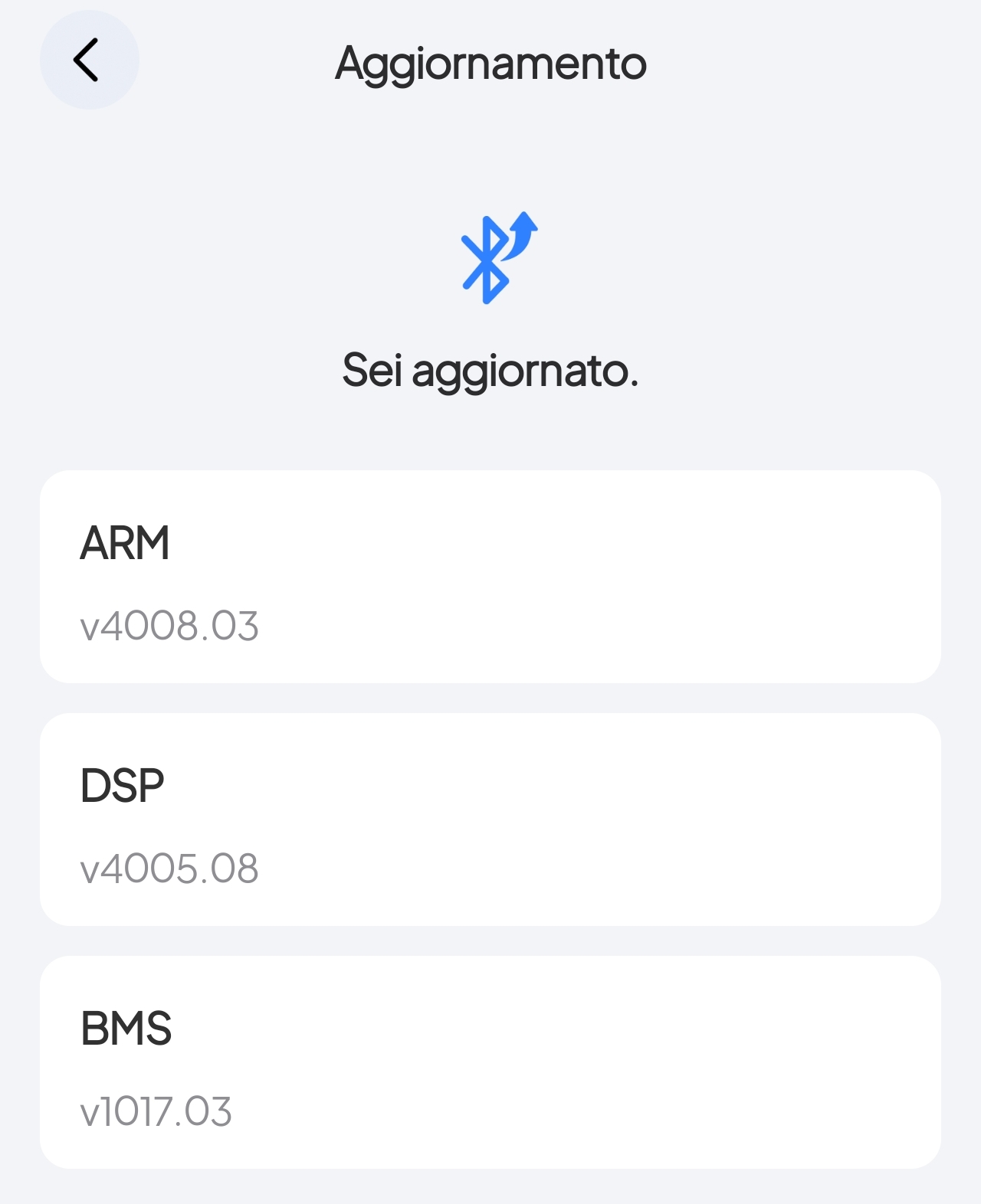

Hello,
I’ve got the same issue with AC200Max and B230.
@BLUETTI_CARE can you please pull the firmware upgrade? My serial number is 2230000809423.
Thank you!
Hi @bluetti_tizianodangelogmailcom, thank you for getting in touch with us.
We have applied to upgrade your BMS. Our IT department will push the latest version of firmware to your machine within 24 hours. Please upgrade it tomorrow.
Please disconnect the B230 from the AC200MAX, and do not load any device when upgrading it.
After that, please recalibrate the system.
