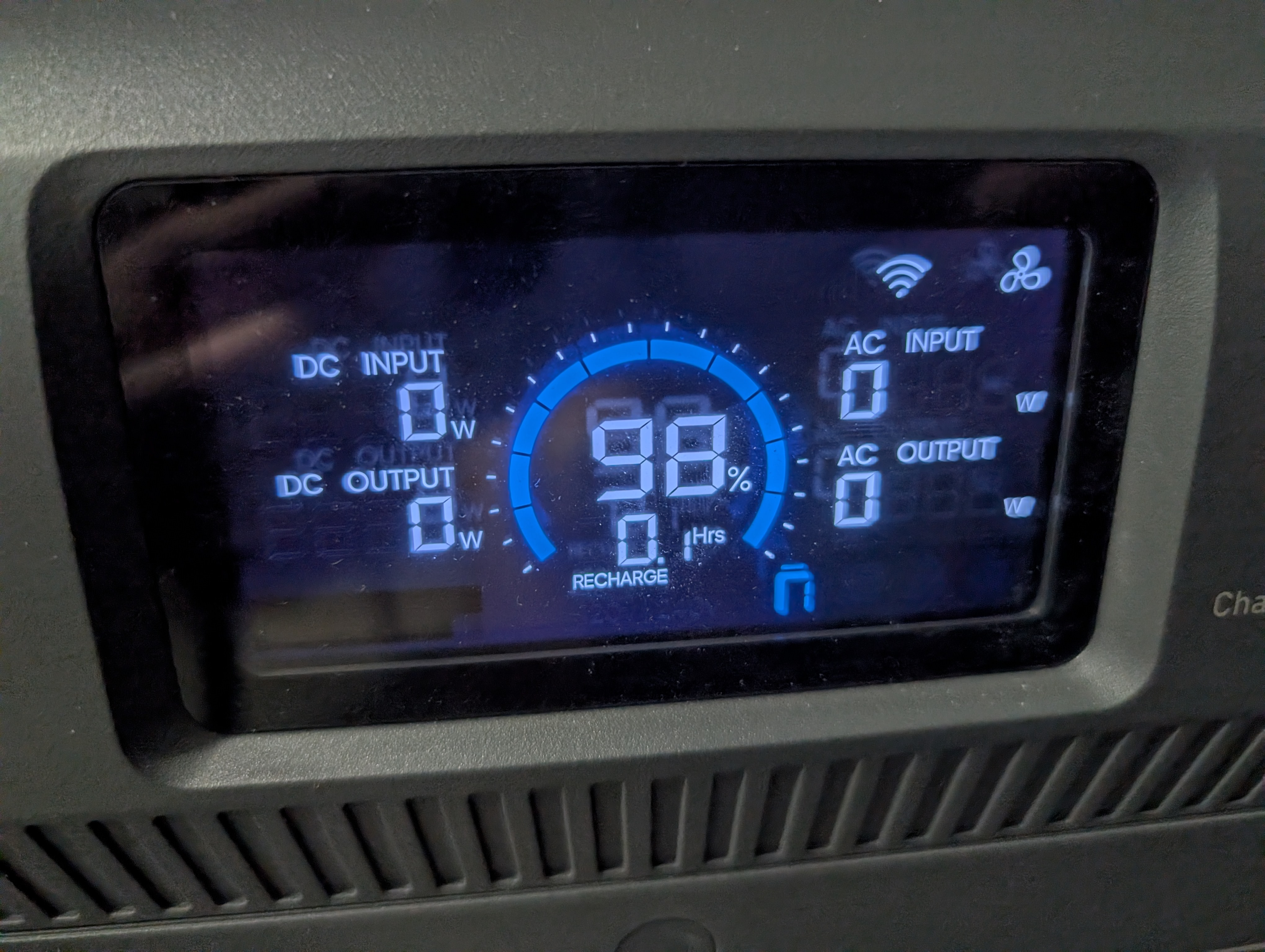

I’ve just connected b230 to apex300
My apex was 69%
My b230 was about 77%
After connecting, there was a blue battery icon on the apex screen and the SoC was jumping between 69 and 74
I assume it would work without jumping once i charge both to 100%
Knowing this, and if this technically works, ie battery packs do share load and charge each other, why on earth wouldn’t Bluetti have official support for these?
Is there a way I can ask for a custom-ish apex fw update to properly interconnect both?
From what I understand, we just need FW update to properly read SoC
When i charge b230 via t500 or d050s, the apex300 screen shows estimated charge time, so it sees the battery and its transferring charge through.
When i charge apex300, the b230 is blinking that it’s charging.
Dear bluetti, all I (and other b230 owners) need is a fw update to properly read the SoC, so it no longer jumps!
It even displays that an expansion battery is connected

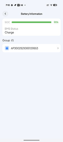

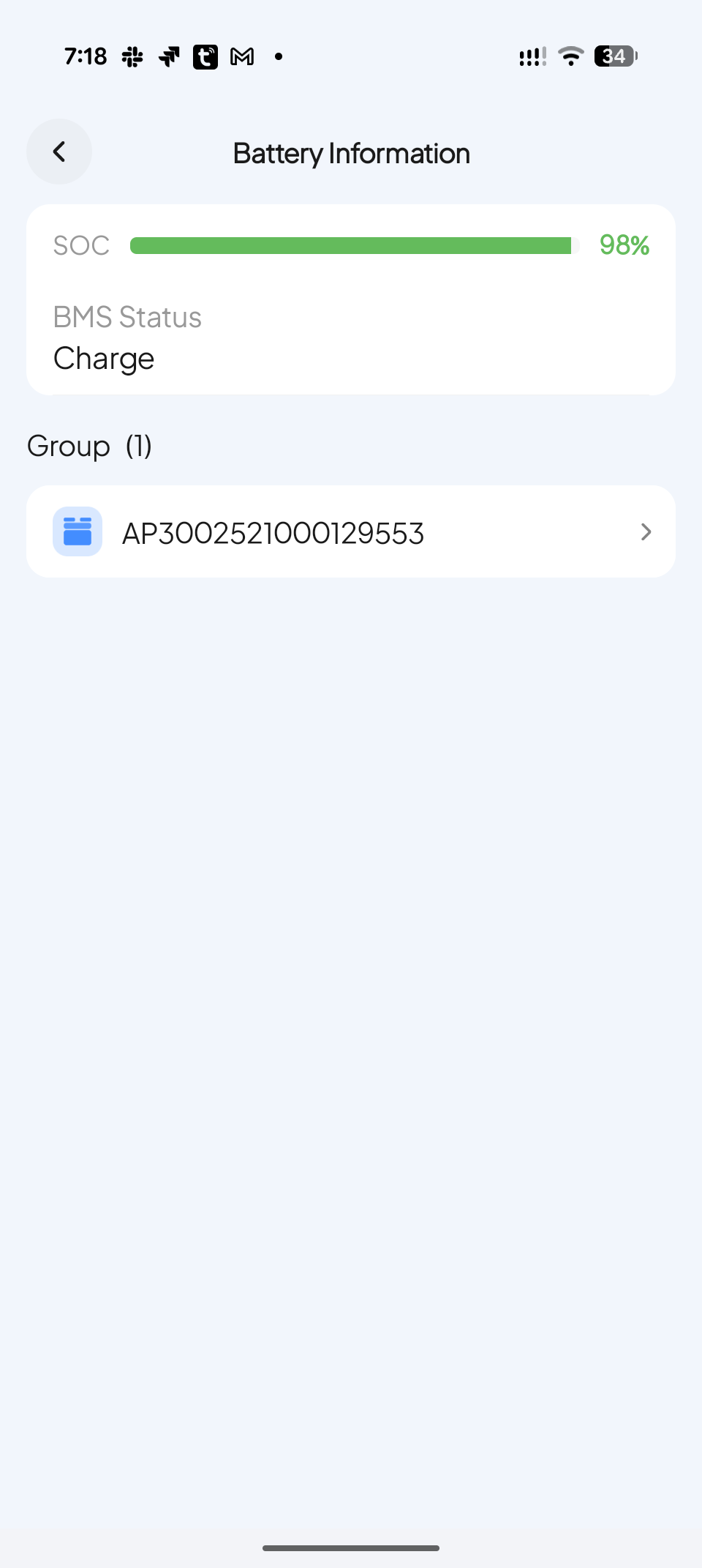

Here is what I see in the app for Apex300 while my b230 is charging through d050s
What’s strange is that after pulling 10% of the capacity from a 1250 watt load, it took me 13 minutes.
If I do the math, it totals to 130 minutes to fully discharge, which gets me exactly 2700 wh capacity.
At the same time, the SoC is jumping to 94%. Which is 6% in 13 minutes under 1250watt load. It is 4500 capacity, indicating that it somewhat senses the b230, but doesnt know what to do with it.

Another quick test I’ve made
When Apex was at 75% (around 2000Wh left), I connected 96% b230.
Apex screen started flashing 75% / 86% / 75%
After 3 minutes of 1200w load, the flashing stopped. Apex dropped to 65% after 14 minutes, indicating it still reads its internal SoC.
B230 showed 93% after reconnecting it to ac200max.
Which tells me it can draw from b230.
The biggest problem that comes from this incompatibility is weird SoC reading. I assume Apex firmware is missing a config to read the Wh capacity of B230 hence fails to properly understand its total capacity cause it reads the state of internal BMS without combining the readings of both.
It really comes down to adding a few configs, I am sure of that.
