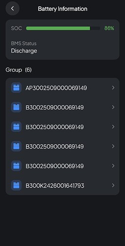

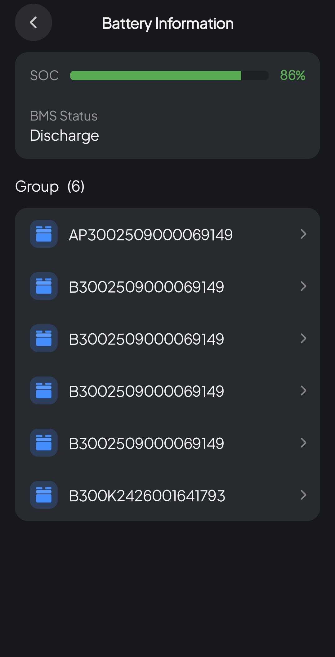

That presents somewhat of a problem. Mostly because the battery serial numbers are not listed in the app under the Apex 300 – the app duplicates the Apex 300’s serial number as the B300 battery serial numbers.
In my system I have two B300s that use the v1014.18 BMS (the one I need updated), another one uses v1021.15, and a fourth one that uses v1024.07 (all currently installed BMS versions).
If you truly need the serial numbers I can do that, but I will need to shut the system down and disconnect and unstack each of the batteries as the serial numbers are on the bottom in my experience.
