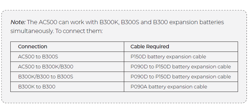

I’m not sure your reseller is correct, the B300K manual seems to say the opposite. See screenshot below. Thanks to Bluetti_Care for confirming/denying. Note the line “B300K/B300 to B300S” below
You have a clear answer from Bluetti admin below: your seller is wrong and you are right to check !
Bluetti admin :
" Yes, no problem. A single AC500 can connect up to 6 battery packs max.
You can choose to connect 3B300K on one side and 1 B300K+2*B300S on the other side
AC500 to connect B300K need to use the optional cable: P090D to P150D."

Then I need two cables P090D to P150D, or?
AC500 — P090_to_P150D — B300K ---- P090_to_P150D — B300S
Hi @digait, Yes, that’s correct. The AC500 and B300S come with the P150D connector, while the B300K uses the P090D connector.
