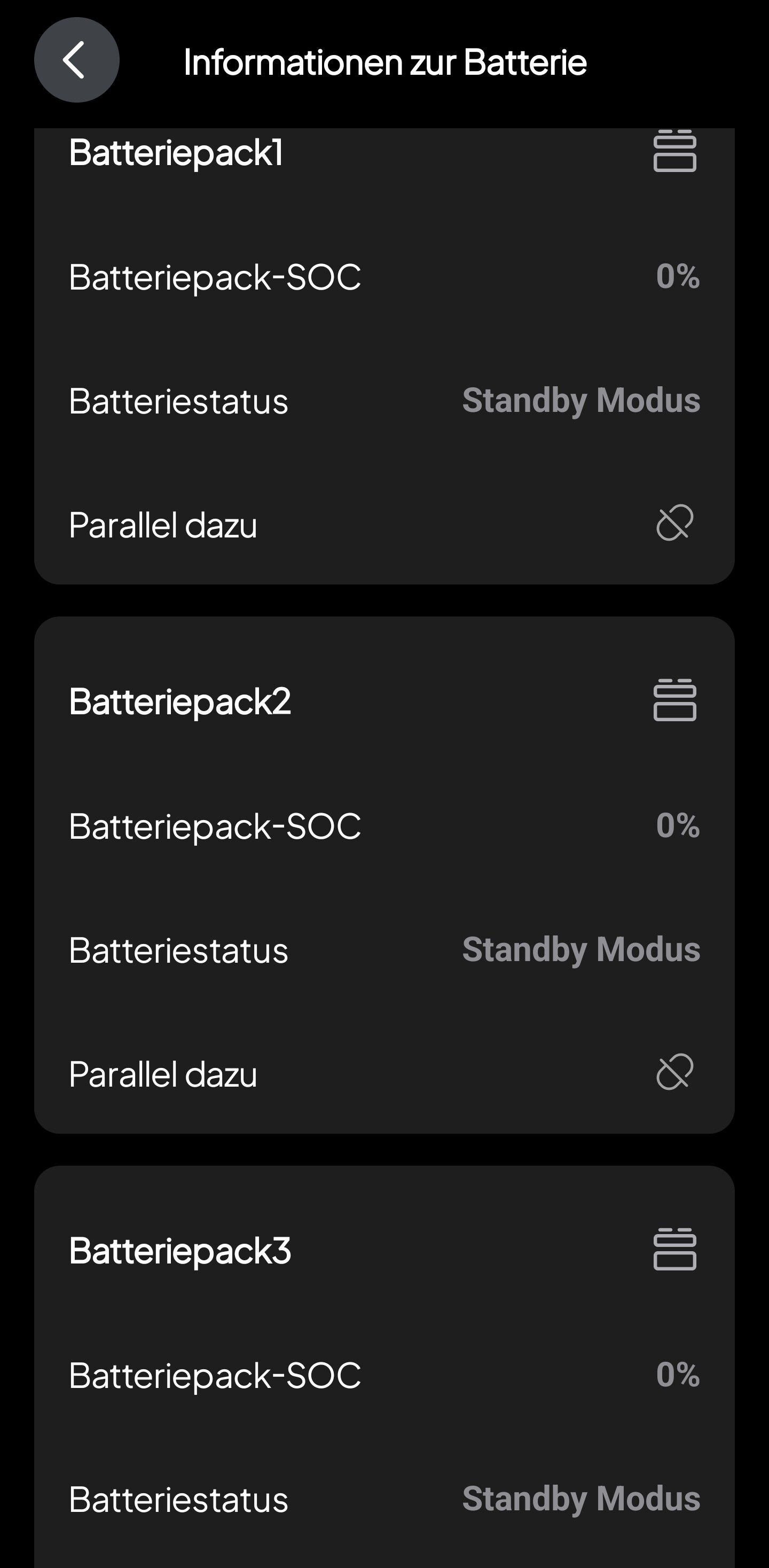

AC500 + 6x B300S: Some batteries switched off on their own
It happened now two times that batteries switched off - on their own!
The first time was when I updated the BMS of all batteries to v1022,14,
drained them to 0% and following, charged them to 100%.
Then, my adjustment over night was: charging from grid OFF, AC OFF.
Next morning I noticed that one of the batteries was switched off.
The second time at the beginning of the night the overall SOC was ca. 45%.
During the night the adjustment was the same: grid OFF, AC OFF.
The following morning I found five of six batteries switched off!
What is going on?
A bug in the new BMS version?

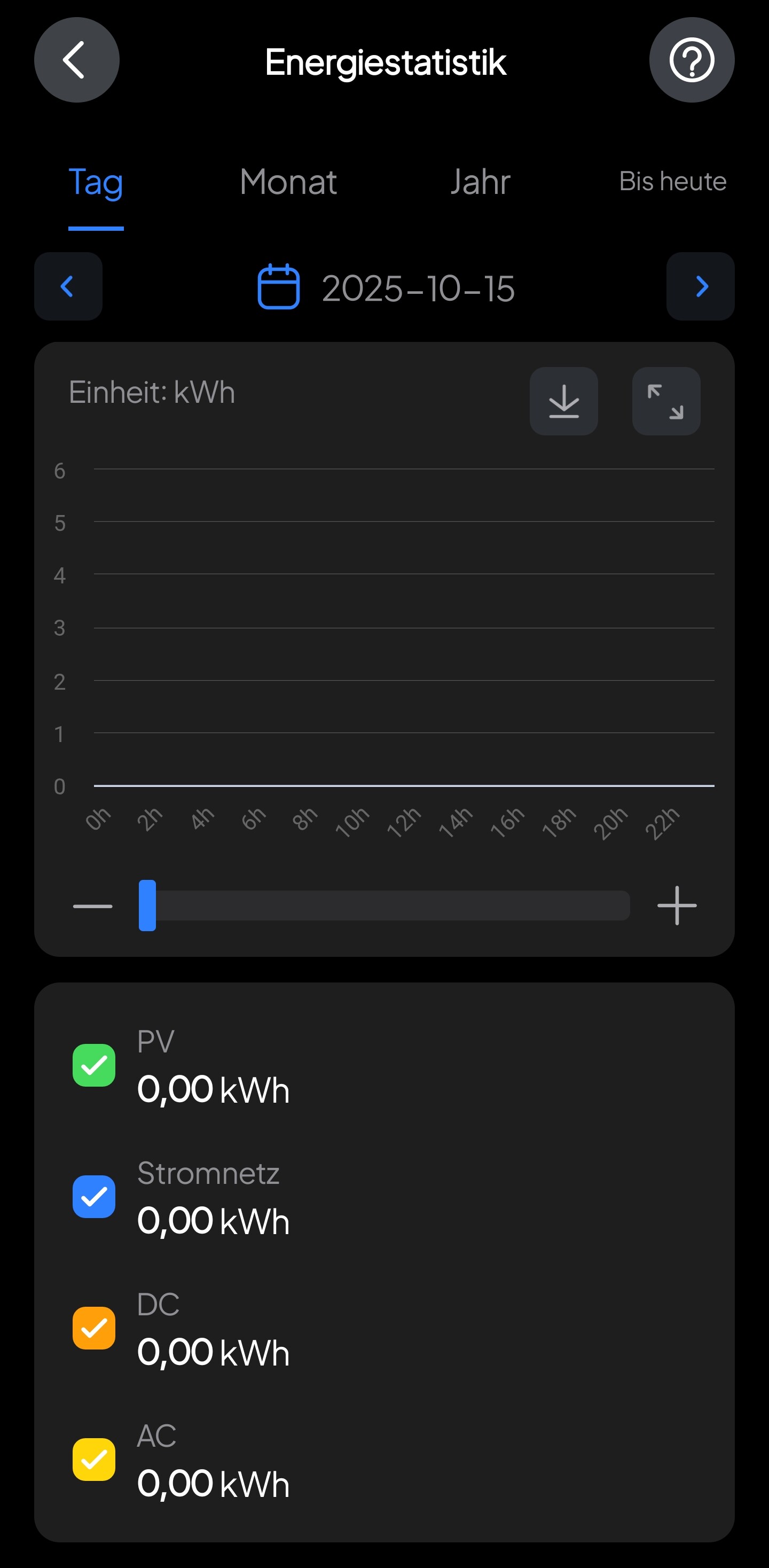

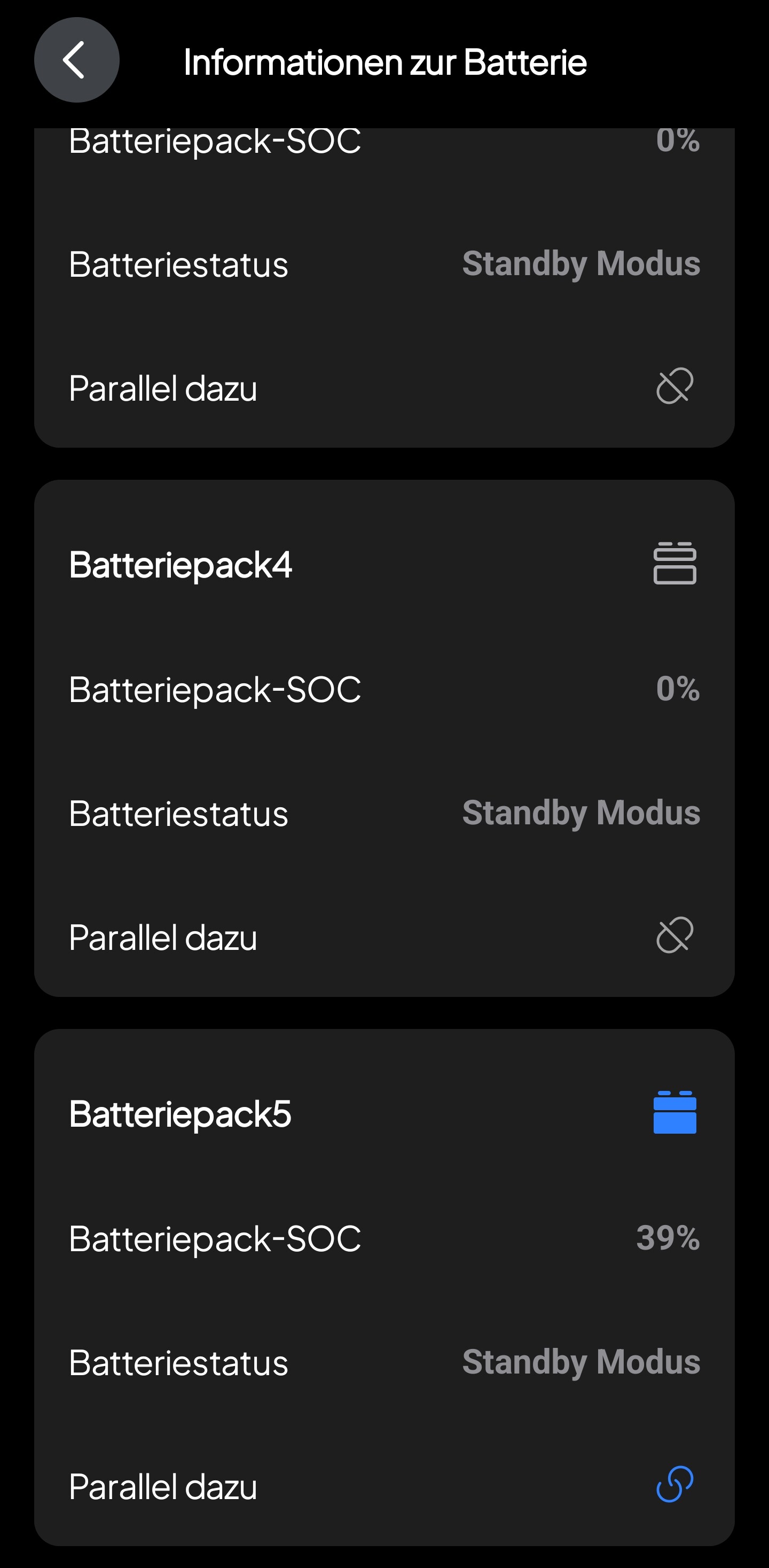

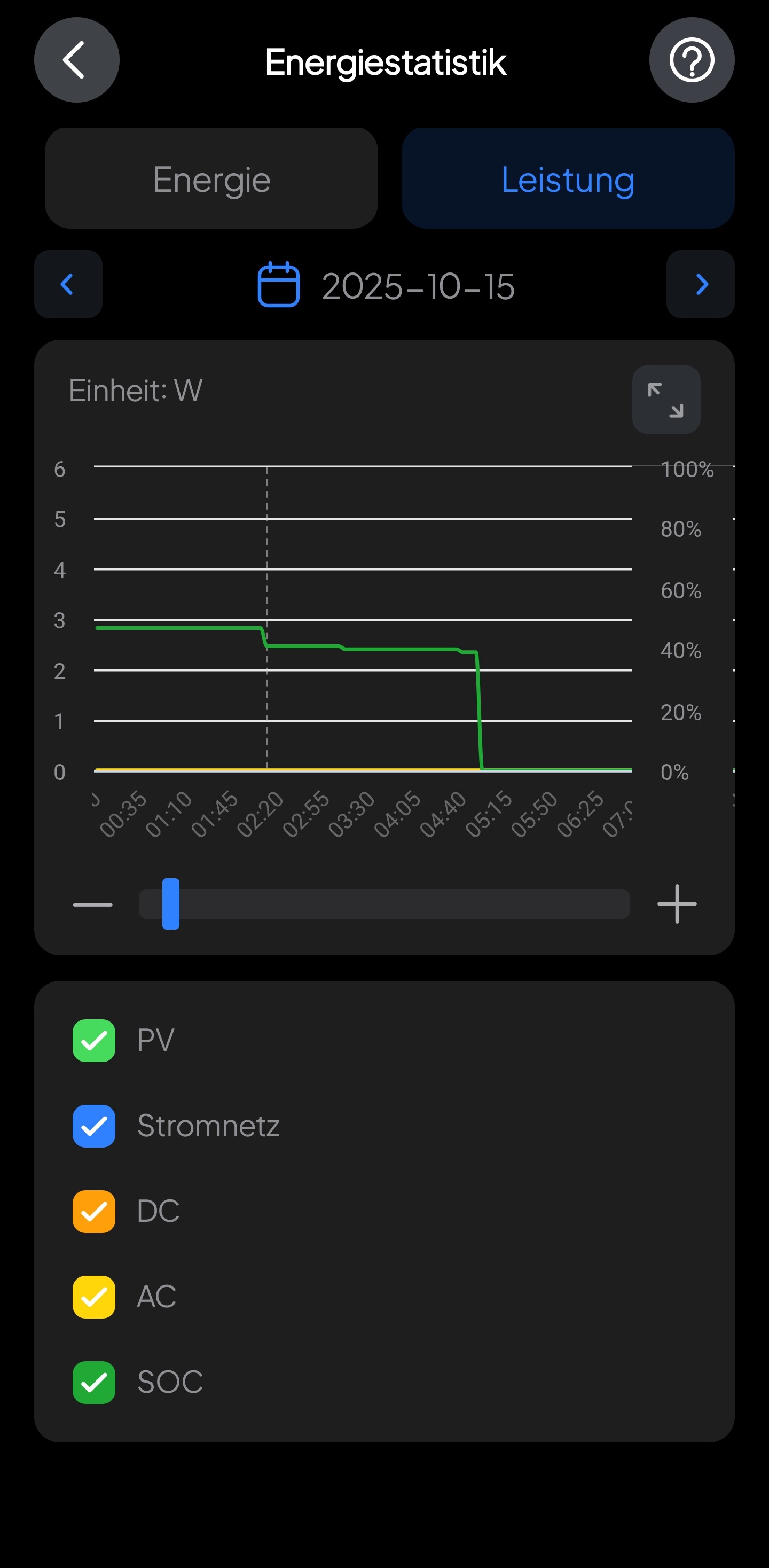

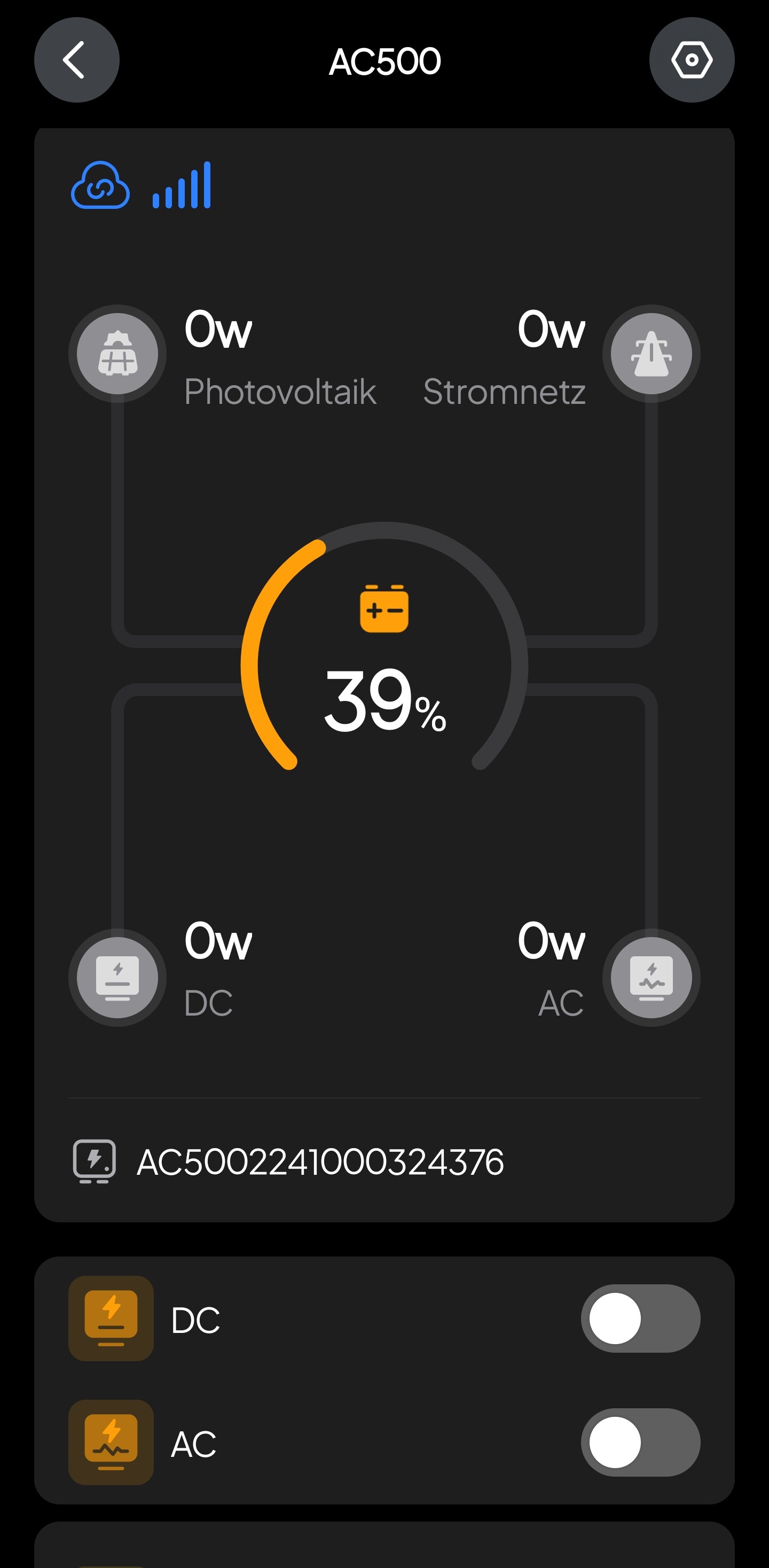

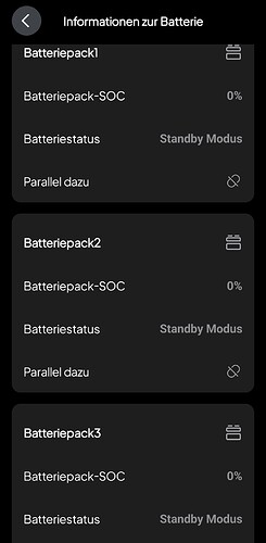

Hello @BLUETTI_CARE and other interested parties,
I’m having the same problem now.
I have an AC500 with 1xB300S and 4xB300.
Last night, the four B300s simply shut down.
All power inputs and outputs were off.
Even ECO mode was off!

Why do the B300 batteries suddenly shut down and the B300S doesn’t?

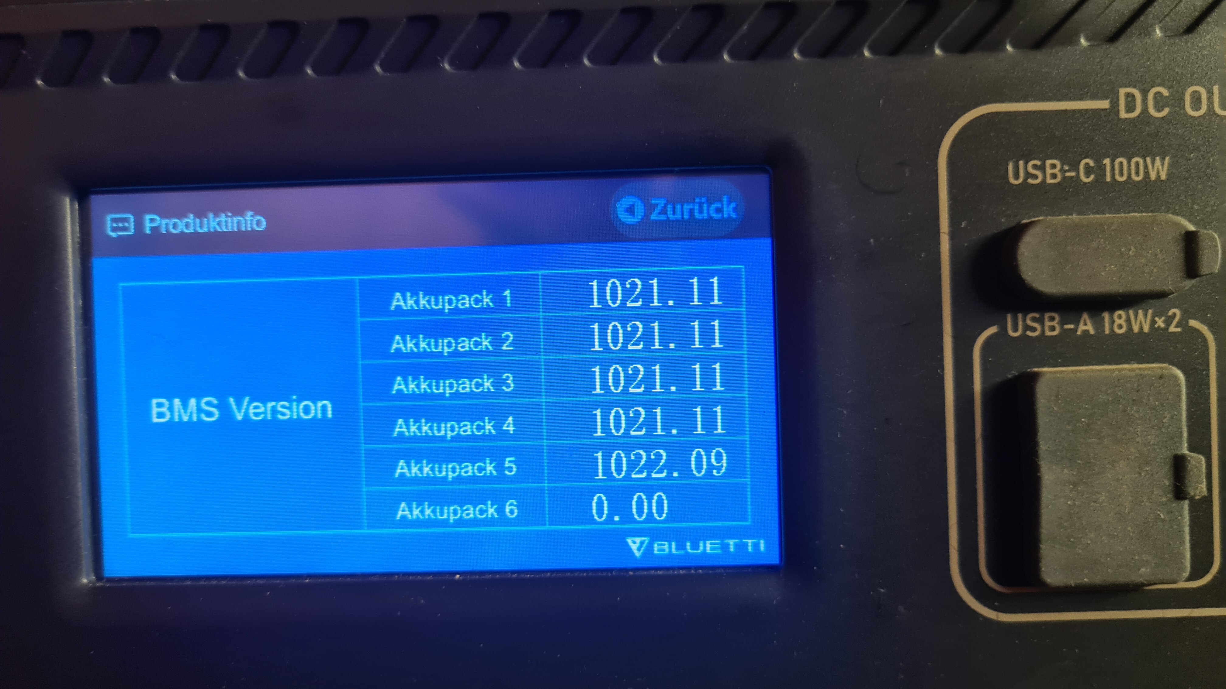

Yesterday, I discovered that there’s ar BMS updates available for my batteries:
B300 from v1021.11 to v1021.14
B300K from v1067.11 to v1067.14
No new update is offered for my B300S; it remains at v1022.09.

Hi @Akel ,
The tech team has already pushed the BMS firmware updates BMS106716, BMS102115, and BMS102215 to your system. When updating, please disconnect the other battery packs and update each one individually, then run a full charge and discharge cycle for each pack.
These updates are mainly designed to optimize the SOC algorithm, which helps make the battery levels more even across all packs.
