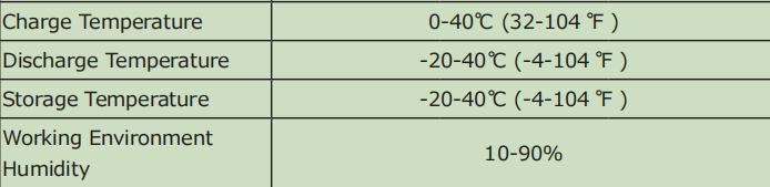

@Israfel The AC300 does not come with IP protection and is a plastic enclosure; see below for operating temperatures:
Long-term placement in a fully open shed is not recommended; extreme temperatures and humidity can affect its lifespan.
Get a sturdy cart for your AC300 and batteries. When you need it in your garden or shed. Use it there. But to keep your device safe and enjoy a long lifetime, store it in your home afterwards.
In that way you protect it from high humidity, condensation and extreme temperature fluctuations.
