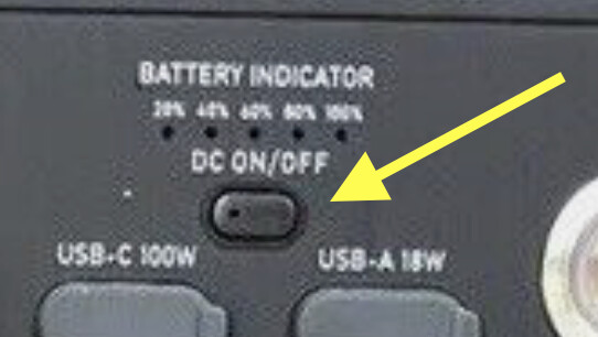

Then I remembered, that both B300 batteries had a SoC of more than 80%, which is unhealthy to keep for a longer time. So I thought: These batteries CAN operate stand-alone w/o the AC300 when using DC in/out only. So I disconnected the B300 batteries from the AC300 and tried to use them as individual DC power banks. But no matter which of the B300 I turned on: Both showed a high SoC (by status LEDs), but didn’t output any power using 12V out or USB-C out (with the same load on USB-C I was using on the AC300 port before and a 12V adapter staying completely dark instead of showing 12V input as it should).
Now I’m lost!
Do I have three faulty products? Or just a faulty AC300? Or two faulty B300? Why isn’t there any output from the stand-alone B300 batteries?

Hello, just to better understand if the B300 can be excluded from the problem: when you used the B300 to power your equipment and turned on the DC from the battery, did the green LED on the button light up?

Hi ndwr,
many thanks for your reply. The part about B300 DC out was my fault. The B300 batteries are not in plain view of sight (a bit hidden behind other stuff), so when I plugged in my DC components, I didn’t notice the small DC on/off button at all. And I also overlooked it’s presence in the manual, where it is labeled, but w/o it’s own “usage” section. Still, fool on me.
So B300 part of the problem solved and nerves calming down, just one component with problems.

Hi BLUETTI_CARE,
sorry for the B300 issue, that part was my fault. I never used the DC out ports of the B300 batteries directly before and those batteries are somewhat hidden from view, so I just missed the additional step of pushing the “DC on/off” button. This is solved, DC components are now working, Voltage out on the 12V ports shows a bit over 13V which should be fine.

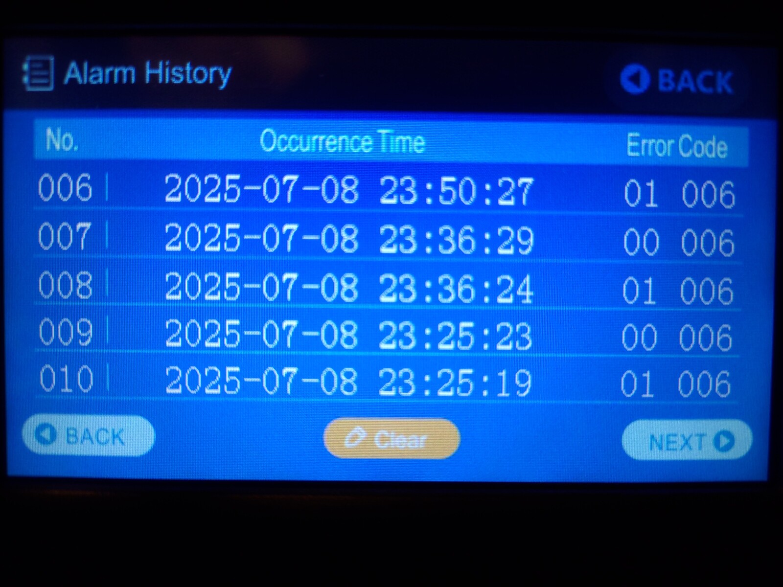

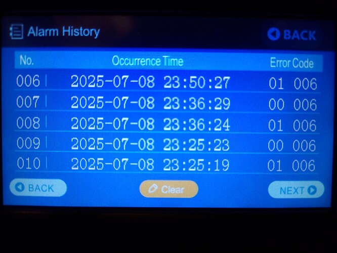

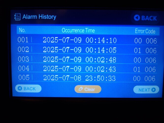

So after nearly two years of flawless 24/7 operation, the slave unit in my split-phase AC300 system started exhibiting the exact same problem yesterday, spontaneously turning the AC output off and then back on again - within a second or so - at least a dozen times within a span of a few hours (it also triggered a reset of the master unit every time, of course) …
The slave unit alert history shows 006 SPS Low Voltage Errors each time (the master unit only shows the 024 Phase Integration alerts, which are normal, I suppose).

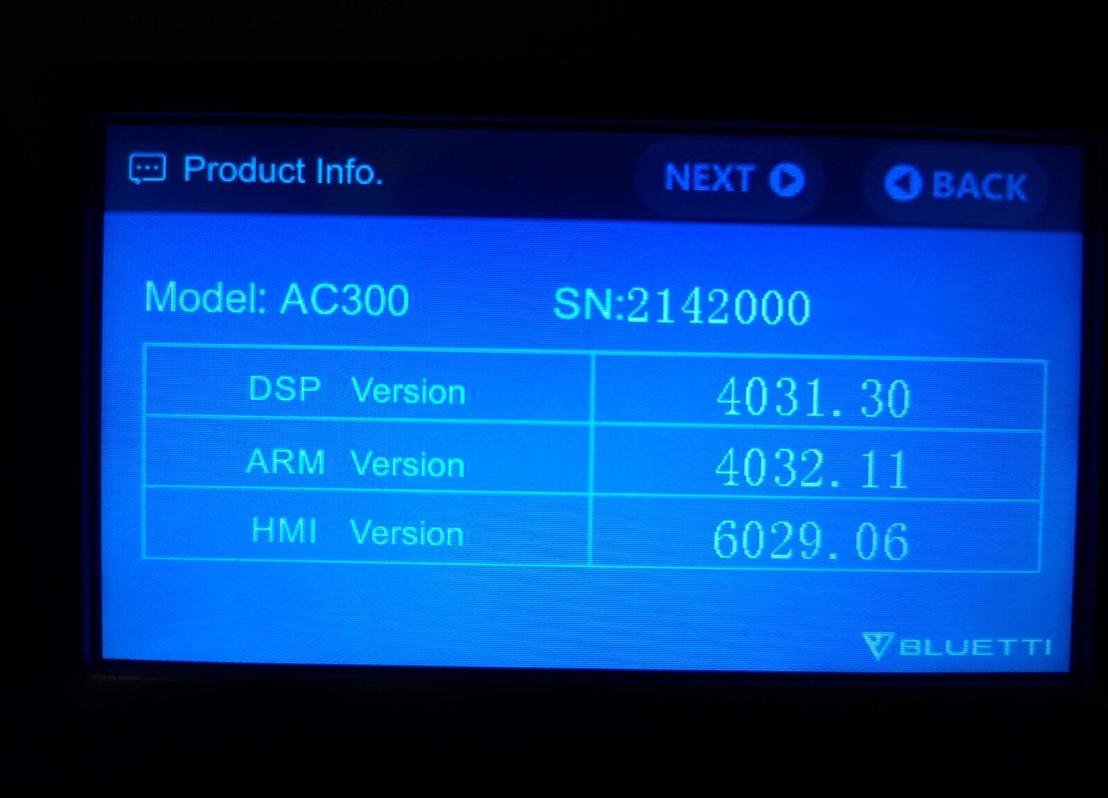

Just an update, for the record:
Did a full firmware upgrade of the AC300 in question to all latest publicly available firmware (picture below), to no avail.

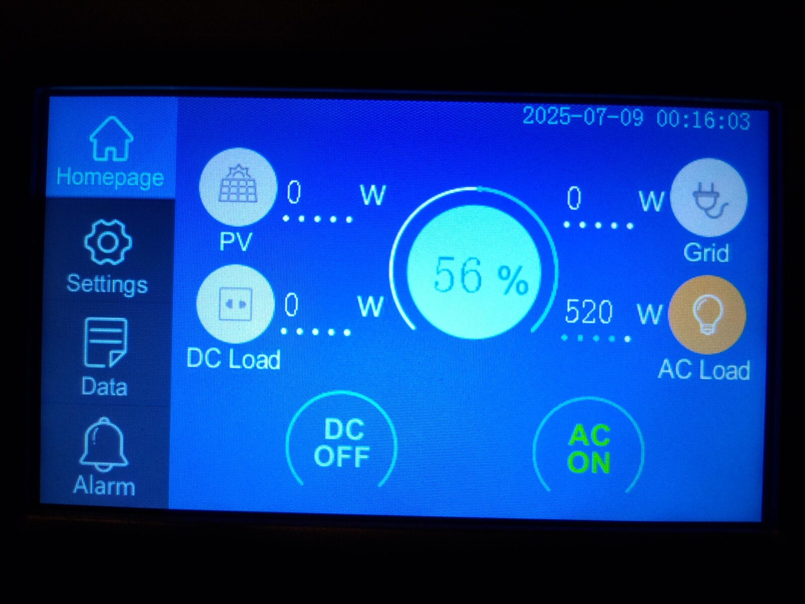

Also did a load test under a constant 520W load and it pretty consistently reset the AC output every 11~12 minutes. Hope it helps with your diagnostics just in case you are still wondering the cause of the issue.
