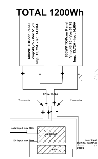

Will the attached diagram work? I appreciate your help.
1- Can I use it by separating the power from the panels I will be using?
2- Will the AC200max receive 900W with this separation?
3- Will the D050S work if it receives more V than the input value?
