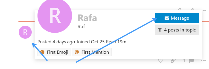

Okay how to send you a private message @BLUETTI_CARE
I’m very new on this forum :slight_smile:
