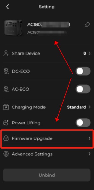

Hi @ptuner101, We can push the new firmware to your AC180 to enable the AC output recovery function.
Please log in to the Bluetti app, enter the Setting interface, obtain the complete SN code from the top, and then click on Firmware Upgrade to get the firmware information. Please refer to the screenshot for reference.
Once we have obtained this information, we will push the new firmware to you.
