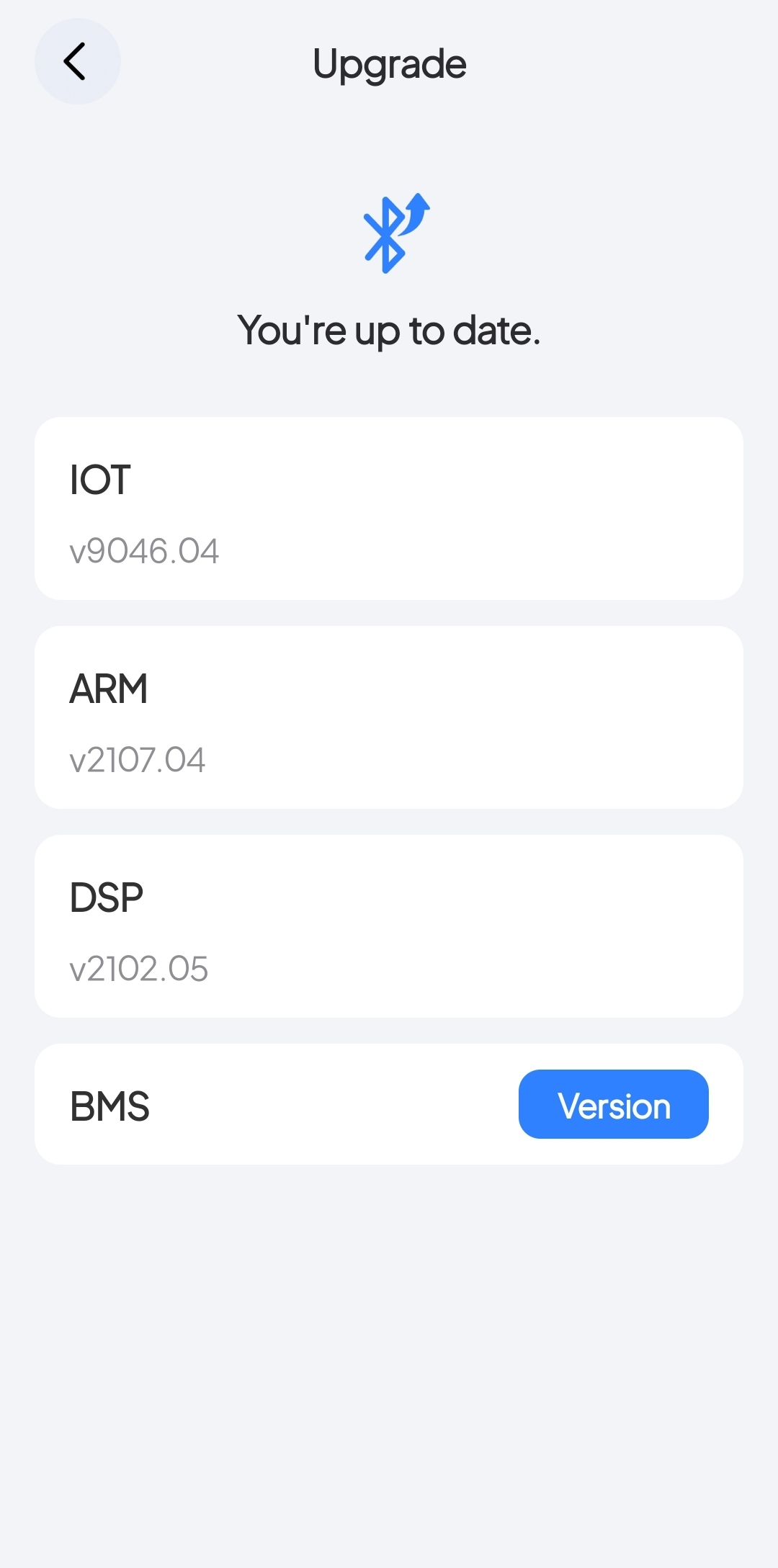

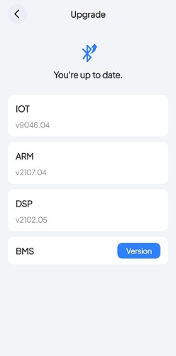

@BLUETTI_CARE I have the same issue.
SN: AC1802437001394167
IOT v9046.04
ARM v2107.04
DSP v2102.05
Please push update to fix the issue. Thanks.
Hi @smidjit, we would like to know more specific details.
Has the AC180 reported any errors? If so, please inform us of the specific error code. Currently, we only have firmware aimed at error code E013. If that’s the case, we will push it to you.

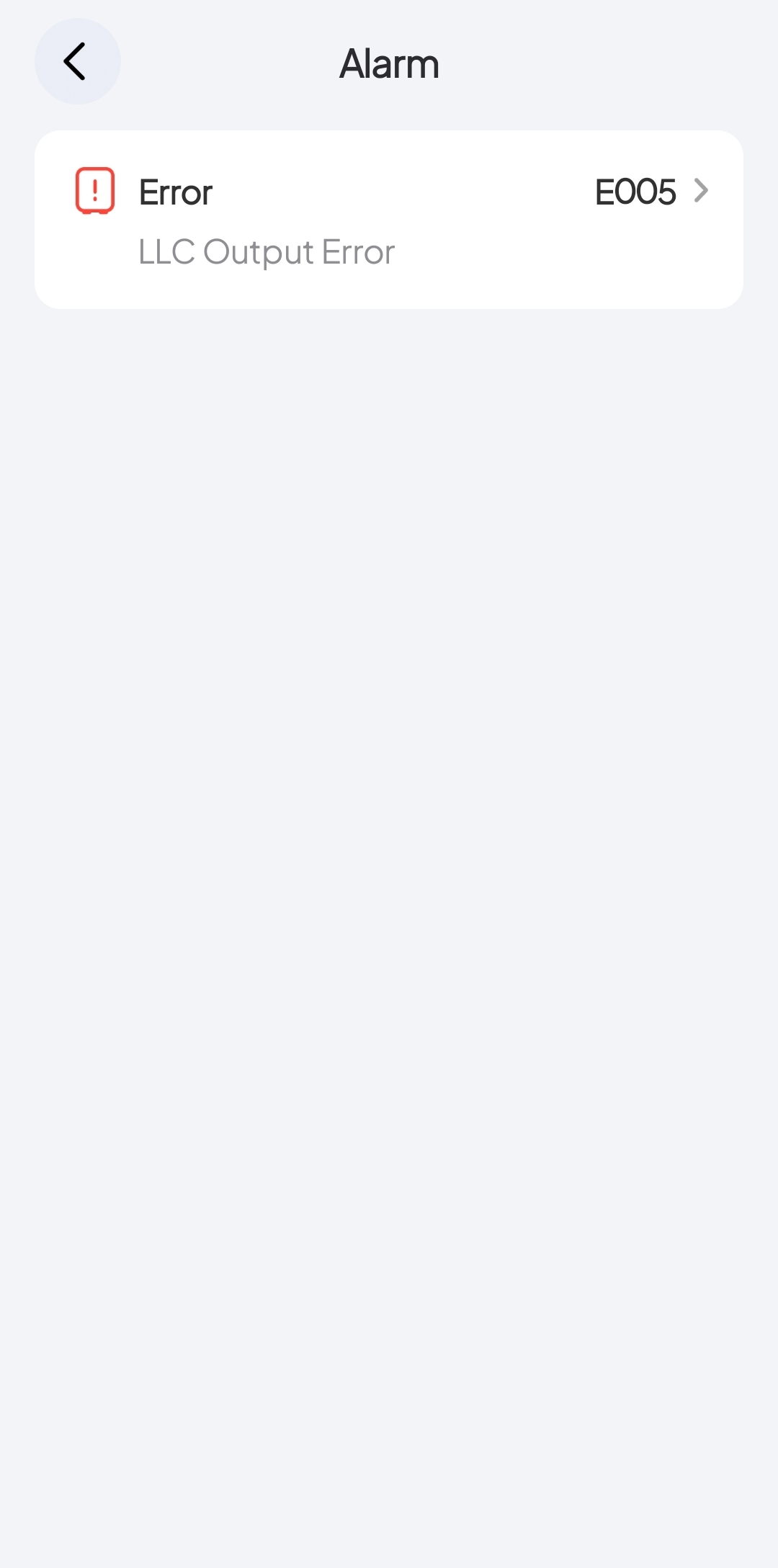

Flashing AC led, flashing “short” in red. And the attached error seen in the app.

Hi @smidjit, Regarding the E005 error issue, we currently do not have a new firmware update to fix it.
We recommend that you remove the load and then restart the device. If the problem still cannot be resolved, it will be necessary to arrange for warranty service.
If you have any questions about how to reach the appropriate customer service team or concerns about the service process, please send us a private message with your order information so that we can arrange priority service for you.
