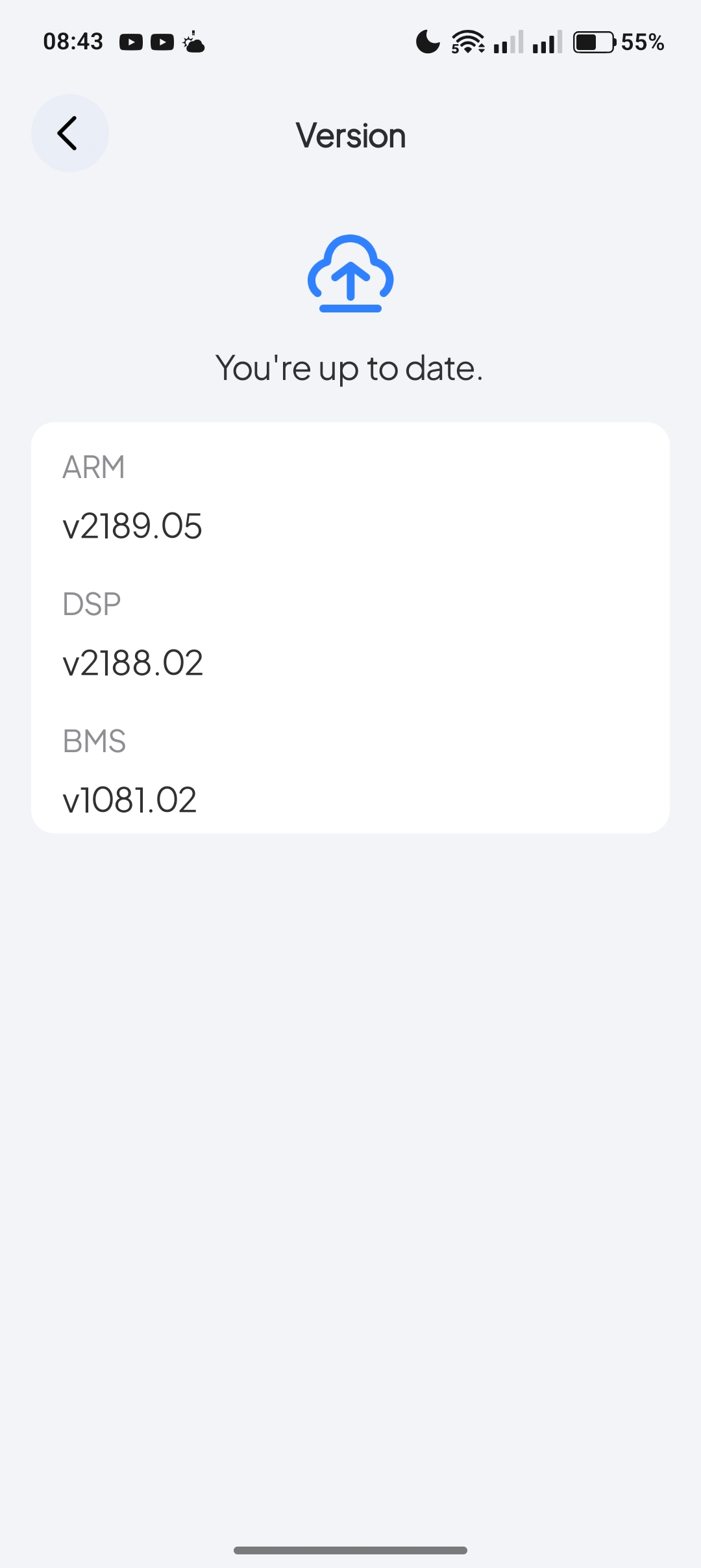

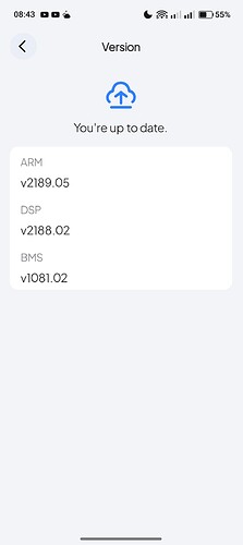

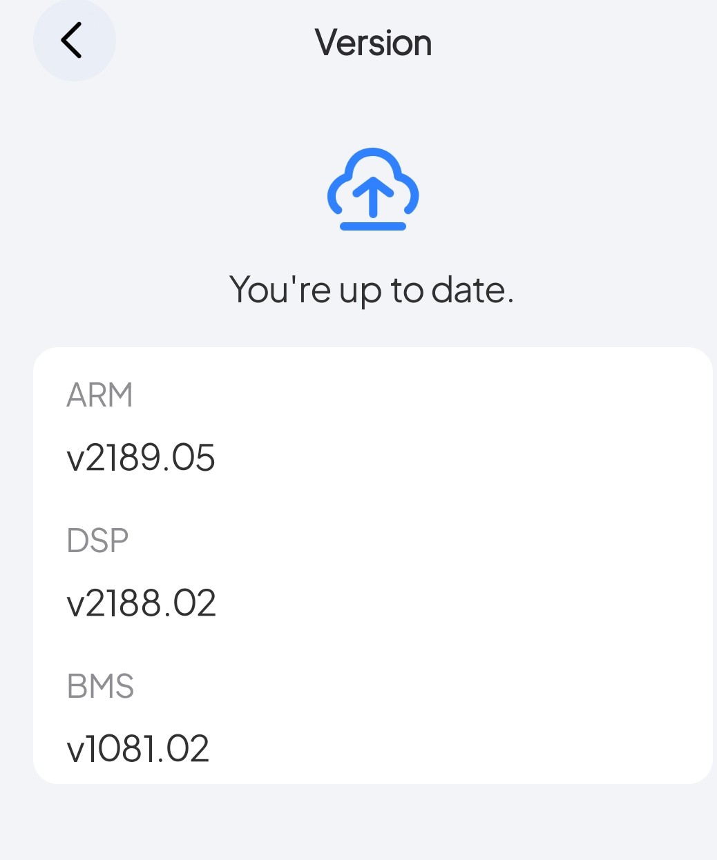

Seems like a weird problem with firmware levels and functions between country models? Do you have the availability to the same firmware levels I showed?
(I tried another phone that did not have the app installed to test if the phone was the problem, it’s not… :neutral_face:)
The firmware version I posted was the latest for my 200V2. I’m in US.
Pinging @BLUETTI_CARE
Hi @jurgen, Yes, we have a new ARM firmware that enables Sleep mode, which hasn’t been sent out in bulk yet.
Now I have applied to upgrade your system to our IT department. They will push the latest version of firmware to your unit in 24 hours.

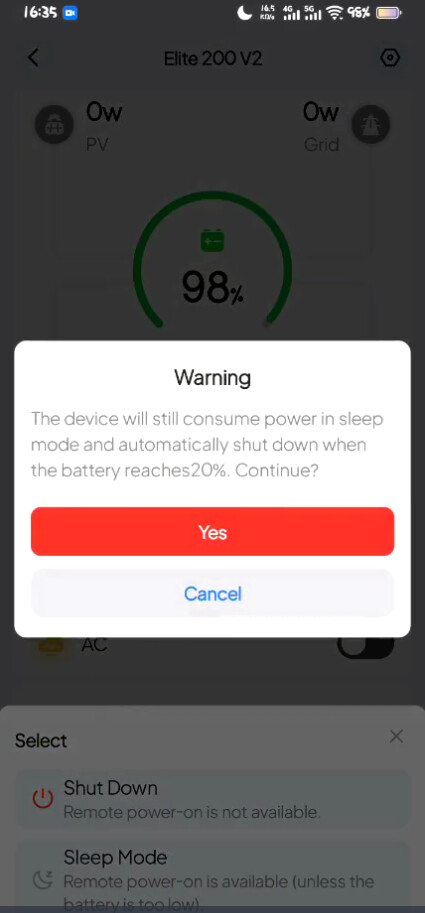

Works! The sleep mode is available now! Thx!

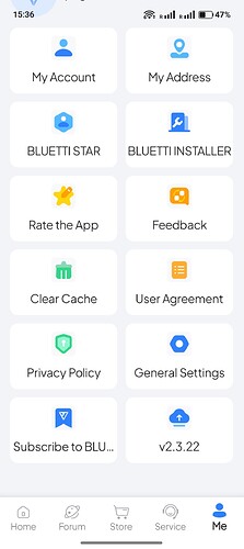

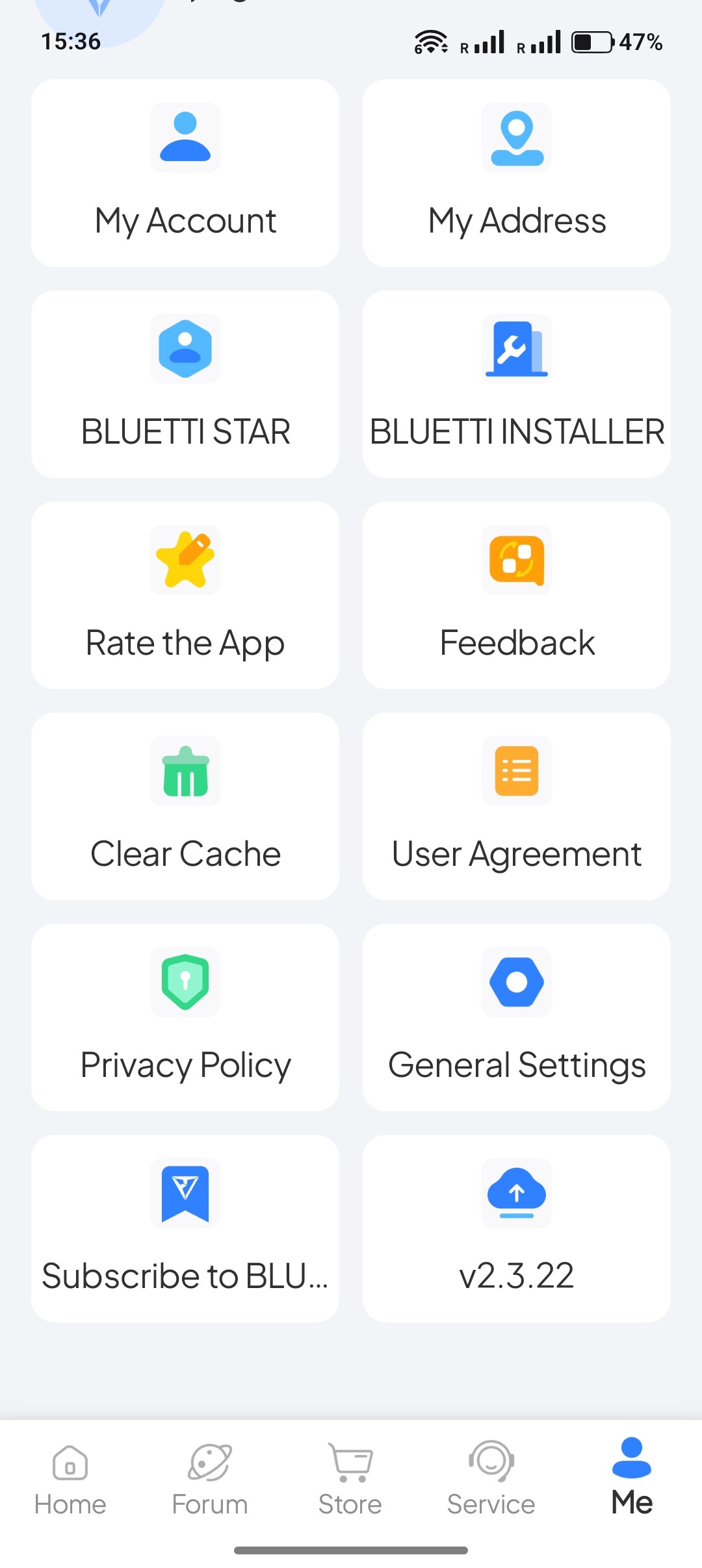

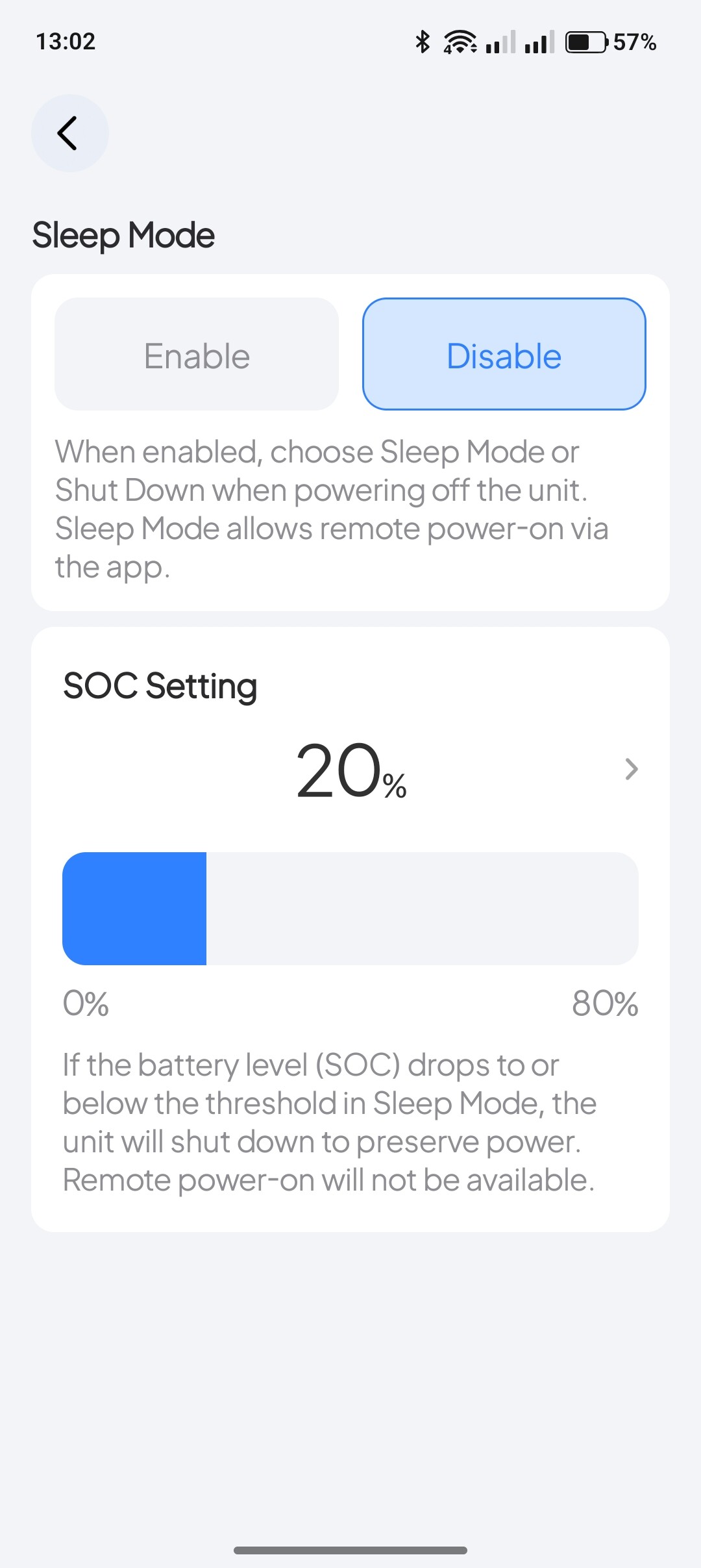

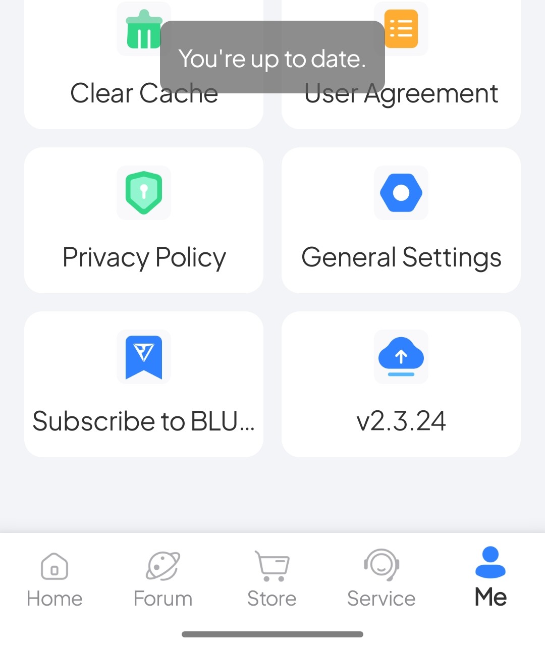

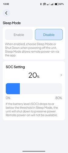

Hi @jurgen, Could you tell us your app version and whether it has been updated to the latest one? In addition, what is the minimum SOC value you have set? Please provide a screenshot to show us your settings.
Thanks to @Louis1 for the professional explanation, which is very helpful!
@BLUETTI_CARE hi, it does not matter whether sleep mode is disabled or enabled. Soc level is set below real soc level. Versions as in screenshots, should be up to date.
Hi @jurgen, We guess that it might be due to the protocol version not being updated.
Please restart the device first, then enable the sleep mode. Under normal circumstances, the screen should turn off directly.
In addition, please note that you need to return to the SOC main interface, scroll to the bottom, select “Sleep Mode” and confirm to active it.
@BLUETTI_CARE
Hi, i disabled sleep mode.
Shut of the device.
Disconnected everything.
Turned on the device.
Enabled sleep mode on 20% while soc is 53%.
Device remains on indefinitely…
It does enter sleep mode when I press the power button.
Regards Jurgen
