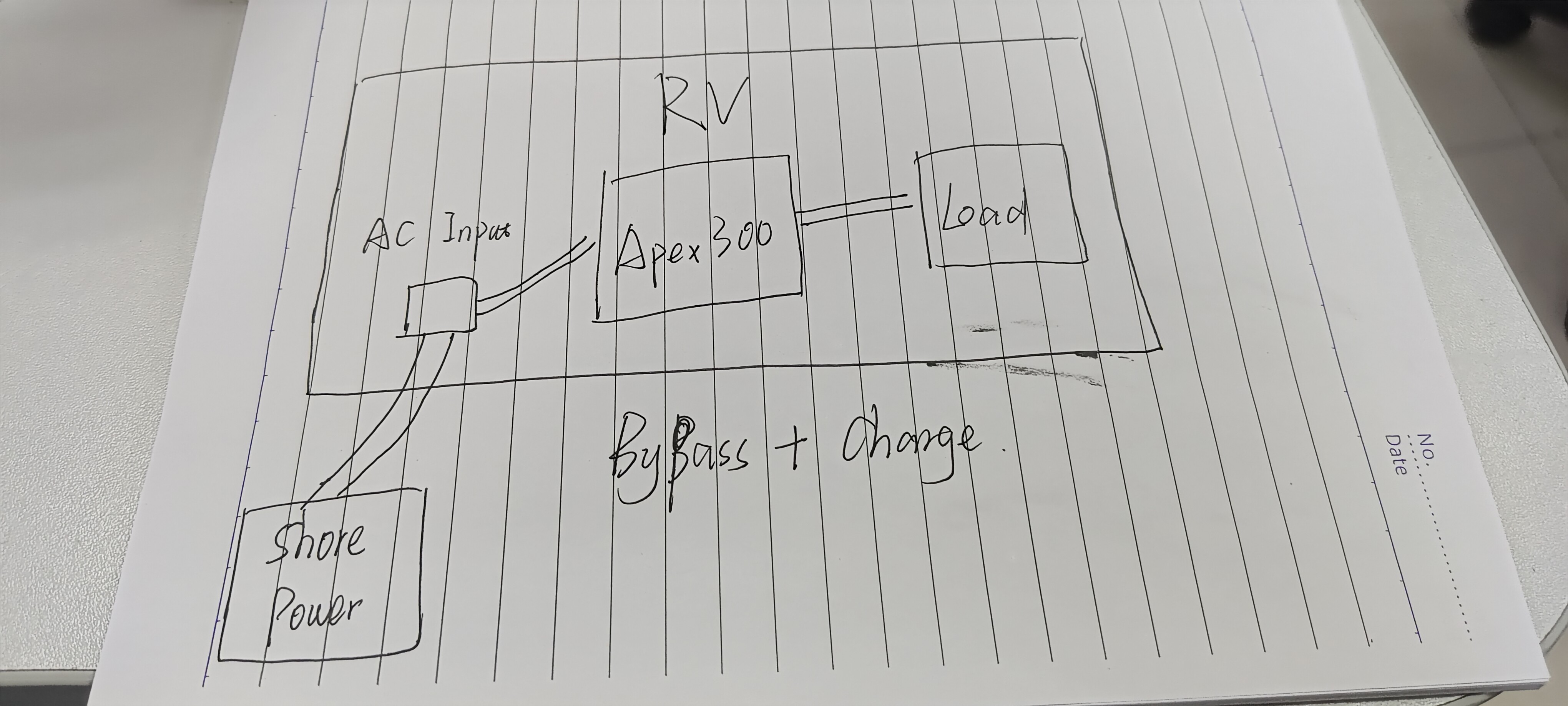

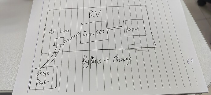

Hello,
I have a suggestion that does not require an ATS, provided that the APEX300 can support the loads within your RV. You can connect the shore power input of the RV to the AC input of the APEX300. This way, when shore power is available, the APEX300 can bypass and charge while supporting the load. When there is no grid power, you can use the APEX300 to run your loads.
Please refer to the diagram below.
If you have any questions, feel free to contact me!
Thanks for the response and the visualization!
I should have mentioned, the ATS is internal on my rig and already in place, unlike some other motorhomes where there is a “generator plug” in the wiring bay. Other than that this looks very similar to the idea I had in mind.
Yes, the Apex can handle the whole house load. The rig as wired for shore power is only a 30A circuit and when running power tests the only time I’ve exceeded that and blown the main breaker was when I had the Refrigerator, Microwave and Oven fan running and then started the air conditioner (big current draw on startup).
