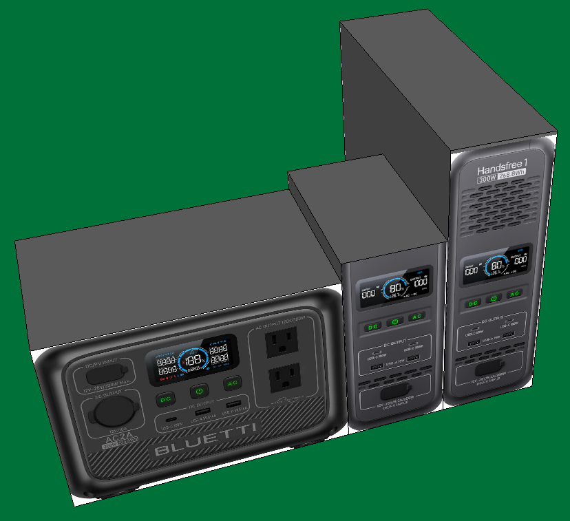

What I would like Bluetti to make
I would love to see something about the same size as the competition, with a true XT60 solar input, at least two USB-A and two USB-C ports (with support for 5V, 9V, 12V, 15V and 20V). If there is enough room, a 12V car socket would be nice but a DC5525 or similar for 12V would be okay in place of the car socket. I'm guessing they should use the same DC size as their new Elite power stations to keep compatibility problems to a minimum. Capacity between around 200 to 300 watt-hours to compete with the other DC power stations from their competitors.
I was thinking, maybe a "Handsfree DC" model, shorter in height but also half shorter in depth. The front width is already perfect and is probably the minimum required to use the LCD display. Maybe a "Handsfree 200 DC" and "Handsfree 300 DC" or something. The weight and size/volume has to be similar to the competition.
Here's a concept image for the "Bluetti Handsfree 200 DC" vs the Bluetti AC2A and the Bluetti Handsfree 1:
