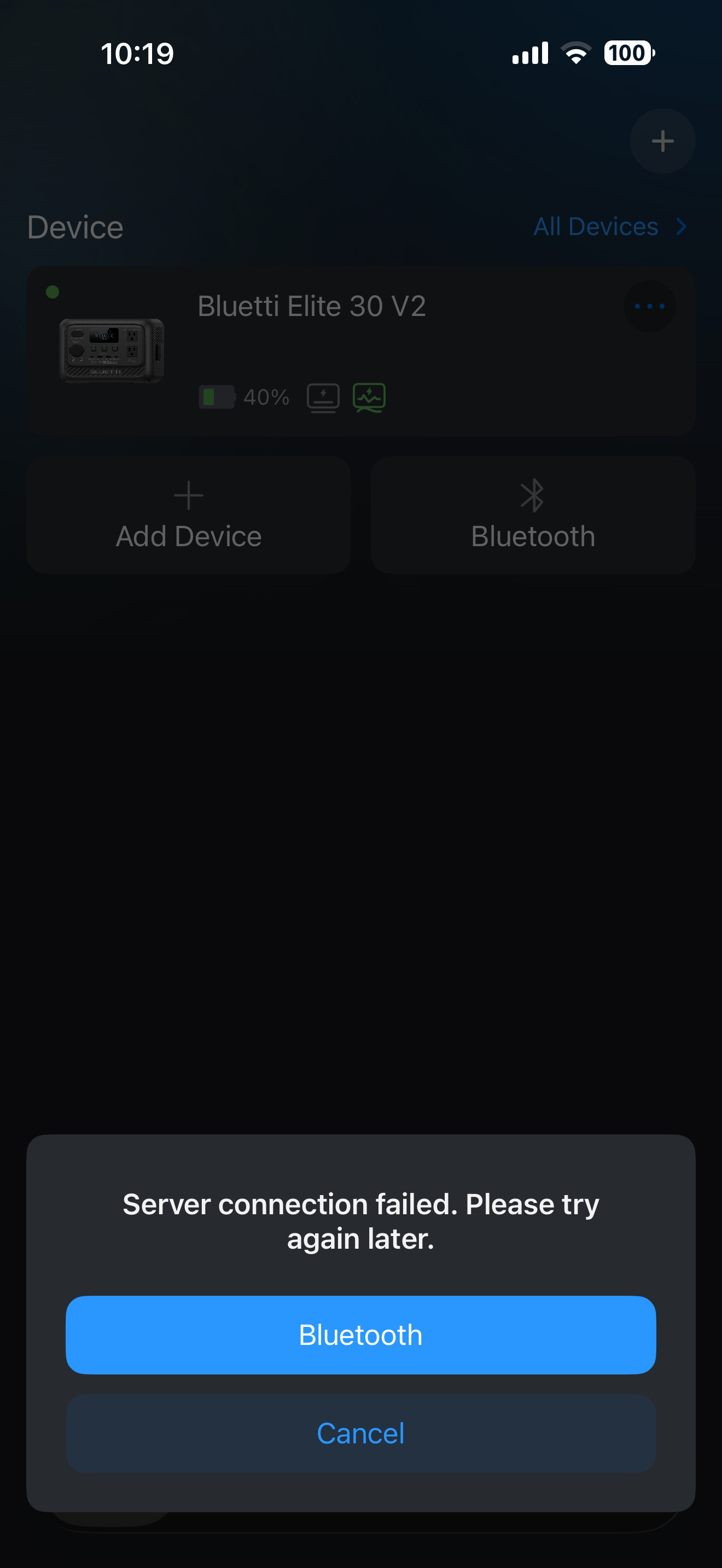

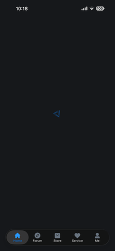

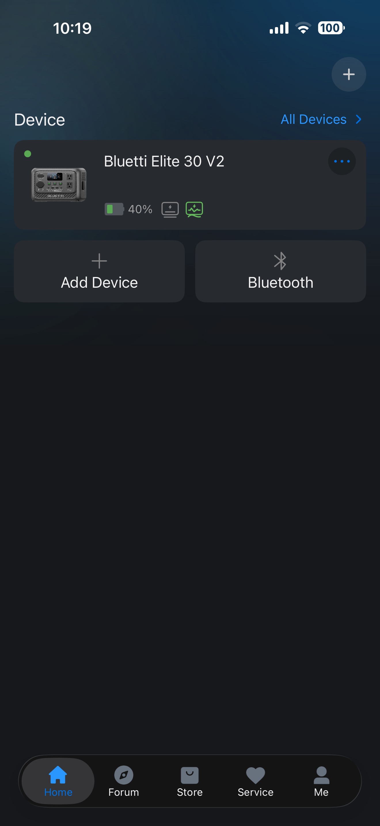

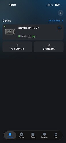

When I open the app, the Bluetti Elite 30 V2 appears (though sometimes I only see a blank screen with the Bluetti logo). However, when I attempt to connect, I receive the message: “Server connection failed. Please try again later.” Afterward, I’m given the option to connect via Bluetooth.

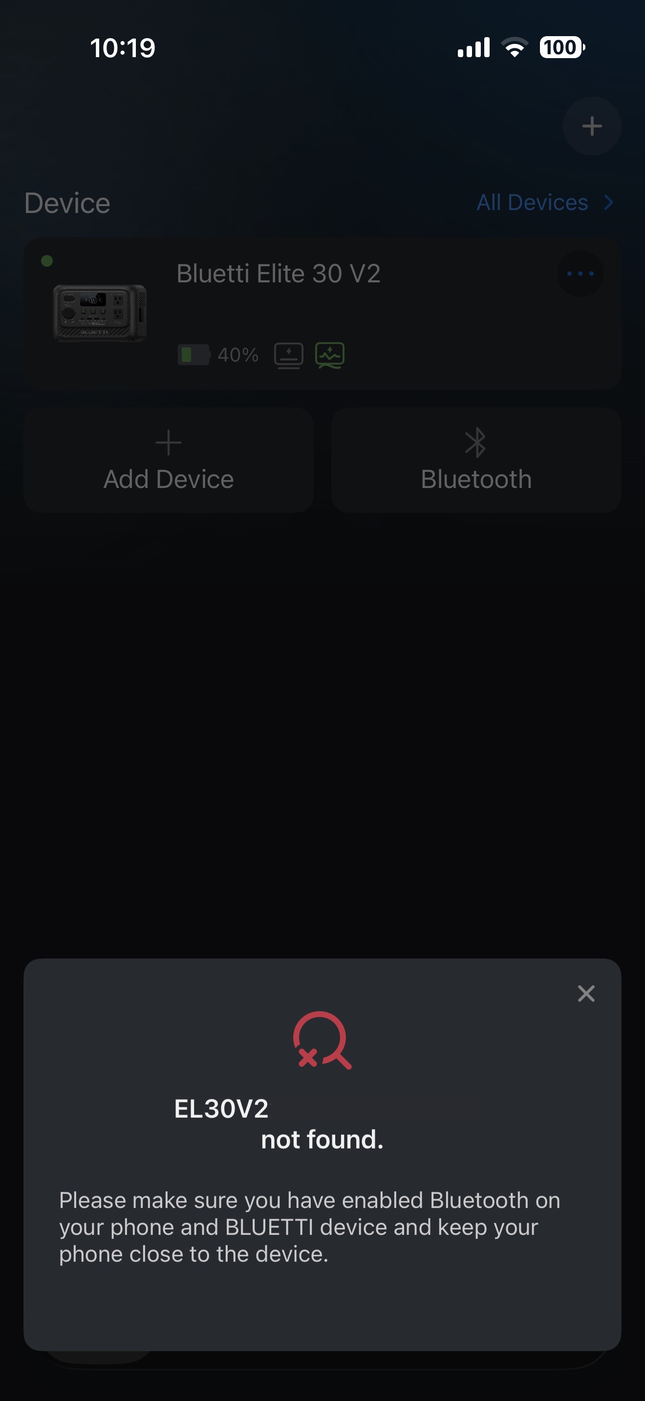

When I try connecting via Bluetooth, I get the following message: “EL30V2SERIALNUM not found. Please ensure Bluetooth is enabled on both your phone and the BLUETTI device, and that your phone is close to the device.”

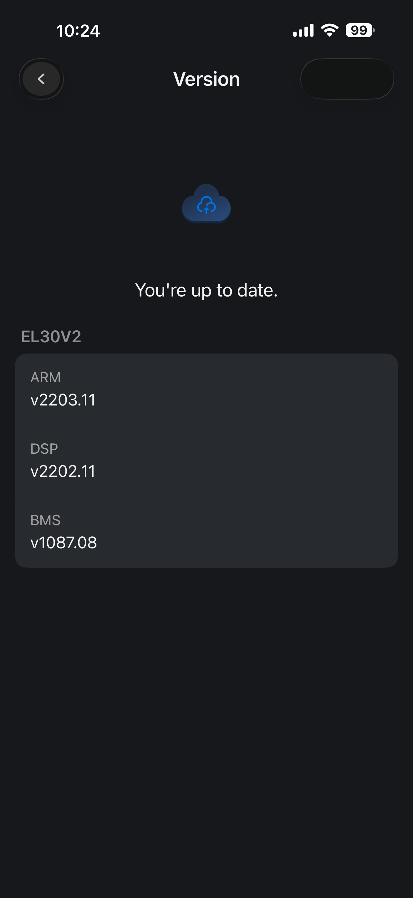

Firmware (click to expand)
Module Status Installed
IoT Up-to-date v8024.12
ARM Up-to-date v2203.11
DSP Up-to-date v2202.11
BMS Up-to-date v1087.08

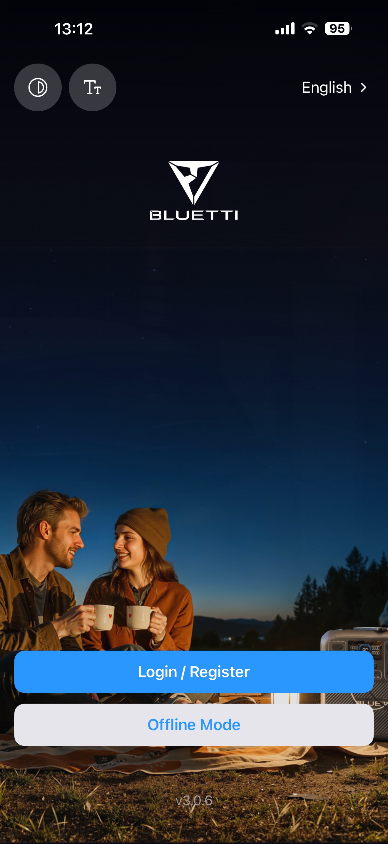

Update: I uninstalled and reinstalled the Bluetti app (v3.0.6). After that, I was no longer able to log in. After multiple attempts, I was finally able to log in again.

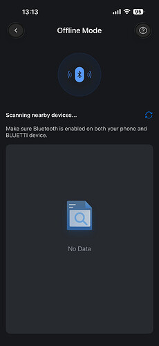

I am also unable to connect to my Bluetti Elite 30 V2 in Offline Mode.

Screenshots (click to expand)

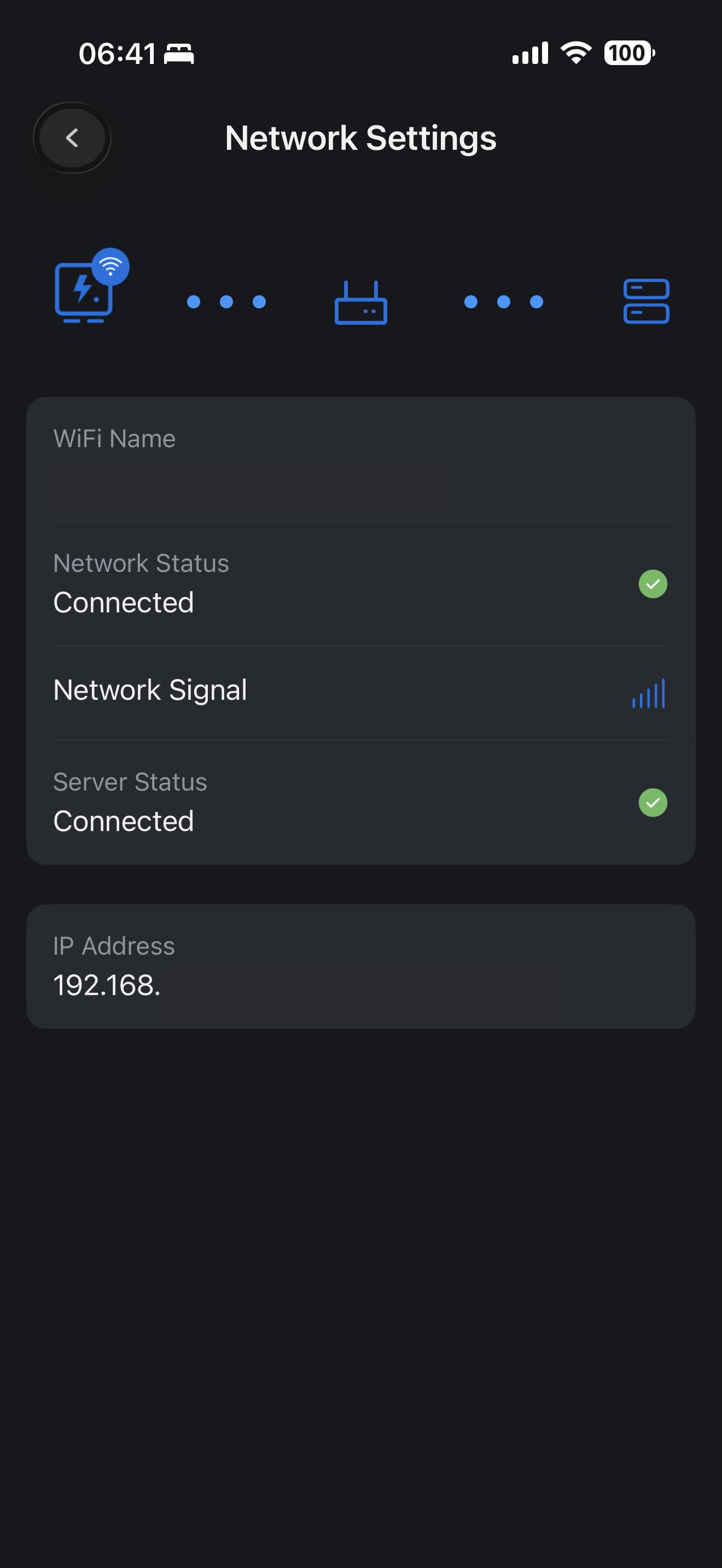

First, I would like to answer your questions: this is not a Wi-Fi issue. The Wi-Fi is correctly connected to my home network (see screenshots). The suggestions you provided were ones I had already considered and ruled out. If you had carefully reviewed my original forum post and my first reply underneath it, including the screenshots, you would have seen this. I must admit, however, that I initially forgot to include a screenshot of the Wi-Fi connection. I have now added it to this reply.

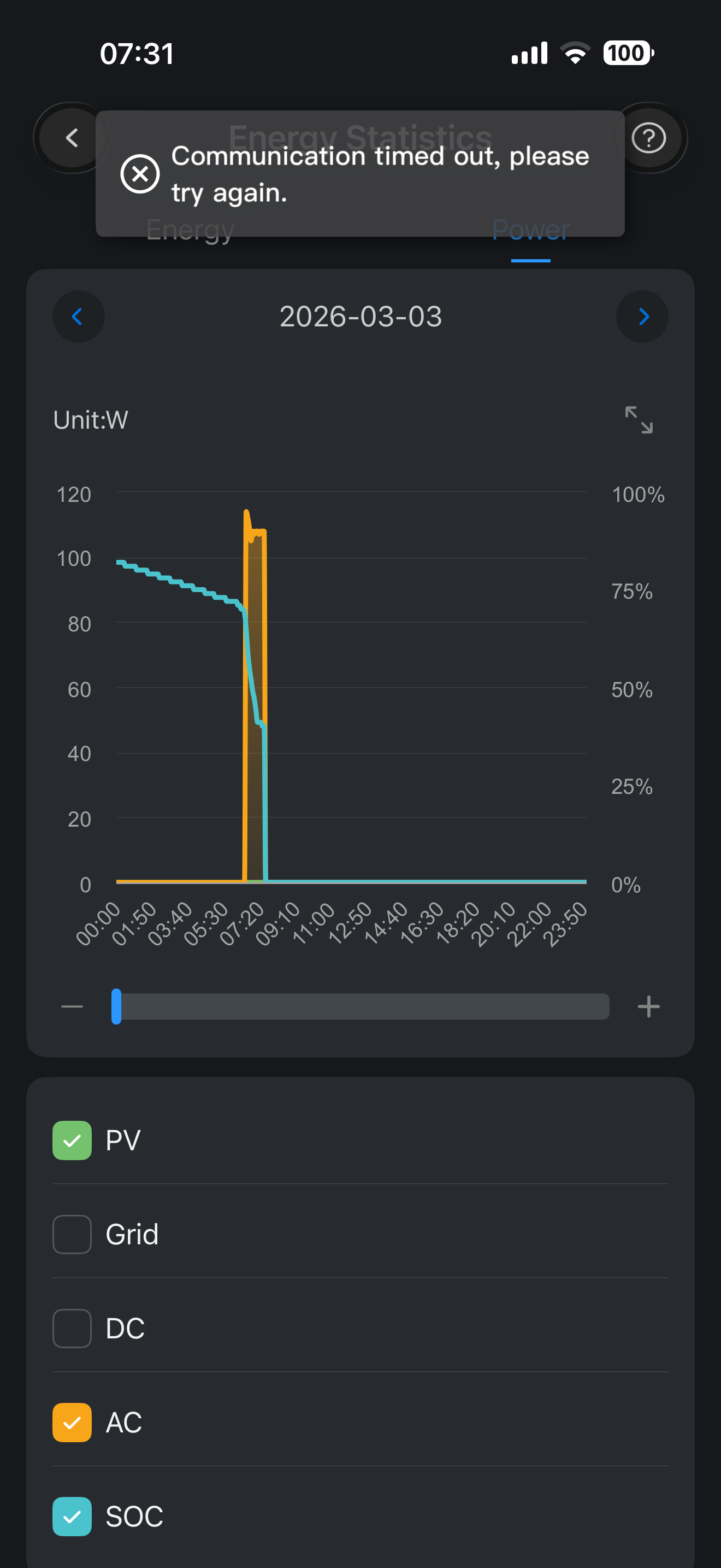

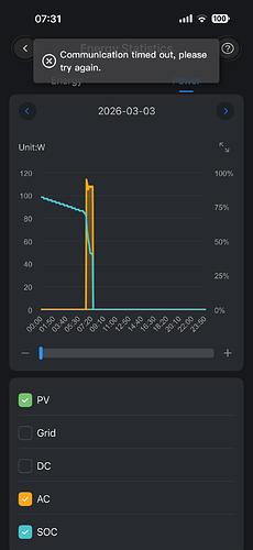

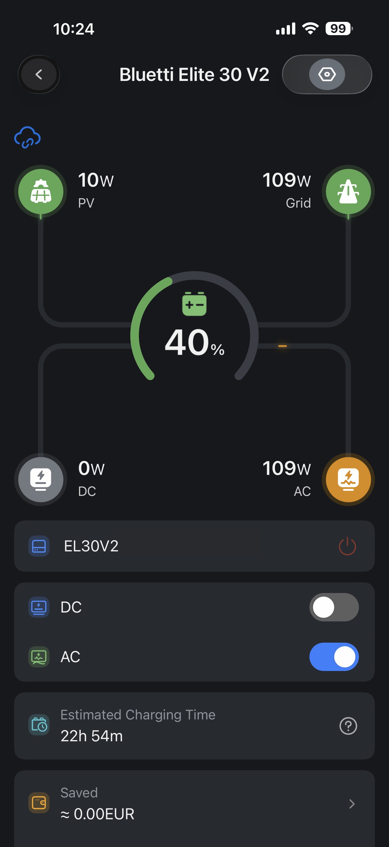

When I open the Bluetti app and wait approximately 45 seconds, I can select my device and view the dashboard of my Bluetti Elite 30 V2. However, when I try to open Energy Statistics, for example, to see how much solar energy was generated that day, I first see a spinning Bluetti logo. Then I receive the message: “Communication timed out, please try again.” (see screenshots).
This happens with all functions I attempt to use via the cloud in the Bluetti app; the same message appears each time: “Communication timed out, please try again.”
