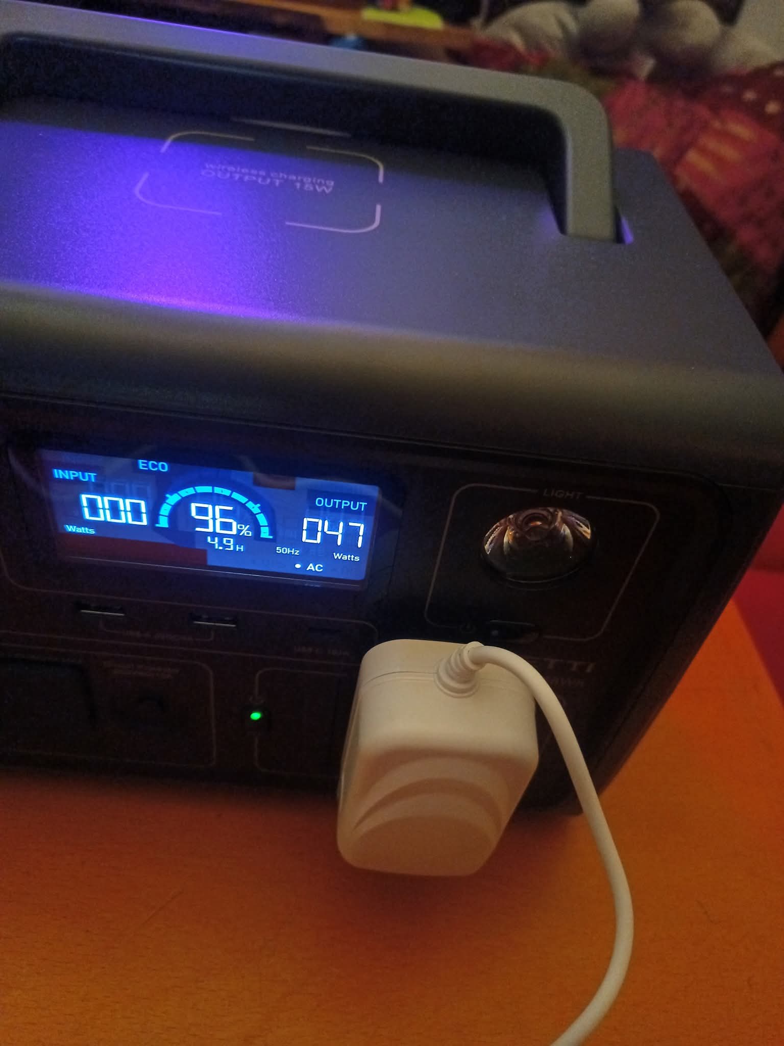

Devices that consume a declared and maximum power of X watts ( 24 watts in my test - fan that work with input of 12 Volt up to 24 Watts ) appear on the device that consume almost twice as much power! 48 watts.
( 48 watts instead of 24 watts ) Is this a software problem?

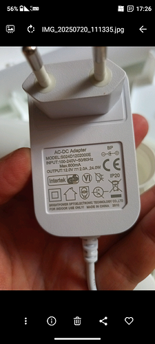

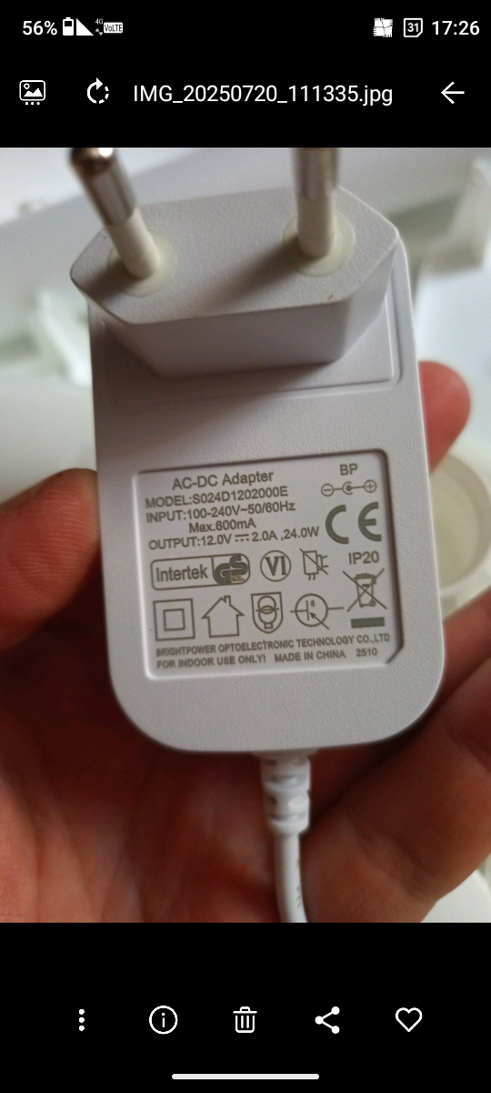

For example, I gave here a transformer with a maximum power of 24 watts connected to fan. The transformer came with the fan.
But when connecting this 24 watts transformer to AC socket the watts power appears on bluetti almost double! About 48 watts.
The time that the eb3a device has left to operate till battery died is about 5 hours.

Photo attached of the fan label, transformer label, eb3a display on fan load in AC and DC.

This experiment actually simulates the DC power consumption from the bluetti battery. So it seems that the display shown by the bluetti is incorrect, showing almost double the power of 47 watts consumed by the transformer while the fan is on.
