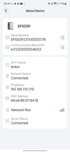

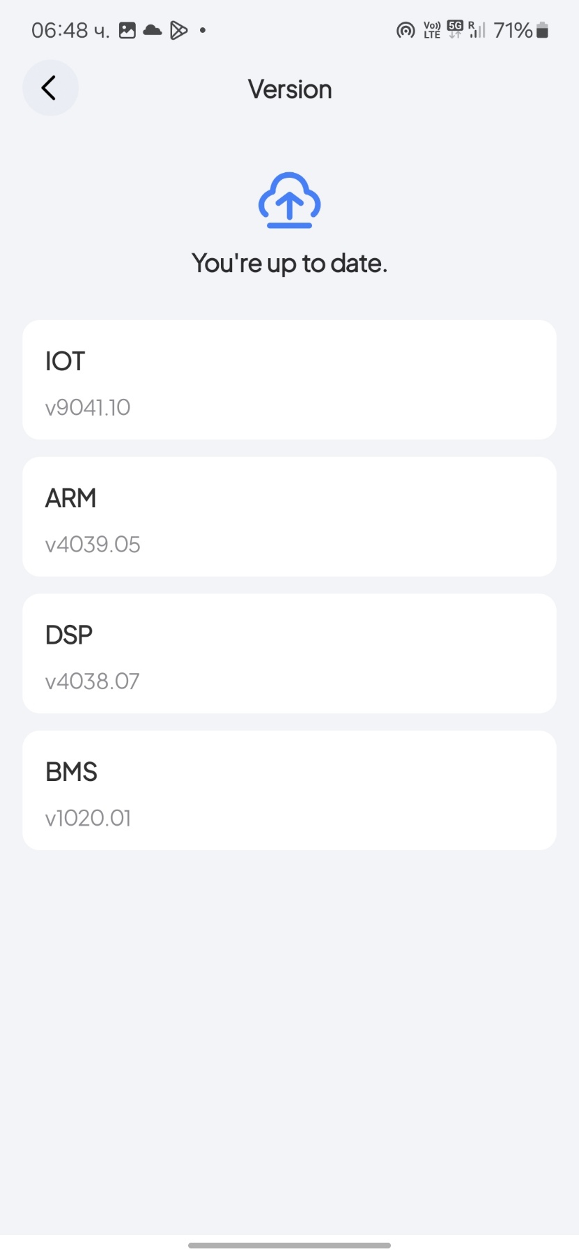

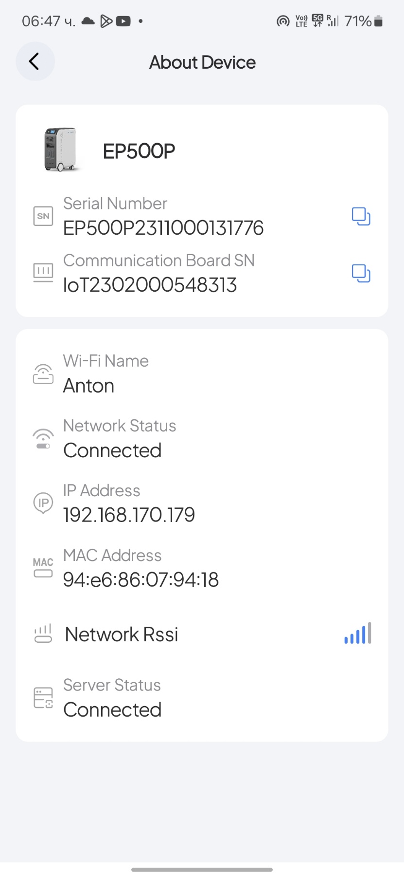

Before I got off the boat I took a screenshot of my phone screen through which I updated the firmware. I’ll attach it. I have a screenshot of the display of the incoming power parameters from the generator.
There are no alarms or errors!

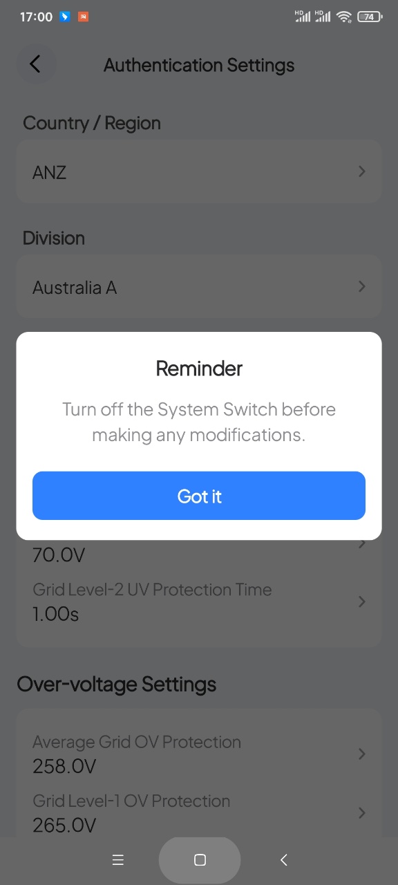

I already have Pro mode access to my device. The charge from grid settings are set at a maximum of 250W and 2A. Any higher for these values and the apparent internal EP760 consumption overloads the generator. Feed to grid is disabled. The “generator” and “grid self adaption” settings are enabled. The authenication settings are set to Australia A and are all default. DSP version is v5022.18. ARM version is v5023.21. Do you have a resolution to this issue?

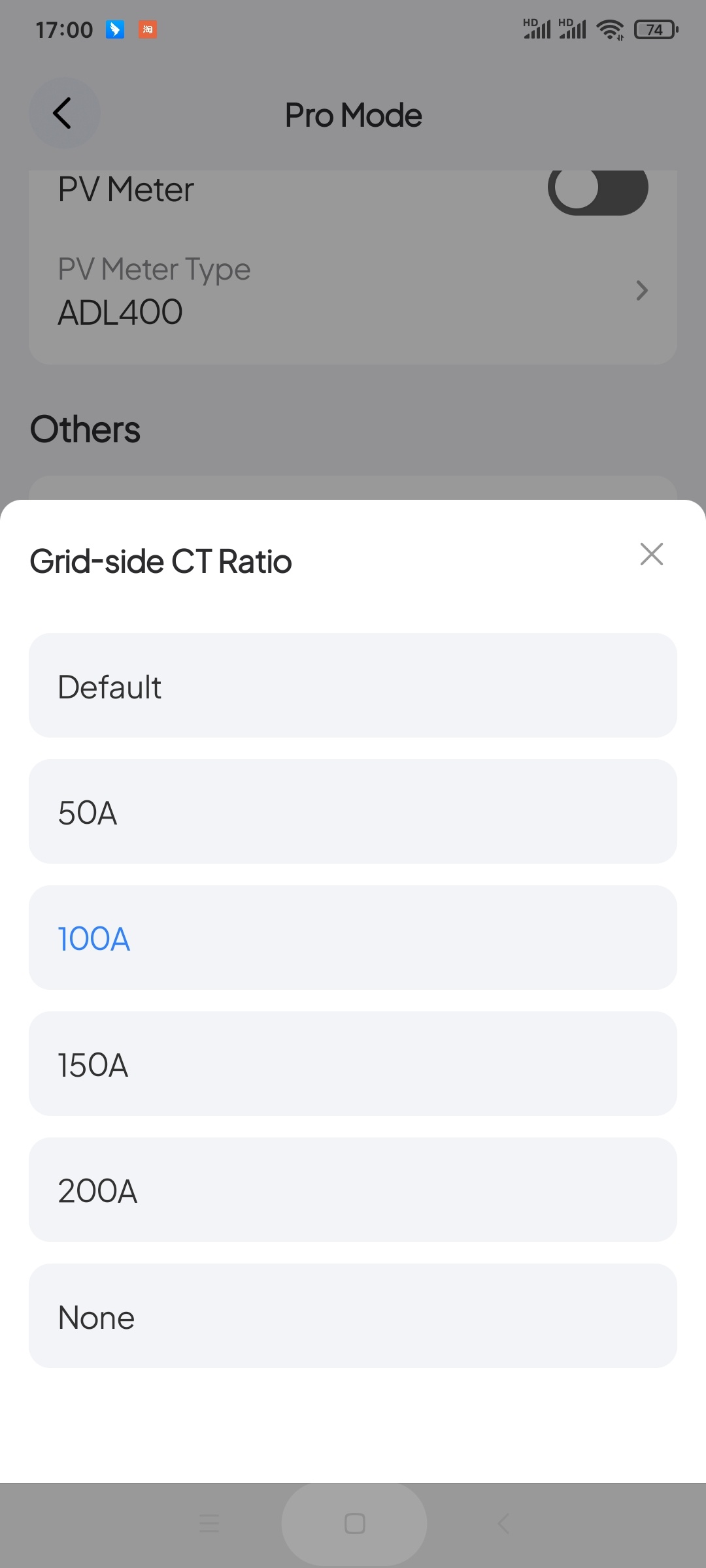

Hi @timwest73, To address the current issue, please follow these steps in order:
First, disable Grid Self-adaptation mode in your settings.
If you don’t have a CT connected, please set the CT current to “None”.
Disconnect all loads from the unit.
Then attempt to charge the system.
Finally, switch your regional/country setting to Standard mode.
We’ve attached a reference screenshot to help guide you through these adjustments.
Please let us know if this resolves the issue.

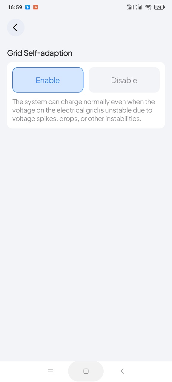

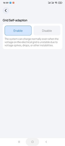

Hi @anton_obretenov, Please note that after upgrading the firmware, you need to update the app to the latest version, enable Grid Self-adaption, and then conduct the test.
Enabling Grid Self-adaption allows the device to better adapt to the power grid environment, ensuring the accuracy of test results. If you encounter any issues during the operation, please feel free to let us know, and we will fully assist you.
Hello, I updated. Everything works perfectly. Thanks for your help.
