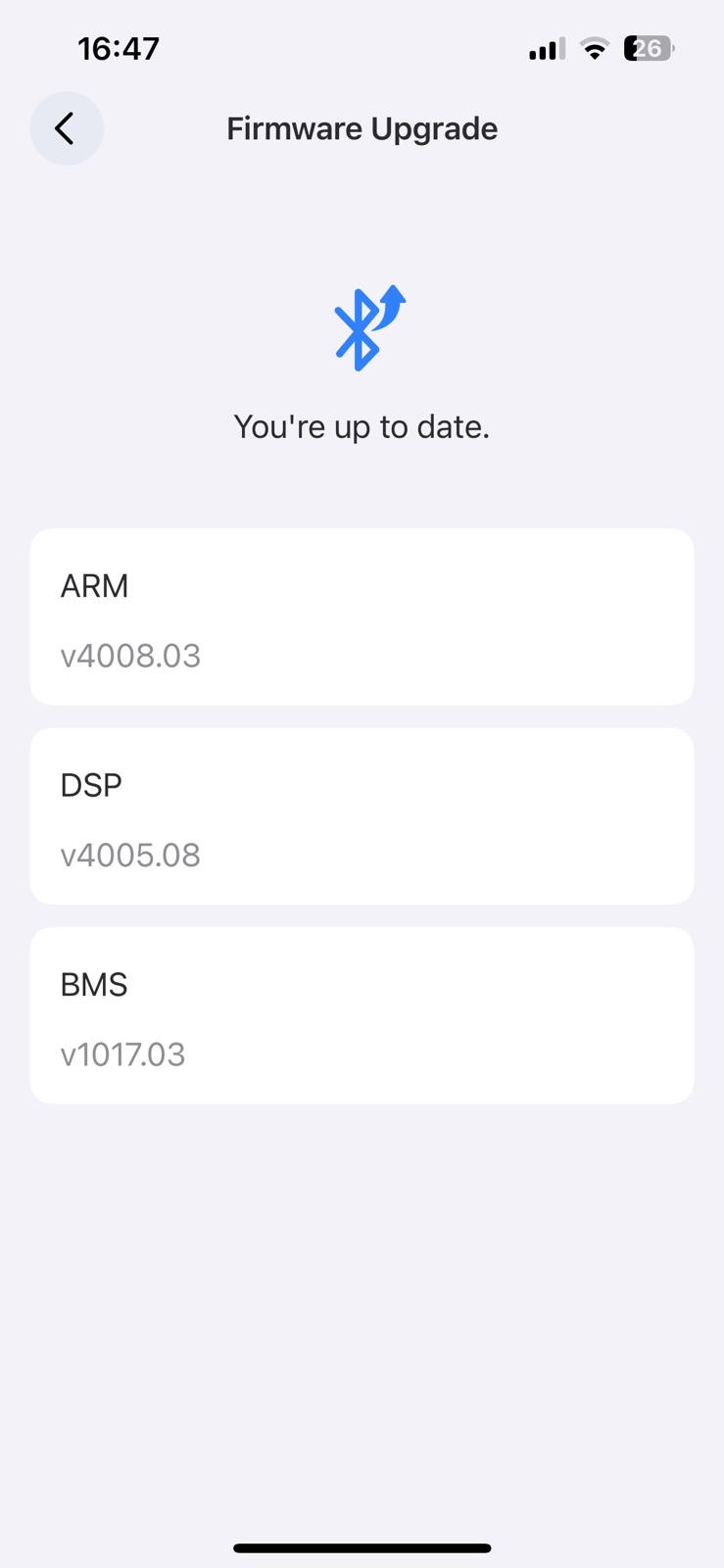

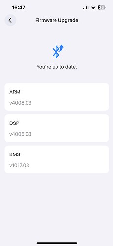

Hi, today my AC200MAX lost all power / when I connected mains supply it did not switch on AC and DC like my other devices. I understand there might be an update for my device to allow this.
Device details:
AC200Max: Ser:‭2240002848817‬
ARM: V4008.5
DSP: V4005.08
BMS: V1017.03
I also notice in the menu that Bluetooth is off and I cannot switch it on?
Thank you for your help in this matter
John
Hi @bluetti_jlaffeymecom, thank you for contacting us.
The AC200MAX is an earlier model, and we did not design the System Switch Recovery function for it.
If the AC200MAX cannot connect via Bluetooth, it cannot be upgraded even if we push new firmware.
To fix the Bluetooth connection issue, please first update the app to the latest version, then restart the device, your phone, and the Bluetooth setting on the AC200MAX. Does this work?
Also, please try logging out of your Buletti app account and connecting to the AC200MAX in offline mode. Can you connect successfully this way?
If that doesn’t help, please try unpairing the device and reconnecting it, or uninstalling and reinstalling the app.
We look forward to your feedback.
Got bluetooth working thanks. Pity there is no update for auto on. Thanks anyway
