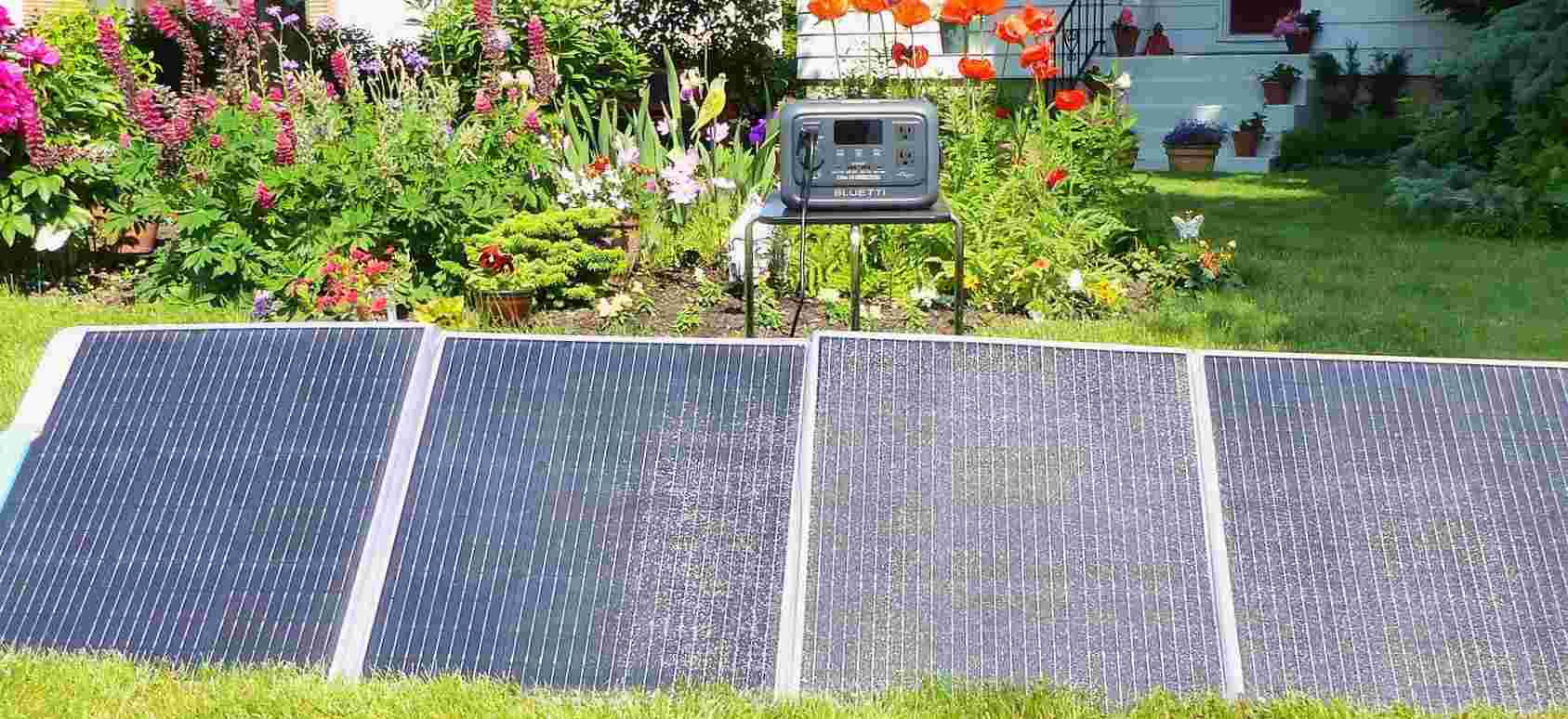

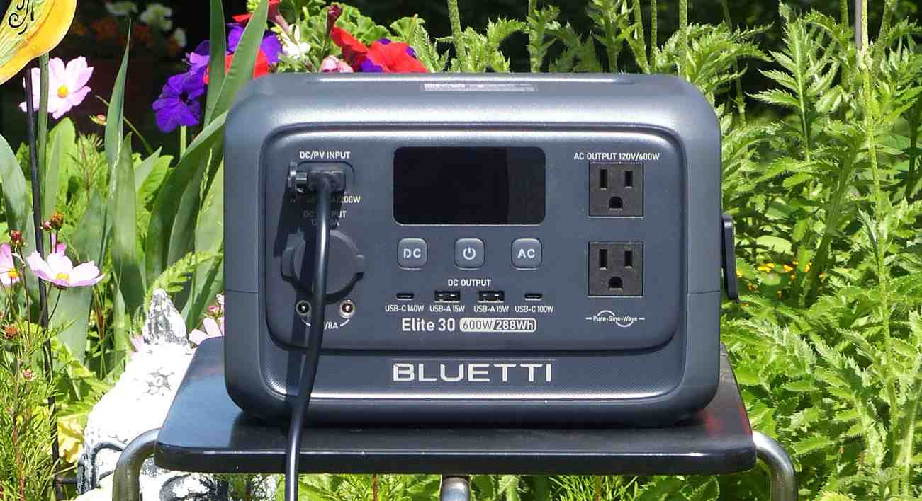

Here is the ELITE 30 V2 being solar-powered Via my Bluetti PV200 solar panel.
For me, I prefer my batteries be charged via SOLAR and the ELITE 30 can do that in approx 2 hours, as well it can be charged via your home’s AC, Car Charging, and Generator charging too.

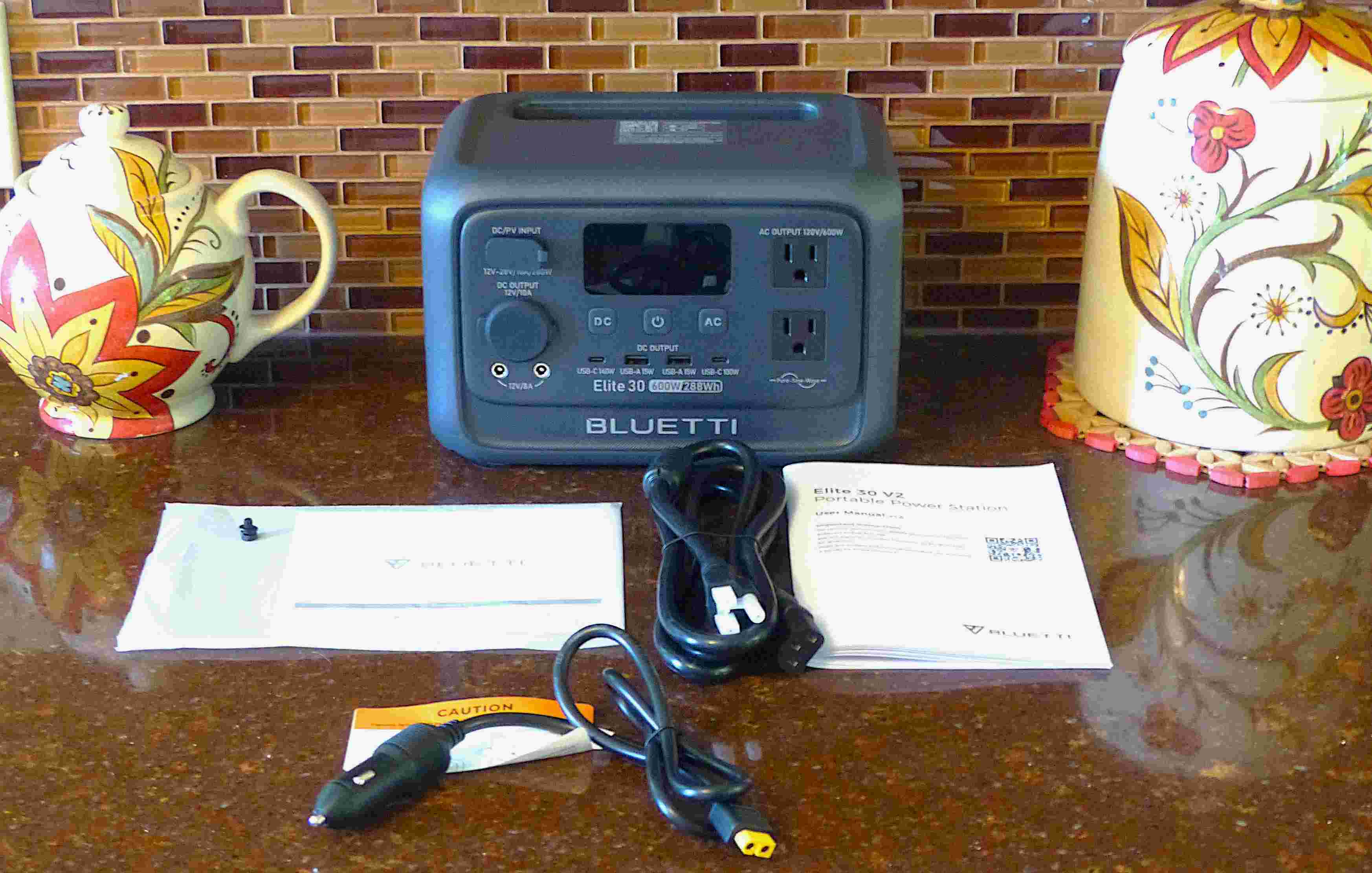

NEXT: What’s in the box:
The ELITE 30 V2:
Pik 4
AC Charging cable, Car Charging cable, Grounding screw
Operating manual.
Optional accessories include MC4-XT60 Solar Cable.

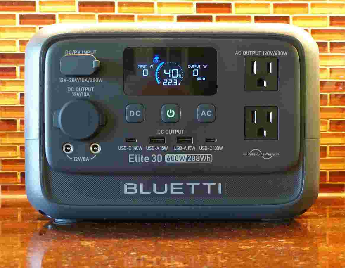

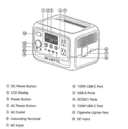

Let’s get to know the ELITE 30 V2 a little better,
Pik 5 Close up
Get to know your ELITE 30 V2

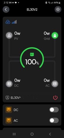

With this new design also comes new features like the new APP for the Elite 30 which has Bluetooth and now also has Wi-Fi, so you are able to control your battery from everywhere.
The APP lets you check the status of your power, consumption, usage and set parameters to control all aspects of your battery.
App Pg1You are now able to set your charging priorities such as when to charge, how to charge how much to charge.
You can also easily use solar power to re-charge your battery, then you are powering your equipment for free. What more could one ask for.

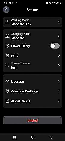

The new features in the App include
App Pg2
Time Control:
You can now schedule your battery to recharge from the Grid at off-peak times, saving you money.
PV Priority:
Easily program the App so you can now prioritize charging via Solar and the grid, any way you like.
Customized:
Personalize your charging/discharging schedule.
The Elite 30 V2 is small but a virtual powerhouse in its own right.
Eco Mode: This will turn your battery off after 3–4 hours if you have no or a very low load running, saving your battery.
UPS/Flow Through: Plug your Elite 30 into your home’s AC then your equipment such as security systems and medical devices like a C-Pap machine into the Elite and AC will flow through the battery directly to your equipment, then in case of power outage the battery will take over within 10Ms. Keeping your sensitive equipment up and running.
CHARGING MODES:
Like the EB3A, you can still charge using AC Grid power, Solar Power, Generator Power, & Car charging.
But what is new with the Elite30 V2 is the charging speeds.
With the Elite, you know have 3 standard types of recharging speeds.
Standard, Turbo, Silent
Utilizing these modes, you can Re-Charge your battery from about 2 hours down to 45 min.

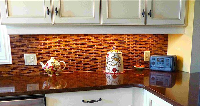

I discovered that this lightweight battery is very handy around the house, powering lights, small appliances in the kitchen, in my workshop handling some of my wood working equipment, as well as my entertainment system if need be, or if I just want to power these items free with solar power, it does all that.
Pik 7 kitchen
I tested the power consumption, calculated run times, and discovered this battery will operate the electric carving knife, grind my morning coffee beans, utilize the big stand mixer to make a cake, and use the blender to make a milkshake for the Grand-Kids (me too).
Take it camping or up to the off grid cottage to power lights, my 800W electric kettle (no problem when utilizing the (Power Lifting Mode) or other small resistive devices like hairdryers electric blankets.

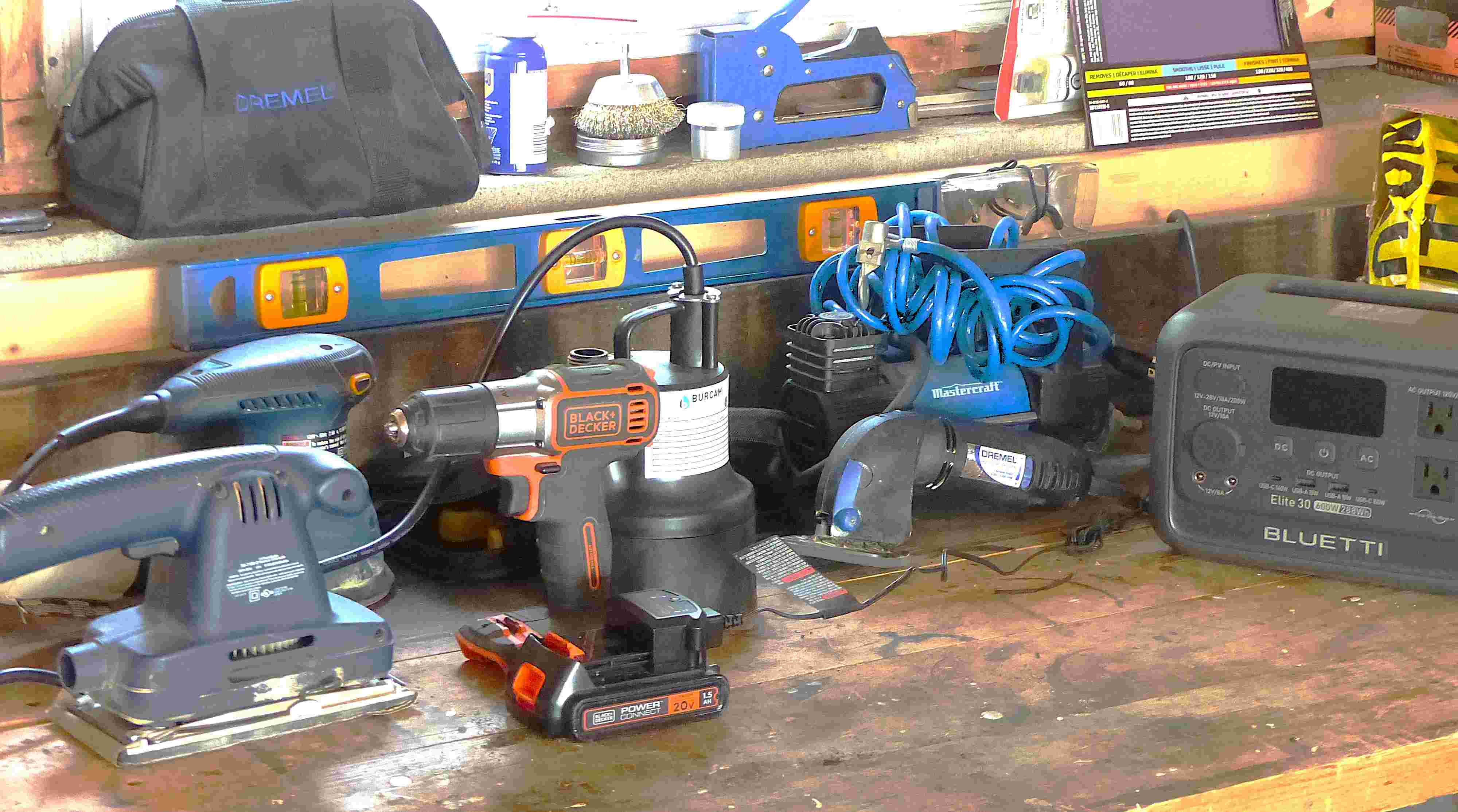

In my workshop, I found it to be helpful powering some of my woodworking tools:
Pik 8 wood working
It powered my Orbital Sander, my Detail Sander, Sheet Finishing Sander, Emergency Water Pump, Tire Inflater.
For some of my bigger tools like my electric lawnmower, it can recharge the 40V4Ah batteries, so I can easily cut my lawn…

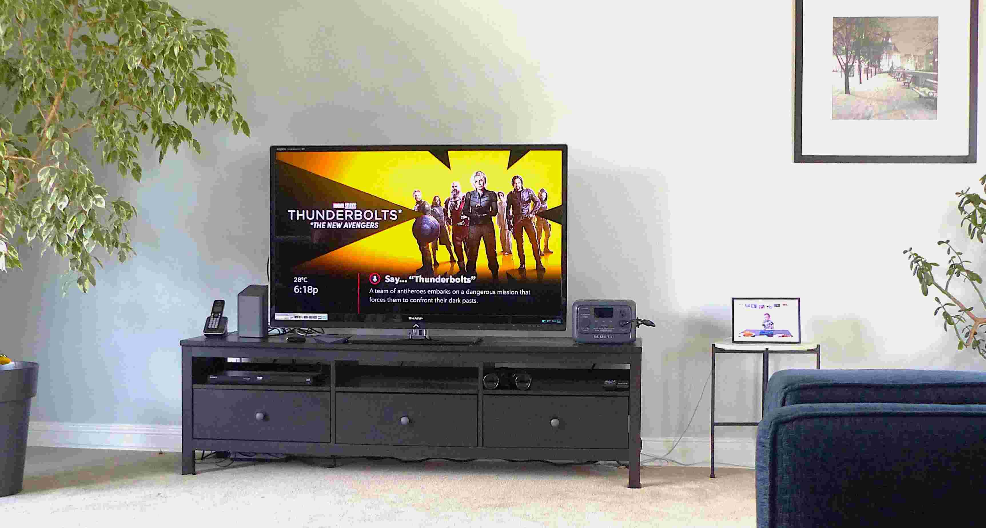

Next: My Entertainment Centre:
Pik 9 Tv
This consists of 52” Sharp 3D TV, TV Set-Top Box, Modem, Video Picture Frame, Roku Device Phone-base, Blue-Ray with the little ELITE 30 sitting right beside everything powering it all.
Total equipment power uses 160W Approx when everything is on.

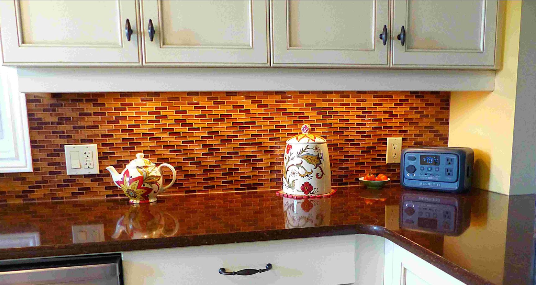

This battery is very practical for us, and I’m keeping the ELITE 30 on our kitchen counter. I charge it via solar or overnight to utilize lower hydro rates. So it’s ready the next time we want to use any of our appliances
