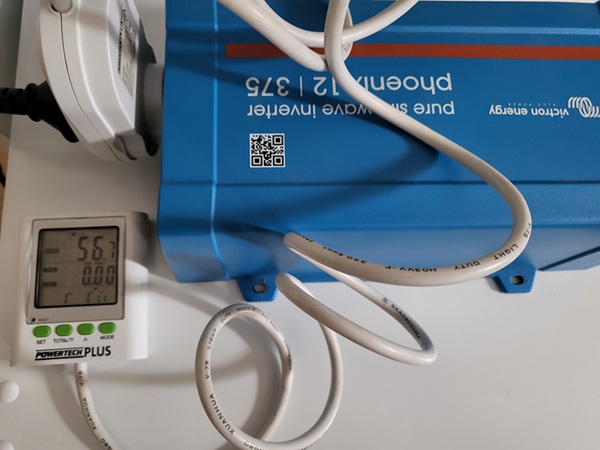

On to this mornings test, I connected the Victron 375W inverter to a spare fully charged 100Ah LFP. The Fridge was then connected to the inverter with a power meter. It WORKED perfectly at between 55-60W draw. (When the compressor started it was 60W and stabilised at 55-56W).
When trying to run from any of my Bluetti’s, the compressor made clicking noises and the power meter wattage shot up to around double what it draws from grid power, then zero and repeated this for around 30 seconds, at which point I cut power to prevent damage to the fridge.
So, my question is this - If the fridge works seemlessly from the grid at 240-242VAC at around the 60W power draw and works seemlessly from a Victron 375W Inverter at a similar power draw and at 230VAC, Why does it not work at 230VAC from a 1,000W, 1,800W or 2,000W Bluetti inverter?
Given that it works from a 375W inverter, Start up or in rush current is definitely not a factor.

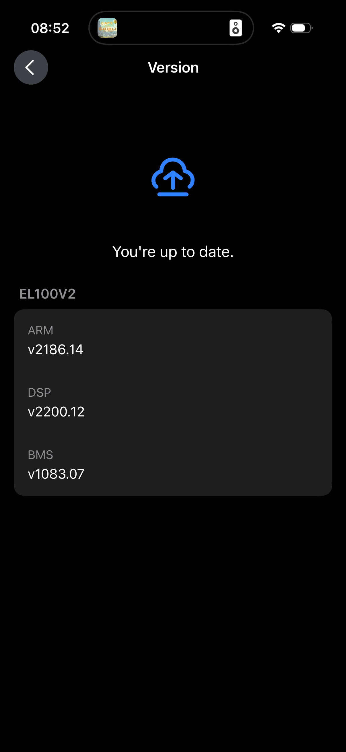

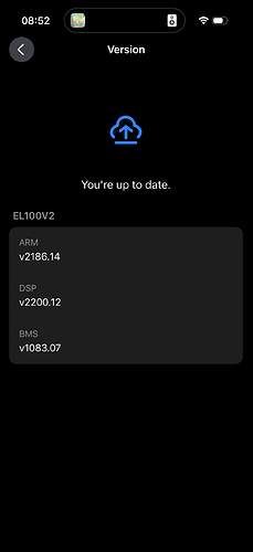

@snowstorm The same as you
IOT v8024.11
ARM v2186.14
DSP v2200.12
BMS v1083.07
And yes, my 2 x AC70, 3 x AC180 and Charger 1 are all up to date as well. However that update is recent, so standby I’ll recheck the Husky using the Elite 100v2…

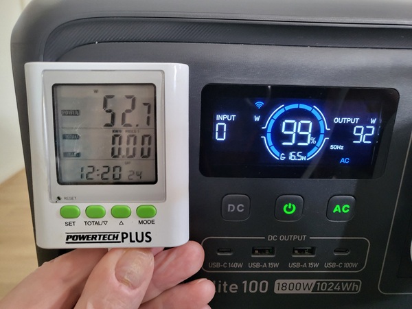

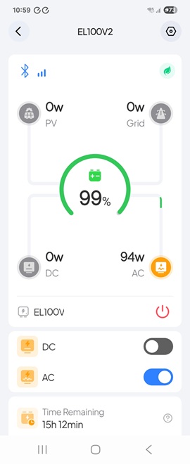

Oki, 10 minutes later, lol - I rechecked the Elite 100 operating the Husky, Lo & Behold, it works. The compressor runs smothly, however, I have the same issue as you note.
HUSKY 2
As pictured, the App shows a 94W AC load, the Elite’s display shows a 92W AC load (close enough). However my external power meter shows the actual load the fridge is using is 52.7W, that’s a 39W difference.
@BLUETTI_CARE So, I’ll tag this to Bluetti; Given the fridge is using 53W and the Elite 100’s display is showing 92W being provided, does this mean that almost 75% more power is being provided to run this fridge? Or, a more pertinent Q is, When calculating run time, should I use the Elite’s displayed W rather than the actual power consumed?

I wonder if the E100V2’s display which reads high is showing VA including reactive power while the external watt meter is measuring real power only. Fridge compressors are highly inductive and that may cause the difference.

Hi @Mandp, Regarding this question, please note that the AC70, AC180 and Elite 100 V2’s LED screen displays apparent power, which includes active power and reactive power. Therefore, the value displayed will be higher than that recorded by your electricity meter. This is normal.
The instantaneous power of a refrigerator’s compressor during startup can be several times higher than its rated power. This can cause the AC70 and AC180 to be unable to handle the load of this refrigerator. Currently, we do not have firmware that can increase the output power.

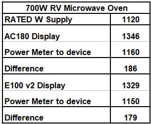

Some More Testing - I recently purchased a 2,000W Induction Cooktop for my RV and whilst testing it, decided to compare the AC180 & the Elite 100 v2 running it and the RV 700W microwave oven.
As the microwave is the easier, it’s first, here are the results.
MICROWAVE
Of note, the actual load W is reasonable close to the rated W measured on the power meter. The provided power from both the AC180 & Elite 100 were also similar to each other, but approx 15% higher than that used. This is to be expected, give Bluetti’s comments above.

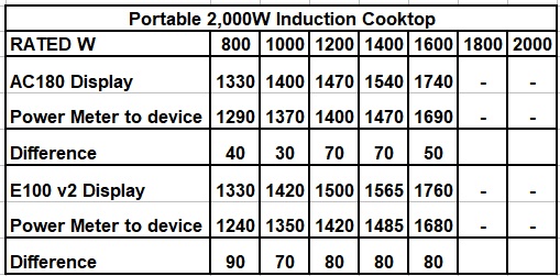

After scrolling through the various settings, the induction cooktop can be adjusted from 300W, 500W, 800W and then in 200W increments to 2,000W. I noted via the power meter, that when set to 300 & 500W the induction did the stop start to average that power, so did not include that data. I also found during testing, that at 1,800W & 2,000W, the load exceeded the 1,800W limit of the Elite 100 & AC180. Therefore also no data.
Here are the results -
INDUCTION
Of note, the loads measured, either each Power Station’s display or the Power Meter were similar for both units. Also, the difference between display & power meter was noted, but a lower % than when using the microwave.
