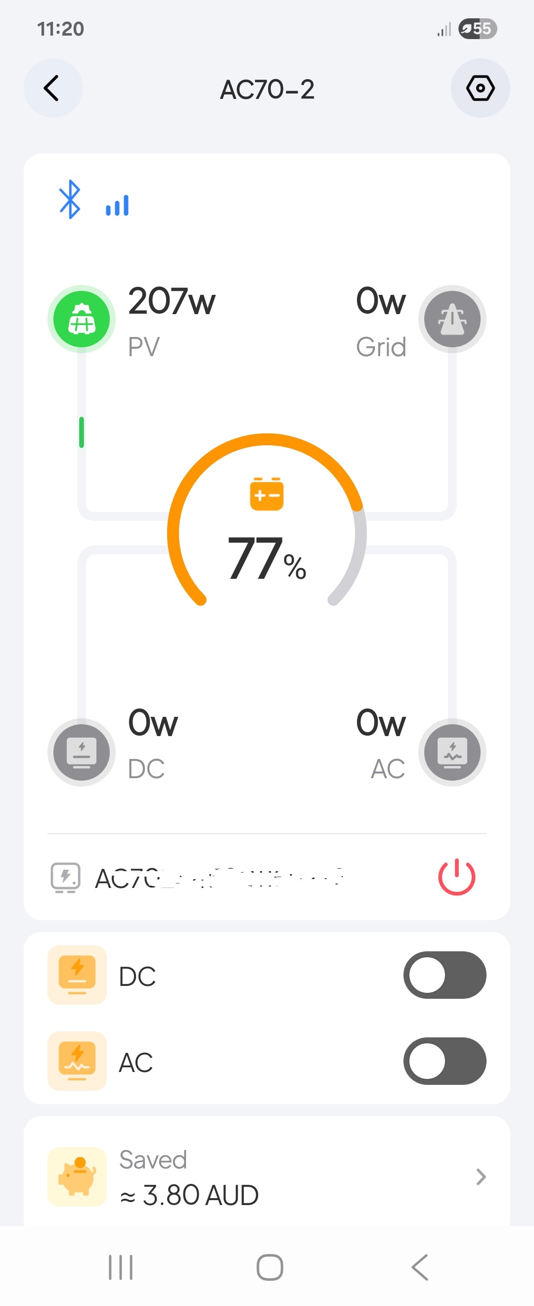

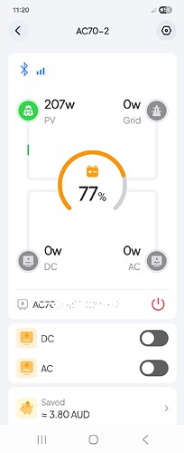

This is a screenshot of the AC70 via the App being charged from the Charger 1 set to 25VDC.
The actual wattage eventually stabilised at 215W

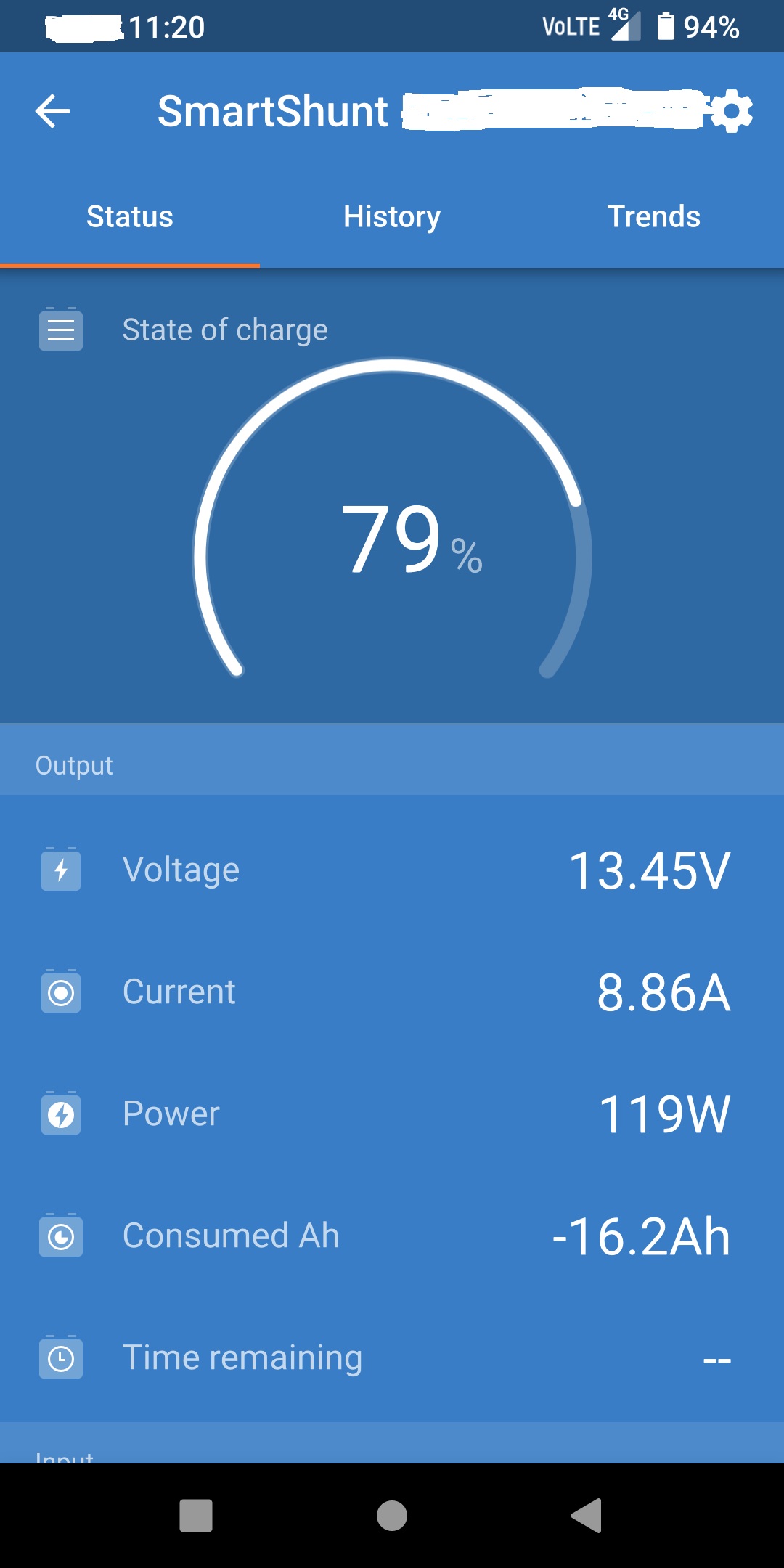

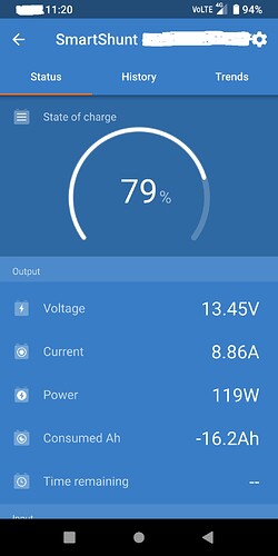

The Charger 1 was connected to my Aux 4x4 battery - 75Ah LFP. During the below screenshot the Engel fridge was not cyling.
I also have a 110W solar panel on the 4x4 roof, that was outputing around 5A. The Aux battery has an inbuilt 20Amp DC-DC charger, so the net charge of 8.86A meant that the Charger 1 was using approx 16A of the total 25A input. I drove until the AC70 SOC was at 100%, then returned to camp. During the return trip, the full 20-25A went to the Aux battery and both it and the AC70 were at 100% on return.
My aim was to Charge the AC70, without lowering the Aux battery’s SOC. Whilst at the same time, not overloading the alternator.
