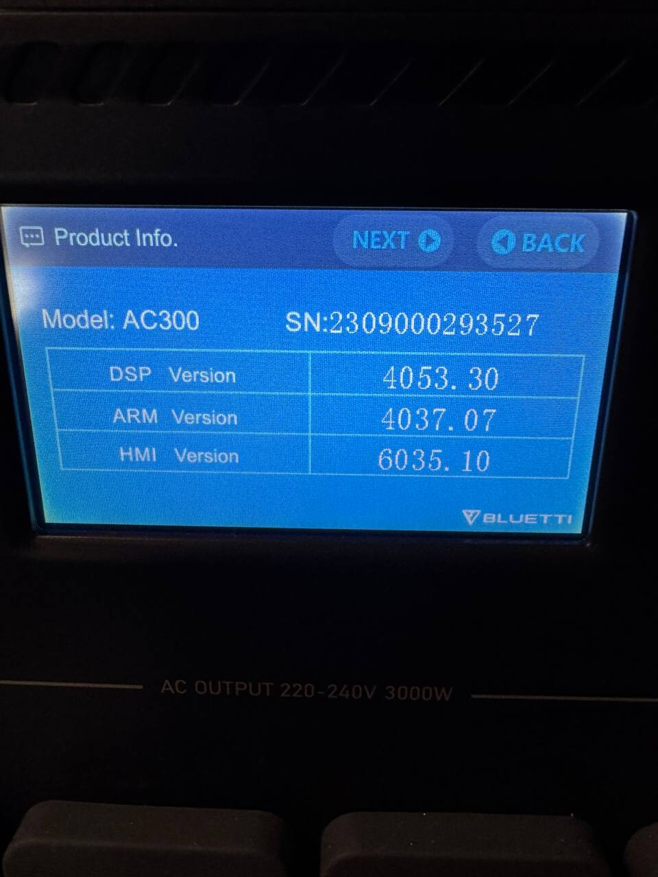

Hello @BLUETTI_CARE
My AC300 currently has ARM v4037.07
Please push firmware ARM v4037.70 with System Switch Recovery / output restore feature.
SN: 2309000293527
Hi @Chika, thank you for contacting us.
