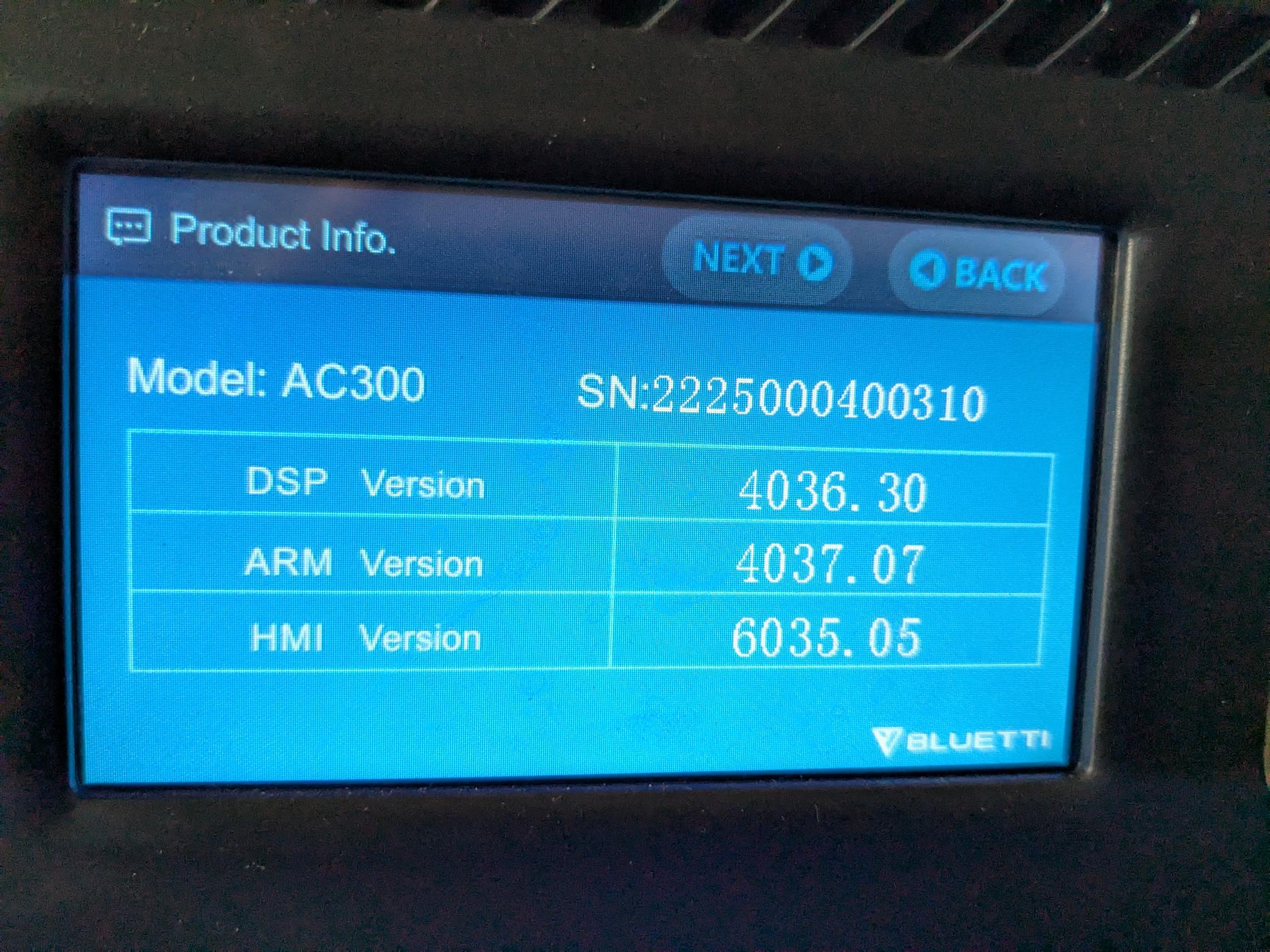

AC300 2225000400310

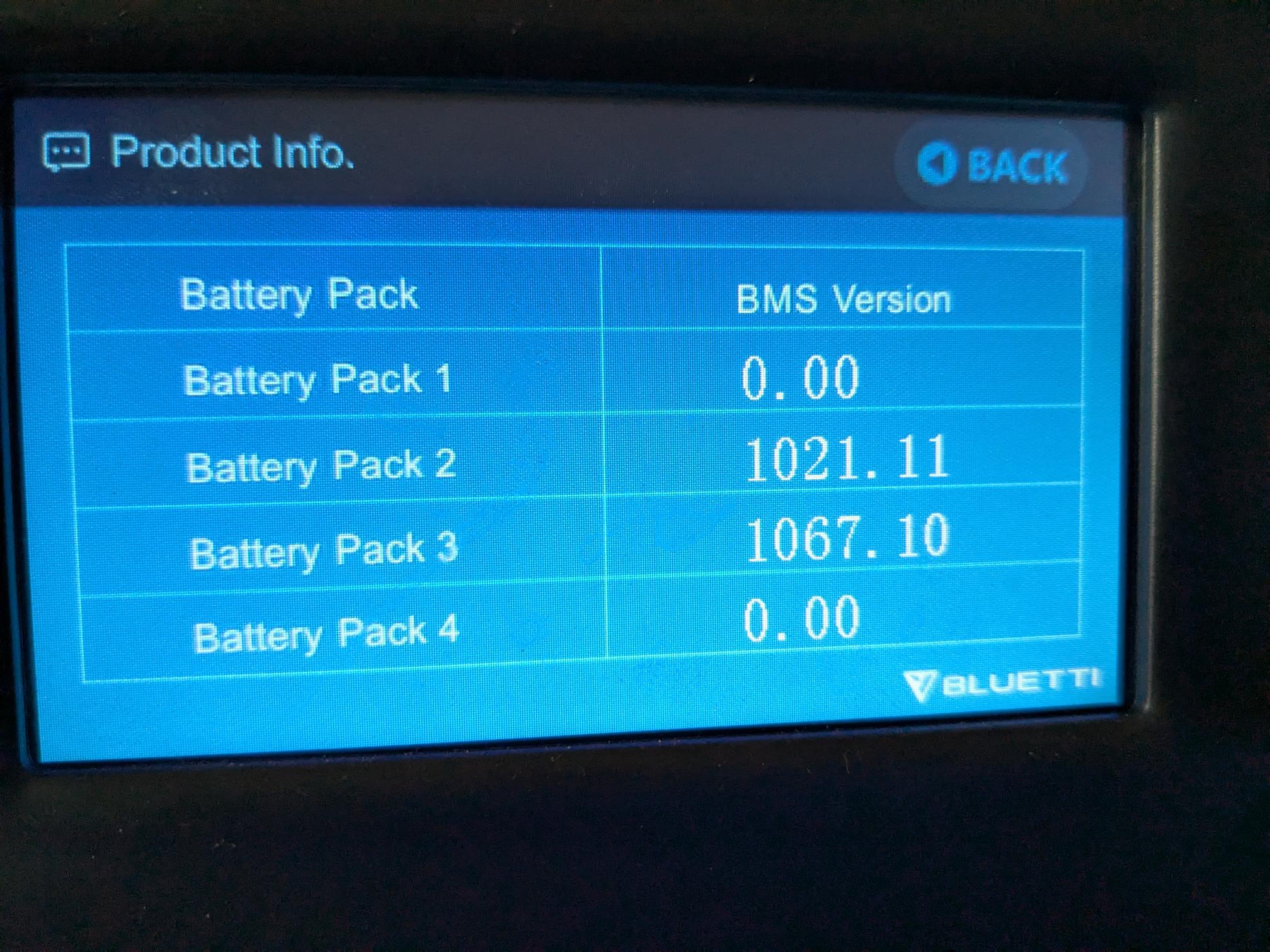

My Battery packs. Are these both compatible with new addons like the DC Hub with the current software?
B300 1021.11
B300K 1067.10

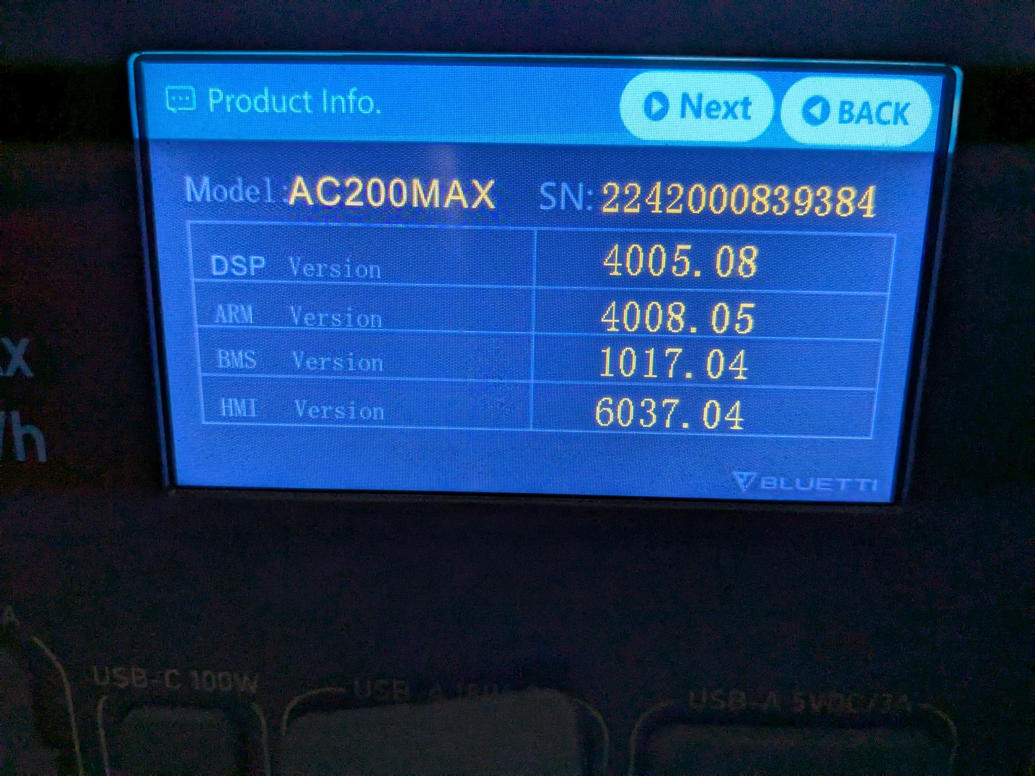

Also included AC200MAX in case there is an update for that as well
AC200MAX 2242000839384
Hi @Sideeffect, Only the AC300 has this firmware, and we have applied to push it for you.
They will push the latest version of firmware to your unit in 24 hours.
The AC200MAX does not support this function, I am afraid we cannot push it for you.

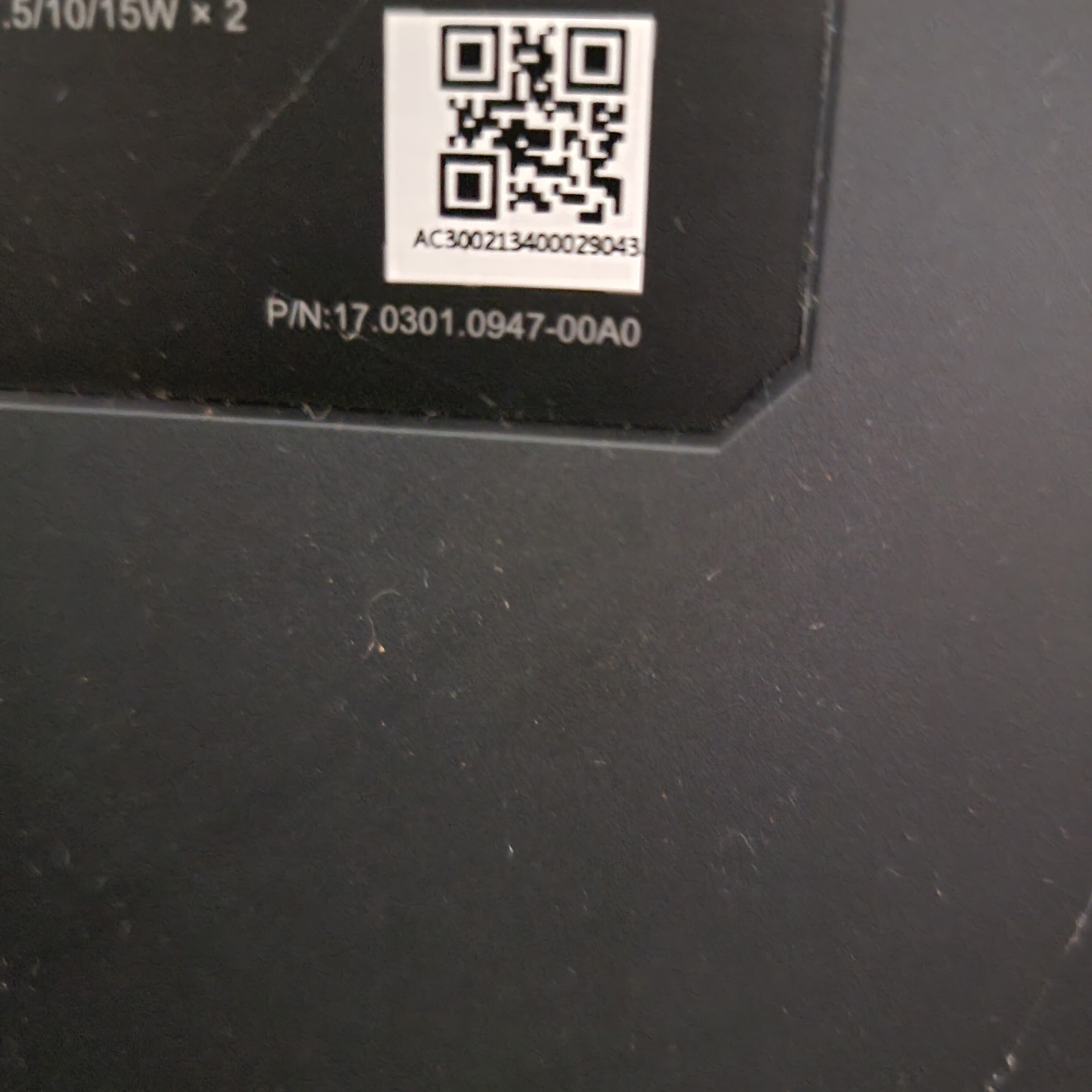

My mother in law’s unit serial number is
AC3002134000290438
When I took the picture, the AC300 was powered off, so I cannot post the actual firmware versions, but I updated it in January.
Hi @Raymondjram, We have consulted the technical department on this matter, and they informed us that not all batches of AC300 can achieve this function through firmware pushing. After inquiry, this AC300 cannot be upgraded.
