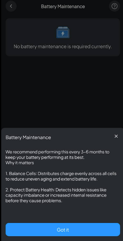

Active calibration has indeed been implemented in our new product line. The Elite 400, for instance, is a great showcase of this new technology.
The Elite 400 will determine whether to activate the Battery Maintenance Feature based on the user’s regular charging and discharging habits.
This feature is triggered under the following circumstances, and the app will guide users through each step with real-time notifications:
Triggering conditions.
The first trigger conditions:
When the number of incomplete charge-discharge cycles(95% of rated capacity) exceeds 100 times.
Subsequent triggering conditions:
  1. After 6 months of use or more than 200 incomplete charge-discharge cycles, and with a SOC of less than 50%.
  2. Every 7 months.
During the recalibration process, users must connect the Elite 400 to both the grid and a suitable load. The system will automatically turn off the output during charging to ensure calibration accuracy.
