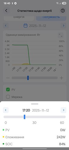

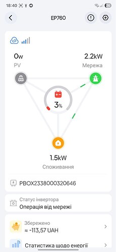

Today, I installed solar panels and connected them to the EP760. Everything was going perfectly, and the station recognized the voltage input on PV1.
However, approximately 6 hours later (about 2 hours after sunset), the mobile app displayed a low battery notification of 2%.

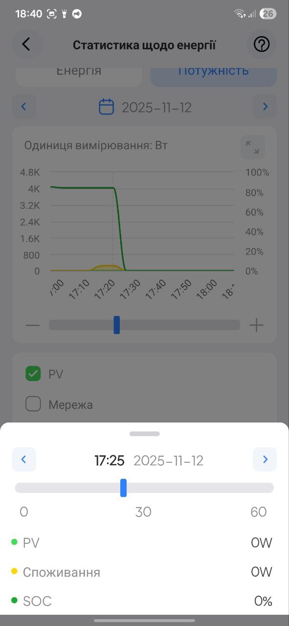

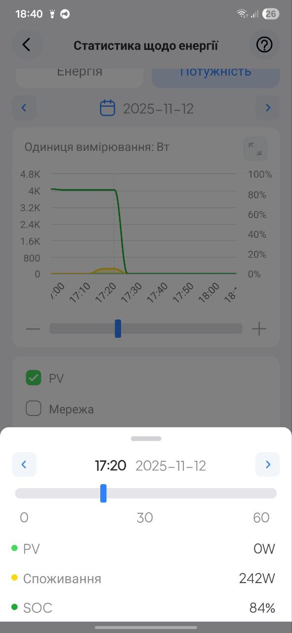

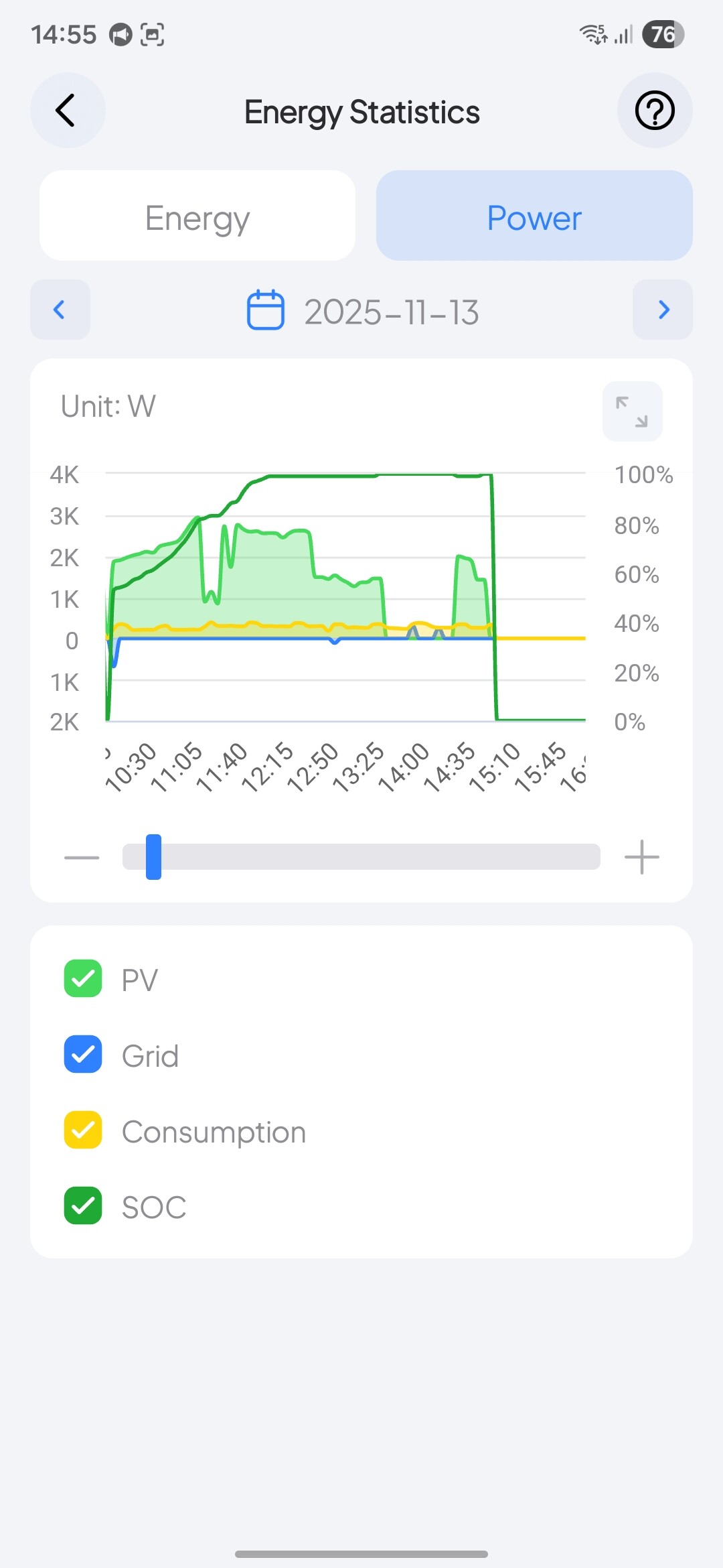

On the graph, it is visible that at 17:20 (5:20 PM) the charge level was 84%, and by 17:25 (5:25 PM) it was 0%.
After a complete reboot of the station, nothing changed; it proceeded to charge starting from 2%.

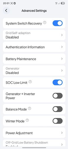

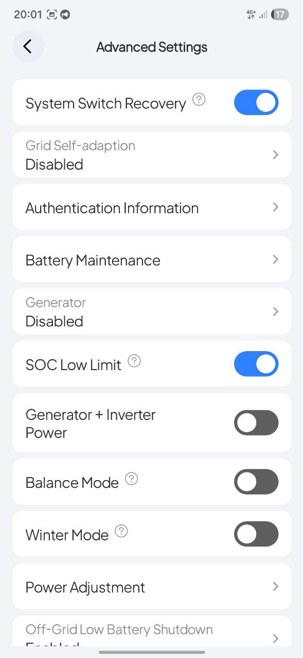

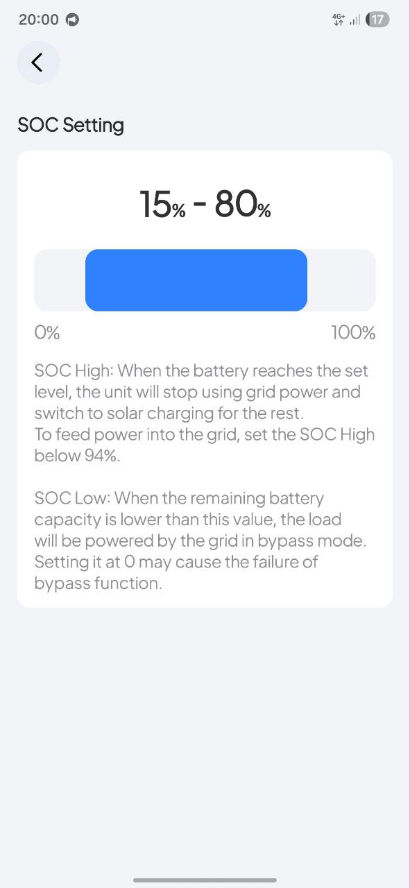

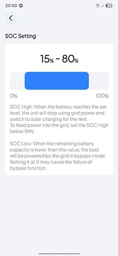

My maximum consumption was up to 3 kW, but the settings in the app are configured to stop discharging the battery at a minimum of 15%.
​All systems were updated to the latest versions two weeks ago during the installation. I am constantly checking for updates.

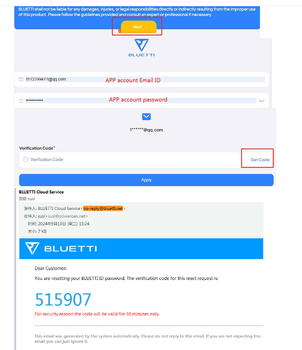

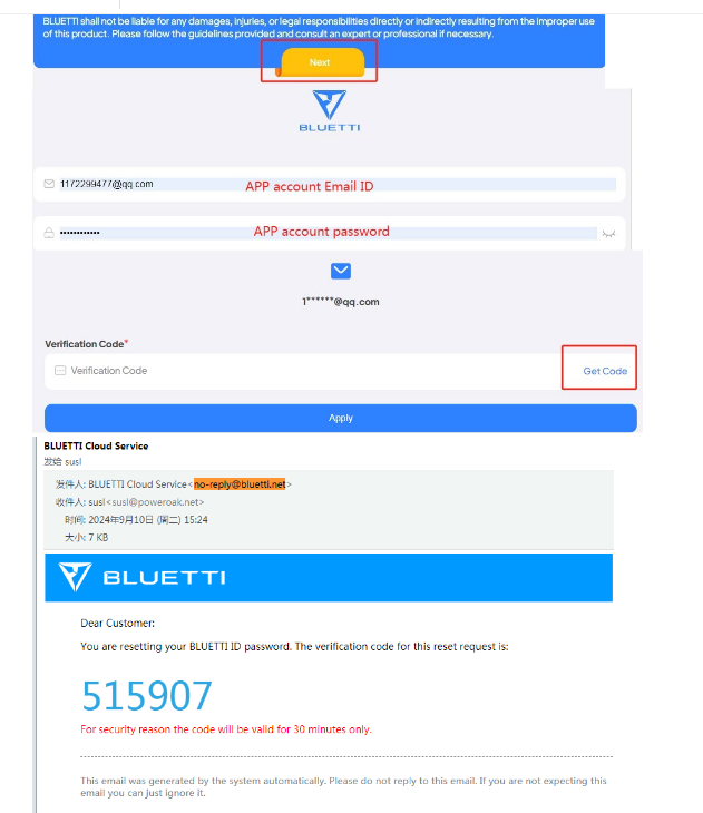

How to enable Pro-mode?
Please get pro mode access as installer in link below
https://h5.bluettipower.com/app/apply-vip/index.html
(2)We will approve your request after receiving it on our system,
please wait patiently. Then you will see Pro mode after login APP.
One more question:

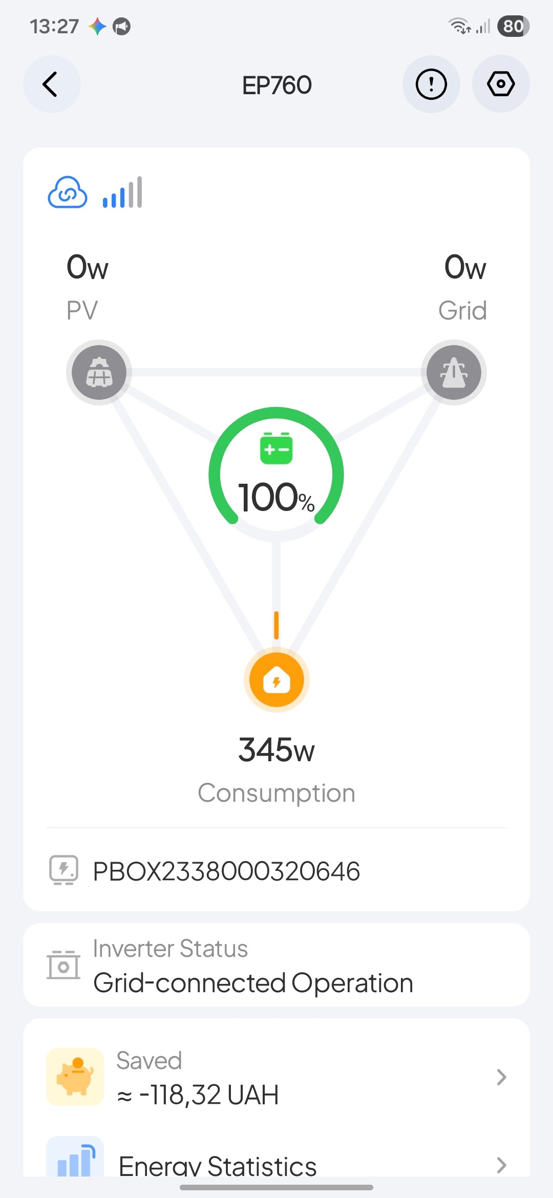

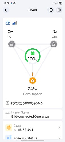

​Currently, the solar panels have charged the battery to 100%, and the house’s power has switched to running on the battery.
​I would like to preserve the charged battery until sunset, and during this time, power the house directly from the solar panels. Is it possible to change this somehow?
​Because with the current setup, by the time the sun sets, I will be left with a discharged battery for the night.

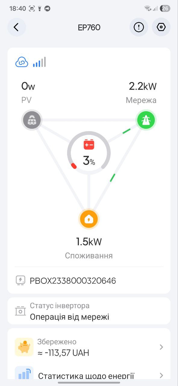

Now I have this situation: Consumption is occurring, but the battery charge level is not dropping

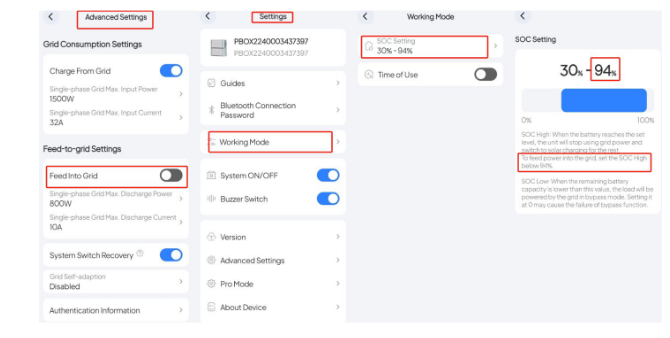

Hello,
(1) Solar will auto stop when battery charge to 100% for battery
safe,solar will continue production when battery discharge under
100%.
(2) Enable “Feed into grid” and set SOC High under 94% in
advanced setting,then solar will continue production and feed
into grid when battery soc excess SOC High.
