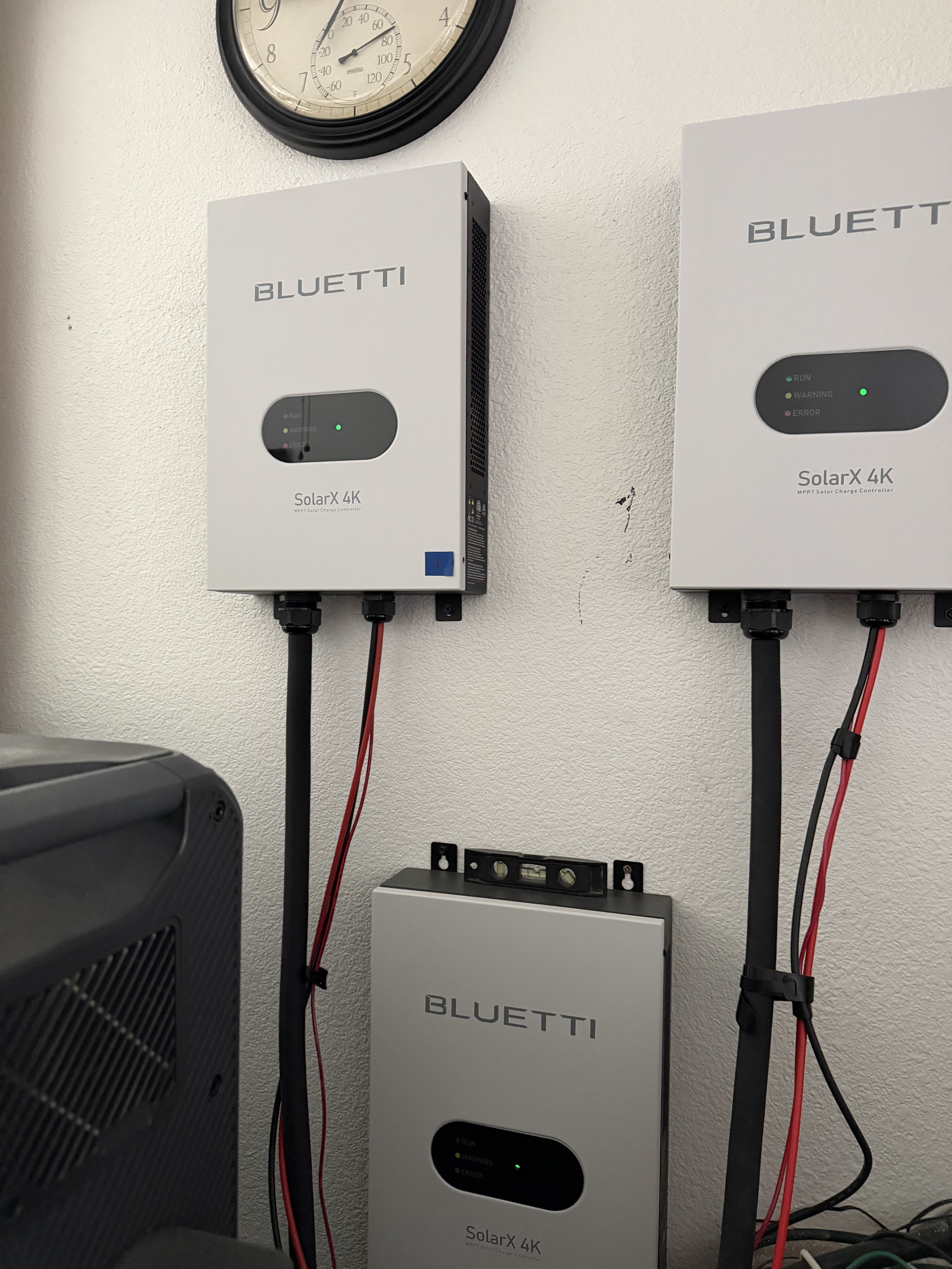

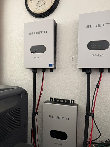

I have three of the solar X units running into three Apex 300s with B 300 K batteries.
This happens almost every day with one of my units. Very random seems to only happen when the batteries are topped off to 100%.

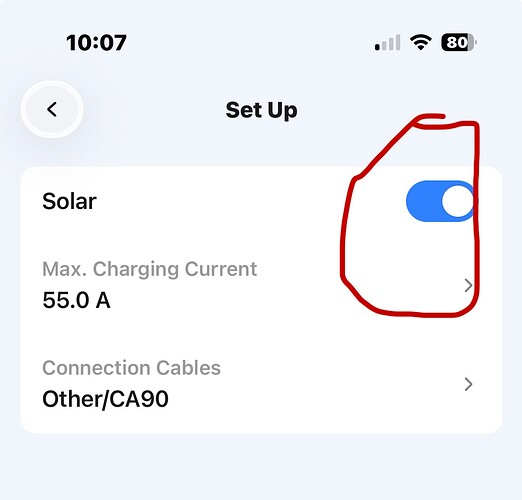

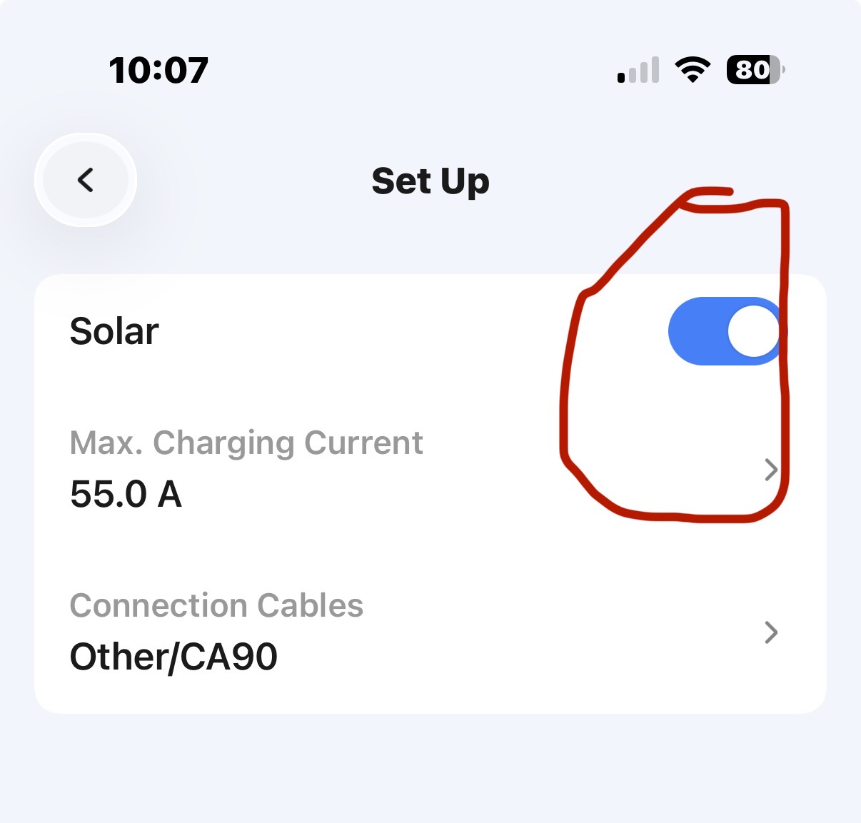

Toggling this button on and off seems to help and it resets the units…
