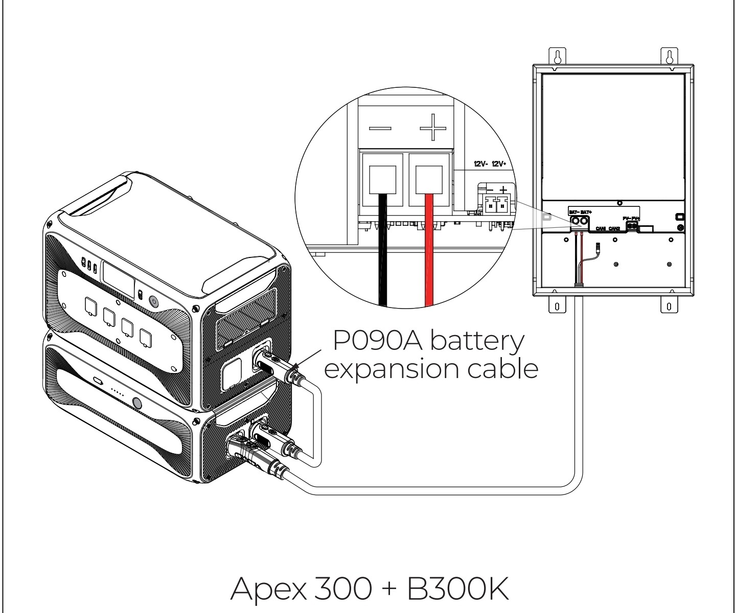

You probably mean the P090A connection cable.
This isn’t connected to the AC500, but to the B300K.
