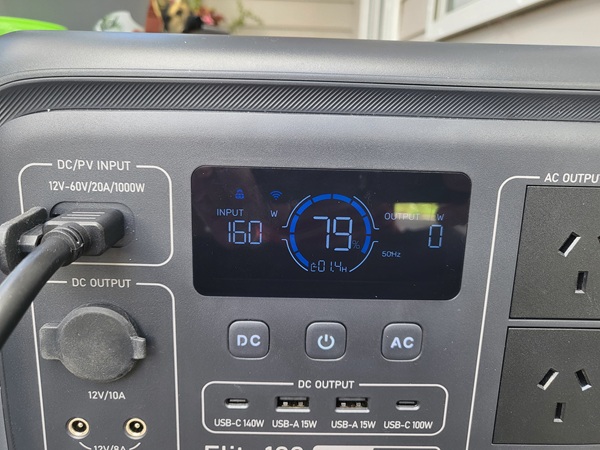

Parallel connection result;
PARALLEL
Maximum observed parallel input to the Elite 100 v2 was 160W.

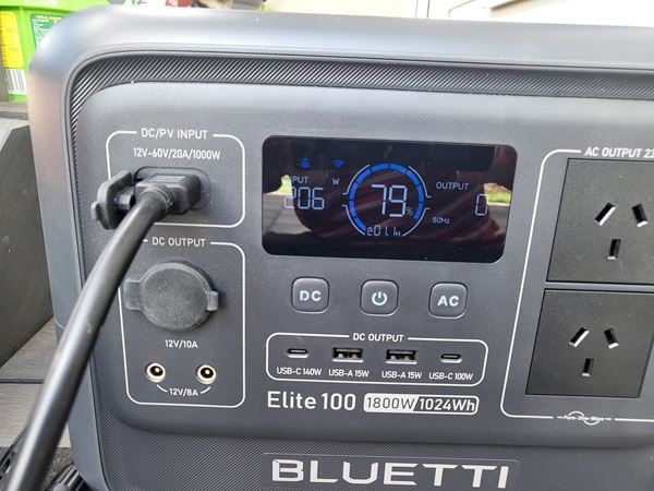

Series connection result;
SERIES
Maximum observed series input to the Elite 100 v2 was 206W.

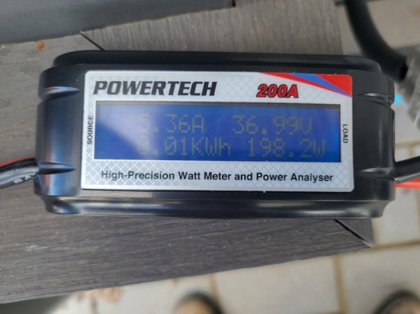

3. DC power meter.
POWER METER

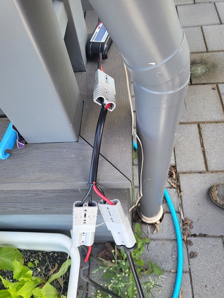

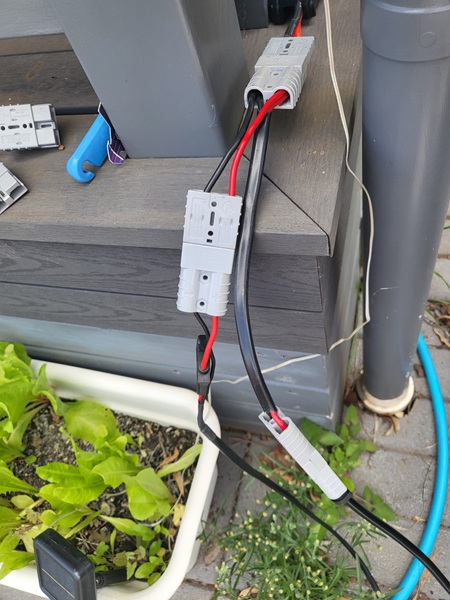

5. Two Anderson doubler cables, one wired in parallel, the other in series.
Parallel
Series

When connected in series, the output voltage is approx 37VDC and above the voltage required for full amperage input. As the output amps are half that of parallel connection, there will be less voltage drop. The noted 206W output is 86% of the rated maximum and nearly 30% better than parallel connection.
