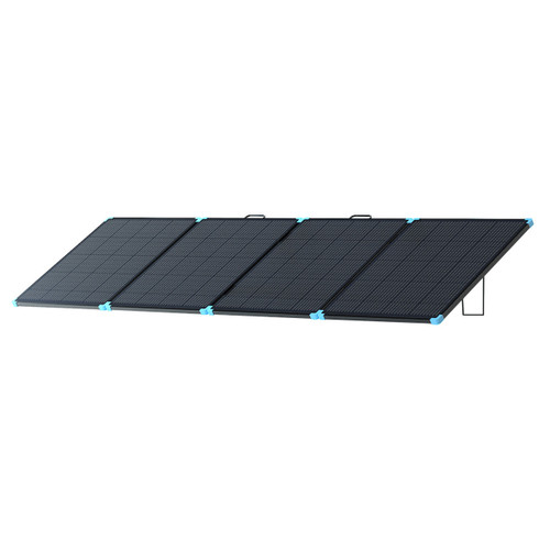

I saw the 400W Renogy portable solar panel fits quite nice with 47.2V 10A. Later on, you can add another one and put it in parallel and get 47.2V 20A for 800W.
Got a link? I am interested.
It’s this one:
