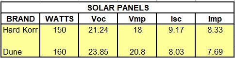

Here are the panel statistics; (Note - These are brands available in Australia, however, the logic is world wide.)
PANEL STATS

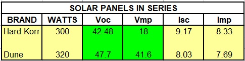

PANEL STATS IN SERIES

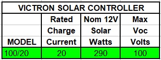

Victron Stats.
VICTRON
Of note above is the significantly higher Voc and Vmp of the Dune panels. At the time of taking the picture, I opened the Victron Connect App to monitor input to the caravan’s 2 x 100Ah LFP batteries. There is also a Victron Smart Shunt in the system, it and the 2 x 100/20 Solar Controllers are set up in a V.E. network. Both MPPT controllers have the same settings. (At the time the default LFP Victron settings)

There is only a 20W difference in panel rated output or, the hardkorr panels are 6.25% less in rated yield. However, the Dune panels noted a 16.4% higher output relative to rated output. All 4 panels were in the same environment, angled to the sun and had been set up for some time.

One point to emphasise - A Victron controller needs battery voltage + 5V to work effectively. If charging LFP at around 13.8V in Bulk, this = a minimum 18.8V of solar input. Therefore the Hardkorr Vmp of 18V is not enough when using a single panel.
The Dune’s Vmp of 20.8 is high enough for single panel use. However, with the 100V limit of the Victron or indeed the higher 58 or 60V of a mid range power station such as the Elite 100 or 200, connecting 2 nominal 12V panels in Series is always a better option. Another is to use a nominal 24V panel with a Voc in the high 40V range.
Also of note - the Victron 100/20 has a maximum 290W panel input when charging a 12V battery array. The Dune is 30W higher (approx 10%) and overpanelled. The MPPT will absorb this and rarely in the real world will a panel achieve its rated output.
