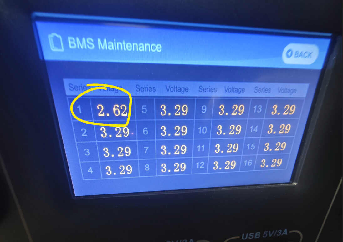

I had a AC200 sitting for about 6 months (charged to ~80% before disconnect) and now have extremely low output and a single cell with very low voltage:
I’ve charged three times to 100% and then discharged with a 200W load. State of Charge drops from 60% to 0% in an instant, the unit shuts off and cell 1 reports ~2.6V when you restart.
When initially turning the unit on it was barely able to display the menu for 2-3 seconds, then shut off again. After numerous tries the AC charger started charging. The lowest i’ve seen the cell was at 2.1V :frowning:
Is there a way to revive the cell?
There is an internal XT90 connector with ~54V that seems to connect “directly” to the Battery or BMS - is it viable to charge there with a dedicated charger set to let’s say 54.1V at around 1 Amps
Is there any kind of balancer in those units? I wonder why the low voltage cell does not aligns its voltage over time with the rest of the cells. The unit has been sitting for an hour, other cells at 3.29V, cell 1 still at 2.62V

Cell voltage of the affected cell remains a bit lower though and after a short amount of usage the unit powers off due to undervoltage warning for this cell.
What can I do?

Going into the cell voltage screen I saw cell 1 at 0.81V, rising fast.
@BLUETTI_CARE
I retired the unit last summer with 80% SOC - other cells were at 3.10-3.15V when I restarted the unit.
How would I go exactly about the recalibration? Right now it seems the unit shuts off as soon as cell 1 reaches ~ 2.6V while all the others are still at 3.25-.3.29V

The unit shuts off AC Output after ~ 15 minutes of 1000W draw but stays on. SOC is being reported at 0% while cell voltages look like this:
As you can see all cells beside call 1 seem to have plenty of charge left (at least going by their voltage ~70%) while cell 1 made the BMS to shut off the output due to low cell voltage.
I tried charging with DC input by Solar (60V VOC) and the unit seemingly charges back to 100% (like with the AC charger) but cell voltage of cell 1 does not reach more then 3.2V while the other cells reach 3.39V.
Then the situation is the same like before: a short discharge brings Cell no 1 down to ~2.6V and the unit shuts cuts power.

I think we misunderstand each other. The Display suggests that charging is happening and displays a 100% SOC - but charging itself is done in about ~30 minutes. Discharging from 100 to 0% as well.
Cell 1 does not fully charge and is discharged within minutes. then drops from 2.6V to 1.xx within days.
