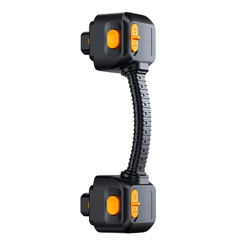

@Austin814 something like this??
This cable is only compatible between either an Apex 300 and a B300K battery or between a B300K battery and another B300K battery.
If you have something like an AC200L, AC300 or AC500 with 2x B300K batteries then this cable can be used between the two batteries assuming they are stacked, but it can’t be used between a battery and the head unit because the AC200L, AC300, and AC500 have the battery ports in a different place as compared to where it is on Apex 300.
The cable does not line up with the connectors on any other devices, so you can’t use it with a B300, B300S, B230, or B210 battery.
And unfortunately it currently looks out of stock here in US but they’ll be more coming soon!! :metal:

Yes something LIKE that, but one that fits the AC300/500 and B300 / B300S. There is no need to have long cables when the units are meant to stack vertically.

I see that this special shorter expansion cable has the flat side of the connectors tilted 90 degrees since the B300K expansion ports are also tilted, unlike the AC300, AC500, B300, and B300S which have the flat side vertical toward the top with tbe slide lock. I also see that the CA90 slide lock is also sideways. But I expect Bluetti to design and built new P090A and P150A cables with a right angle connector in the near future.
Edit: If the B300 or B300S batteres are placed side to side, not stacked, then this CA90 cable might work.
