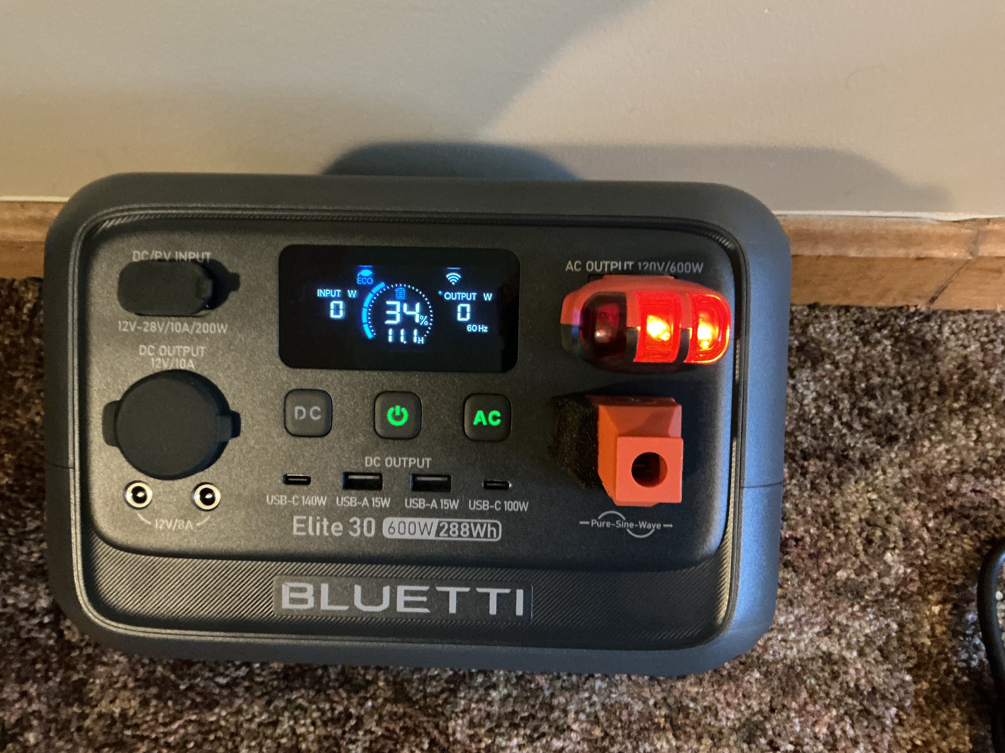

I can’t speak for the Elite 300 or any other power station, but the following photos demonstrate my Elite 30 running with and without a bonding plug. I’ve inserted an outlet tester to provide a visual.
First photo connected to the grid and no bonding plug!!
Never put bonding plug if connected to the grid!!
Tester displays bonded neutral ground.

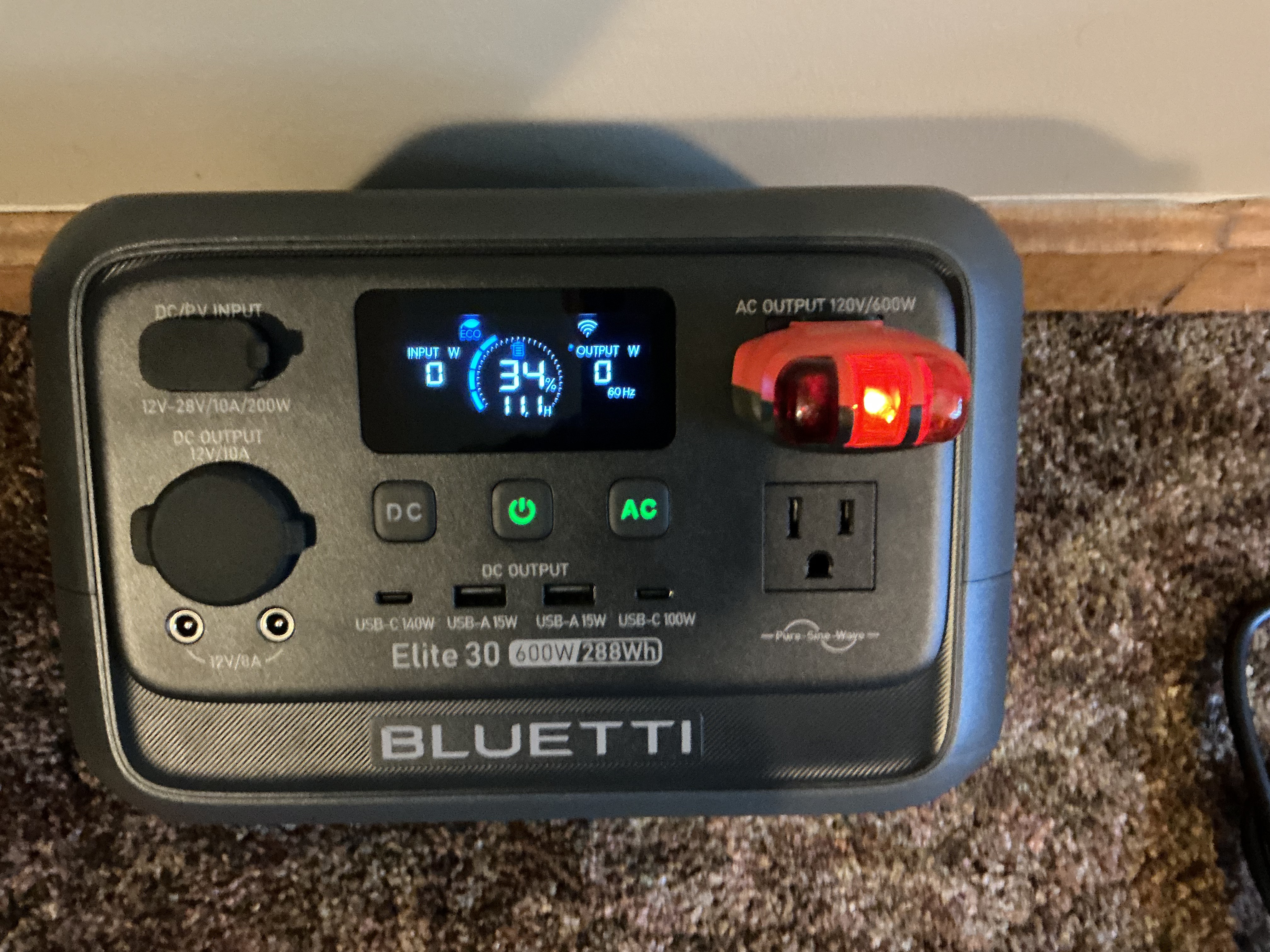

Second photo no grid and no bonding plug.
Tester shows open ground condition.

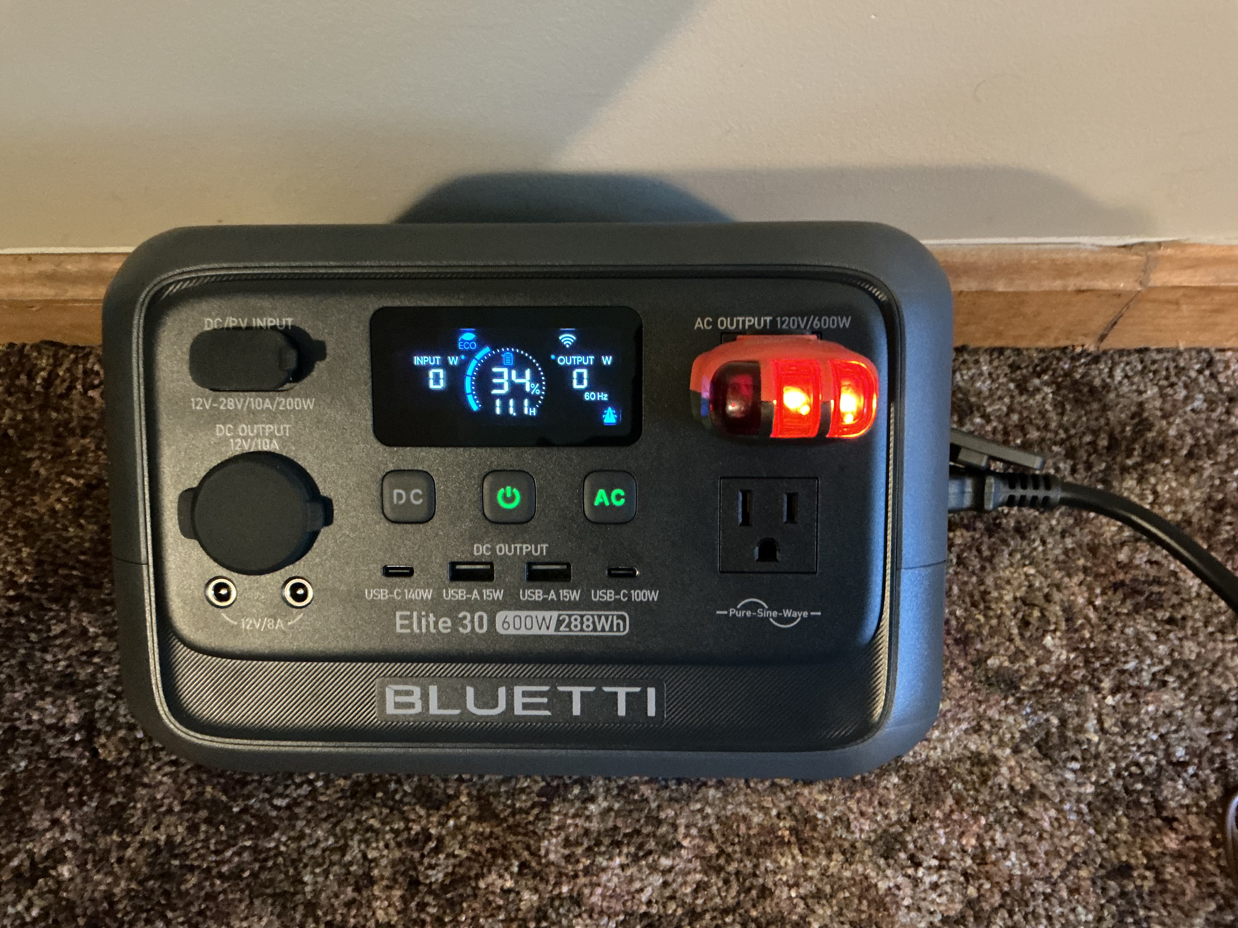

Third photo no grid, with bonding plug.
Outlet tester displays neutral ground bond.
