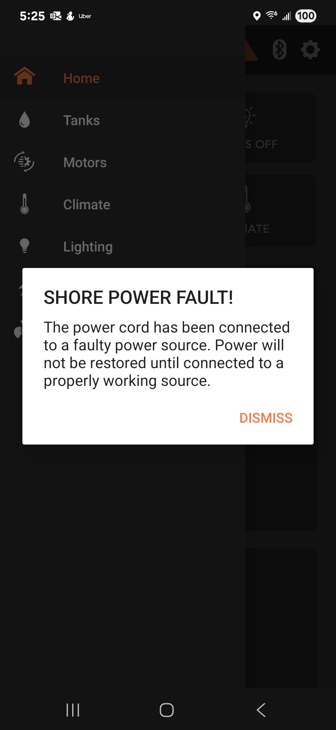

Hello I have a 20204 Thor Tranquility 19P motorcoach on a 2023 MB Sprinter 2500 chasis. I bought the Bluetti AC 200L thinking that I could connect its 30amp AC outlet directly into my camper’s 30amp shore power inlet. I see that power is going into my camper because the shore power light is “blue/on.” But I get an error message inside my campers BMPro app “Shore Power Fault! The power cord has been connected to a faulty power source. Power will not be restored until connected to a properly working source.”

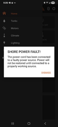

I am experiencing issues with my Bluetti AC200L unit. When I attempt to power my van using the 30-amp source, the in-house app that controls the van’s electronics (BMPro) reports a “Shore Power Fault.”
  • I have included pictures showing the connections and the battery interface, as well as a screenshot of the BMPro app error.
