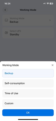

New Apex 300. Firmware updated. Trying to configure time intervals for UPS mode.
  1. Unable to select UPS for working mode;
  2. Expecting to find Time Control Mode on the Settings Menu (not within Settings);
  3. I’ve changed factory configuration only to turn on Bluetooth and WiFi;
  4. I’ve removed Bluetti app from my phone and reloaded the app;
  5. Settings:
    a. Guides
    b. Share Device (0)
    c. Default connection mode: Bluetooth
    d. No Bluetooth connection password set
    e. Carbon Emission Factor: 0.959
    f. Location set to home address
    g. Homepage display “on”
    h. Working mode: Backup (can’t switch to anything else)
    i. Extreme weather alert: Enabled
    j. Charging mode: Silent
    k. Power lifting: “off”
    l. AC-ECO: Power 10W; AC-ECO Shutdown 4h
    m. Screen timeout: Never
    n. Chile lock: disabled
    o. Firmware upgrade: complelted
    p. Advanced settings: factory settings
I need some help!
Thanks!

I wish to set up custom time intervals in the UPS mode.
The downloaded Bluetti app does not offer the expected Time Control Mode in the Settings Menu.
I wish to charge from the grid between 0000 and 0700, discharge between 0700 and 1000; charge from the grid between 1000 and 1700, discharge between 1700 and 2000, and finally charge from the grid between 2000 and 2359.
The listing above details the offerings in the Settings Menu. I cannot change the working mode from backup. Since the necessary Time Control Mode does not show in the Bluetti app I expect there is configuration setting I have missed.

Hello, you can switch to time-controlled UPS mode in the “working mode” section.
Back to the beginning!!!
The Bluetti app on my iPhone does not give any options to switch and does not offer the ability to set time intervals in the UPS mode.
I suspect it is a configuration issue . . . perhaps if I switched to Wi-Fi only comms with the Apex 300?
