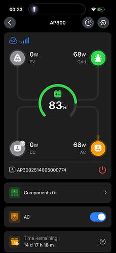

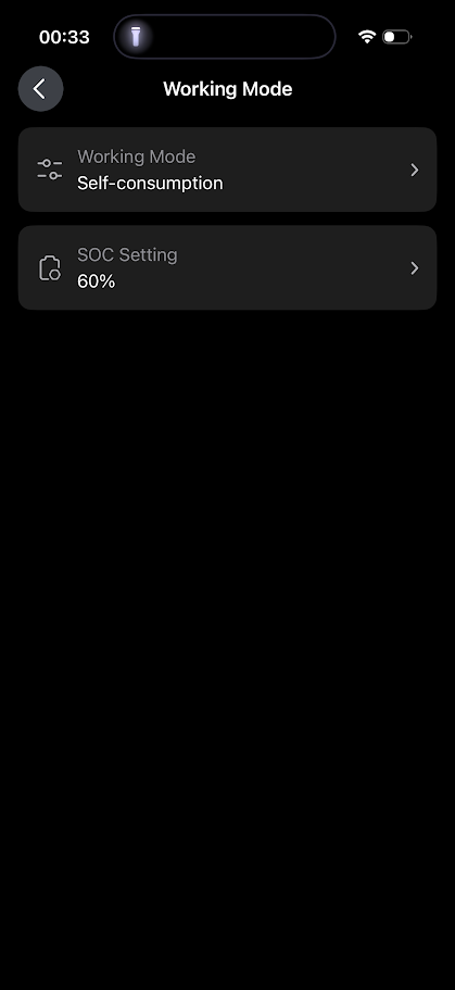

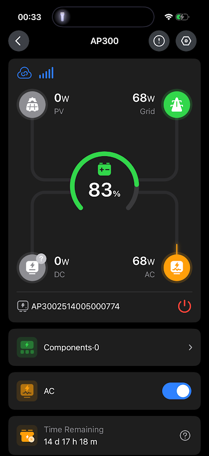

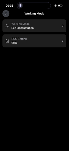

I noticed that when using “Self Consumption” working mode, the device would always use GRID to pass-through to power the AC even if the SOC is way above the set point. I observed that it would only use GRID to charge the battery unless the SOC is below the set point (PV can always charge), that is good. However, even when SOC is above set point (even if it is above by a lot, say target SOC is 50% and my SOC is 83%), it still pass the GRID input to AC output and not use the battery. This seems wrong, as I would want to “self-consume” the PV energy instead of using GRID to power AC out. I’ve read that there is a 10% buffer where it would continue to pass-through until SOC is 10% above setpoint, but in my case, my SOC is 83% and my setpoint is 50% and is still using GRID pass-through instead of battery. Why is that? ‎
I have 1 x B300k and 2 x B300 connected
My max grid input current is set to 7A, charging mode is Standard.
My AC load is small, only around 70W, does this matter?
IoT v8026.12
ARM v2204.11
DSP v2174.11
BMS v1073.07

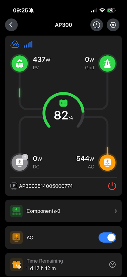

I was backing up my networking equipement at around 70w earlier, and it never switch away from grid pass-through. Just now, I plugged in a dehumifier and it drew total of 544 watts, and it switched away from gird pass-through to battery only. I wonder if there is a minimum wattage that is required to activate the inverter. Maybe if the load is small enough, Bluetti won’t switch to inverter as the inverter loss is greater than the load. I will do more experimentation today and see what’s going on.

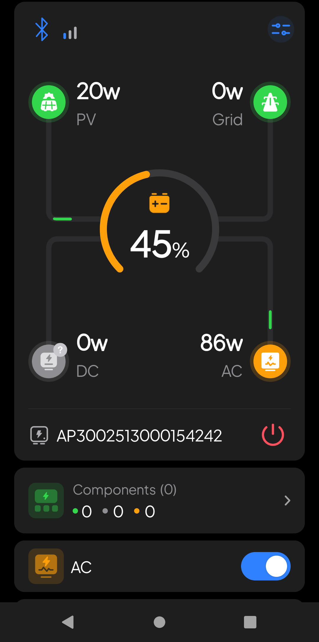

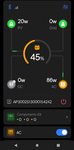

Snow go back to the pic that I posted, A picture is worth 1000 words and you can see that my load is 86W, self consumption is working correctly as I have the SOC set to 35% and I am not drawing any from the grid. Maybe you got a bad unit or a bad firmware revision or it is corrupted. I would put in a ticket with Bluetti.
