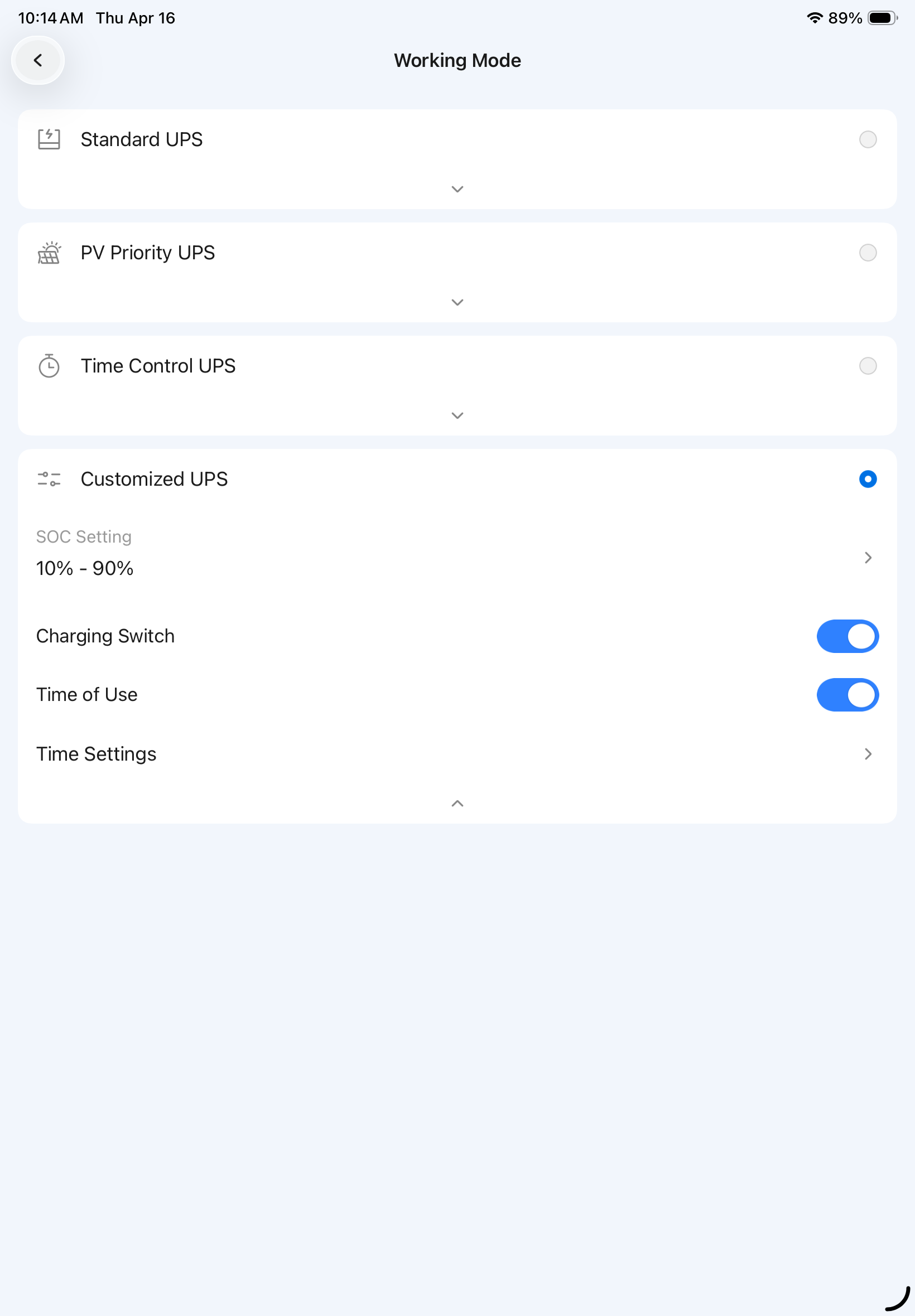

Since you have the Elite 30V2, I would advise you switch your UPS mode away from “Standard UPS”. This mode will always be on and consistently try to keep the battery at 100%. The problem with Lifepo4 batteries is they have a flat voltage curve and the BMS can “drift”, so if you are always at the top end of the SOC spectrum, you might eventually experience a loss of battery life due to this phenomenon. TLDR the BMS sucks at times. There is a mode called “Custom” where you can set an SOC range (say 20% to 90%). When the unit reaches 90% it will discharge until 20% then recharge to 90%. This effectively puts the BMS into training/learning mode all the time. To actually drain the battery you’ll want to subject it to a load, otherwise, no balancing/collaboration will occur. Preferably a constant AC load, like a fan or heater so the waveform is constant and the BMS can keep up easily.

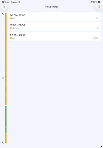

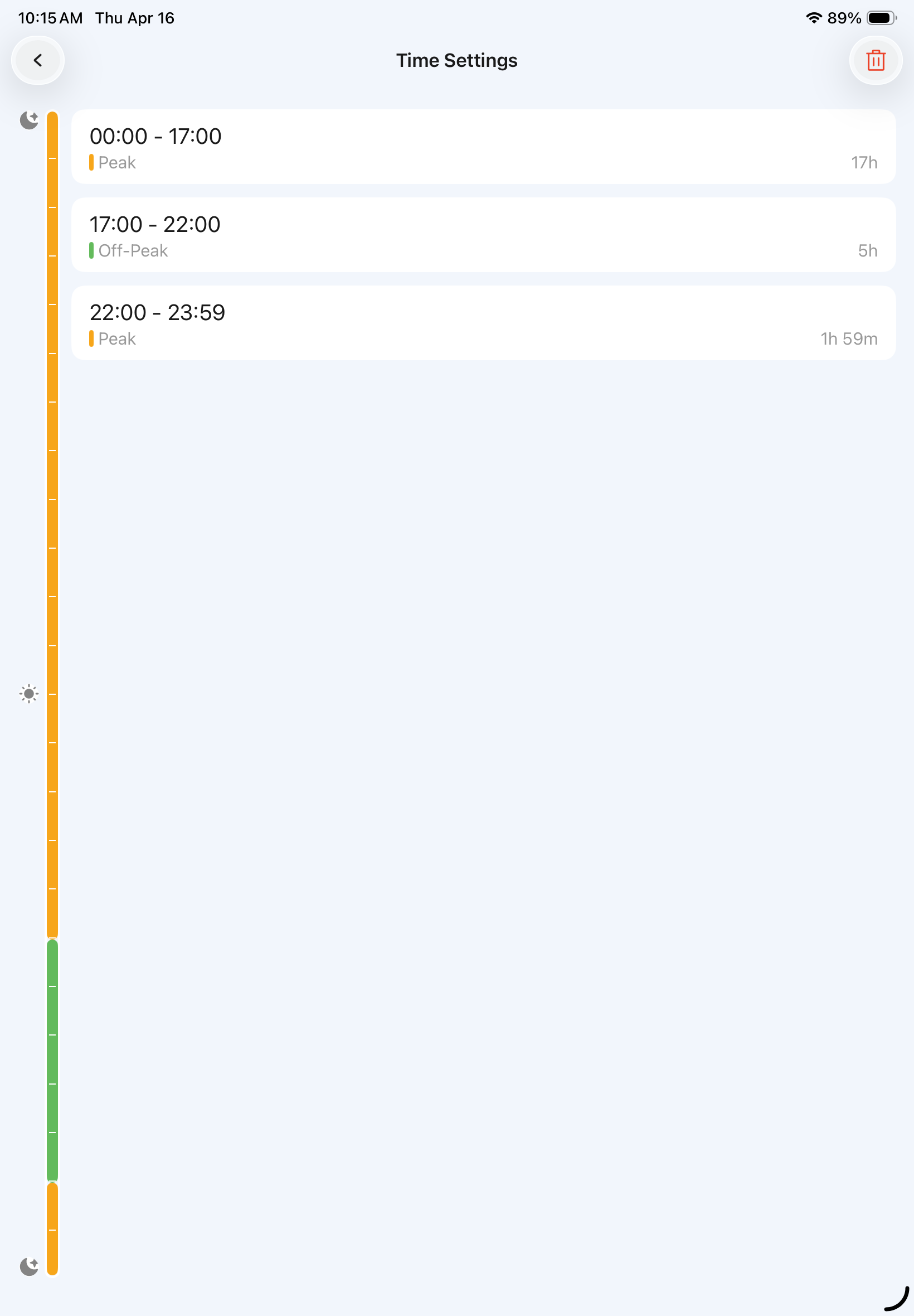

Hi, I have my Elite 30 setup similar to what @sealy1986 described with Time of Use toggle switch on. This gives the ability to specify a a time period when you allow the grid to charge your unit. For example I primarily use my Elite 30 for its UPS feature between 5 and 10 pm so I want it charged to 90% during that time period.

For example assuming our BLUETTIs are in Standard UPS mode and connected to the grid it will top off the battery to 100% when battery drops to about 98% from internal consumption by the unit. This cycle will continue indefinitely in this state. In the Customized UPS setting seen above the unit will charge once to 90% during the Time of Use window and then allow it to drop until it reaches 10%. Unless you have a DC load connected it’s highly unlikely to get anywhere close to 10%. My experience is the unit goes down to about 70% from self consumption before the next days charging cycle begins. So typically my unit charges once a day from 70 to 90%.
Assuming what I read is true this is still just a fraction of a cycle.
If you turn off the Time of Use option the Customized UPS mode it will act much like Standard UPS except it will only charge to 90% and recharge when it drops to about 88%.
