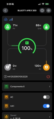

I have a question about my Bluetti system in Self-consumption mode.
When the sun is shining and the PV panels are producing, the app shows that the unit still draws part of the power from the grid, at the same time as from PV. If I disconnect the grid input, then the PV immediately covers the whole load, so there is clearly enough solar power available.

Apex 300 With B300K, now for example i have maximum solar hour in my zone and is mixing consumption from grid and from pv, and if i take out power cable from grid, al consumption go to PV (like 300-400W)
