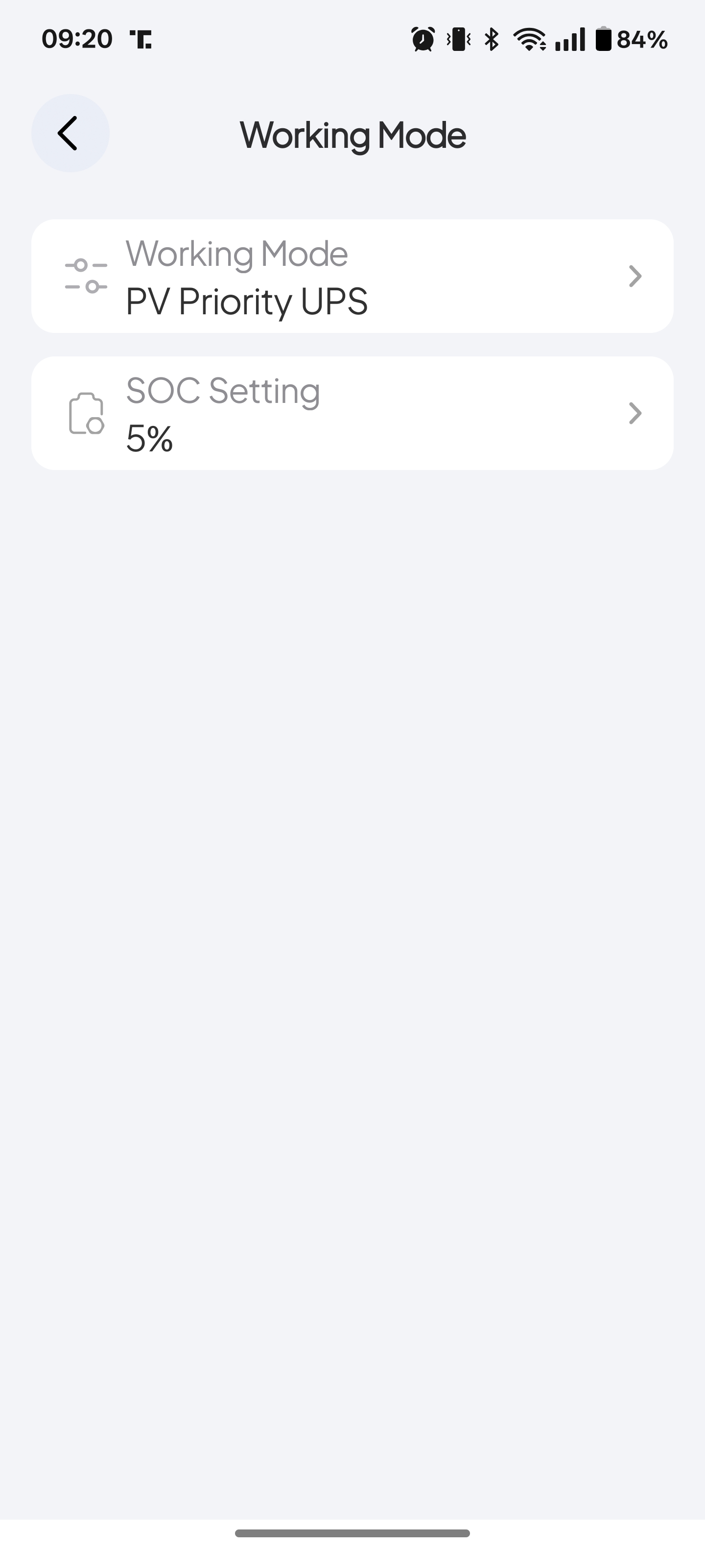

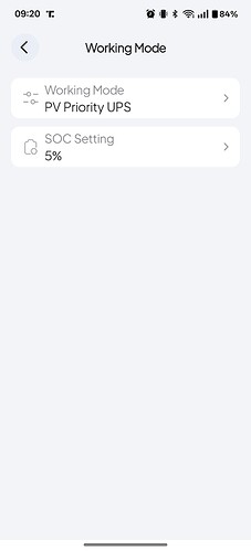

Hi all, We have two AC500 with one each B300S running in dual phase. The PV priority setting has worked like a charm for the past year. We expanded our system with one B300K per system and now it won’t switch to the grid. Last night, it bypassed the set SOC setting, and the system shut down. This morning, I isolated each battery, and all four said that the firmware is up to date.
I’ve tried everything that I’ve read to no avail. I believe it’s a firmware issue as all four batteries are recognized and charging. Please help as our system won’take it through the night nor through my work day on Monday. :slightly_frowning_face:

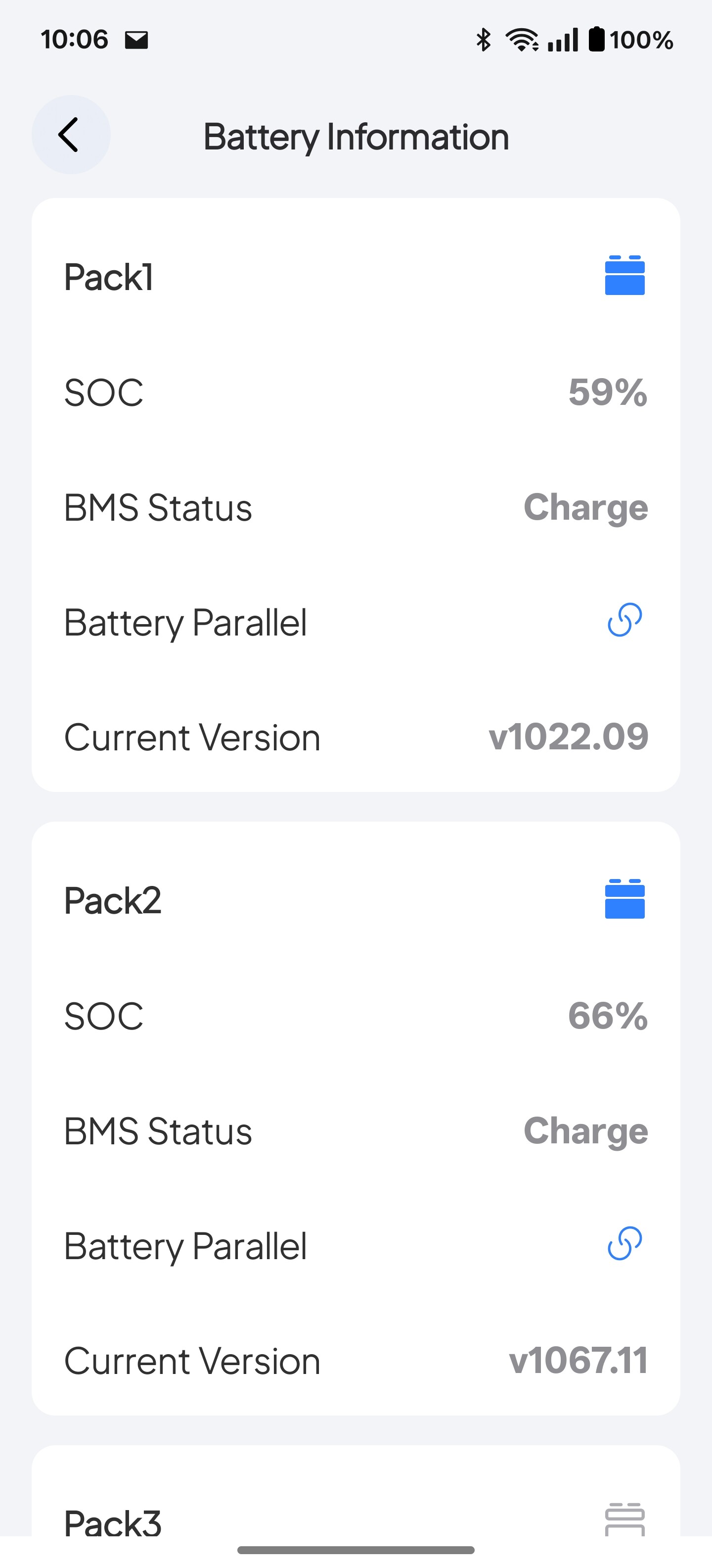

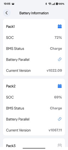

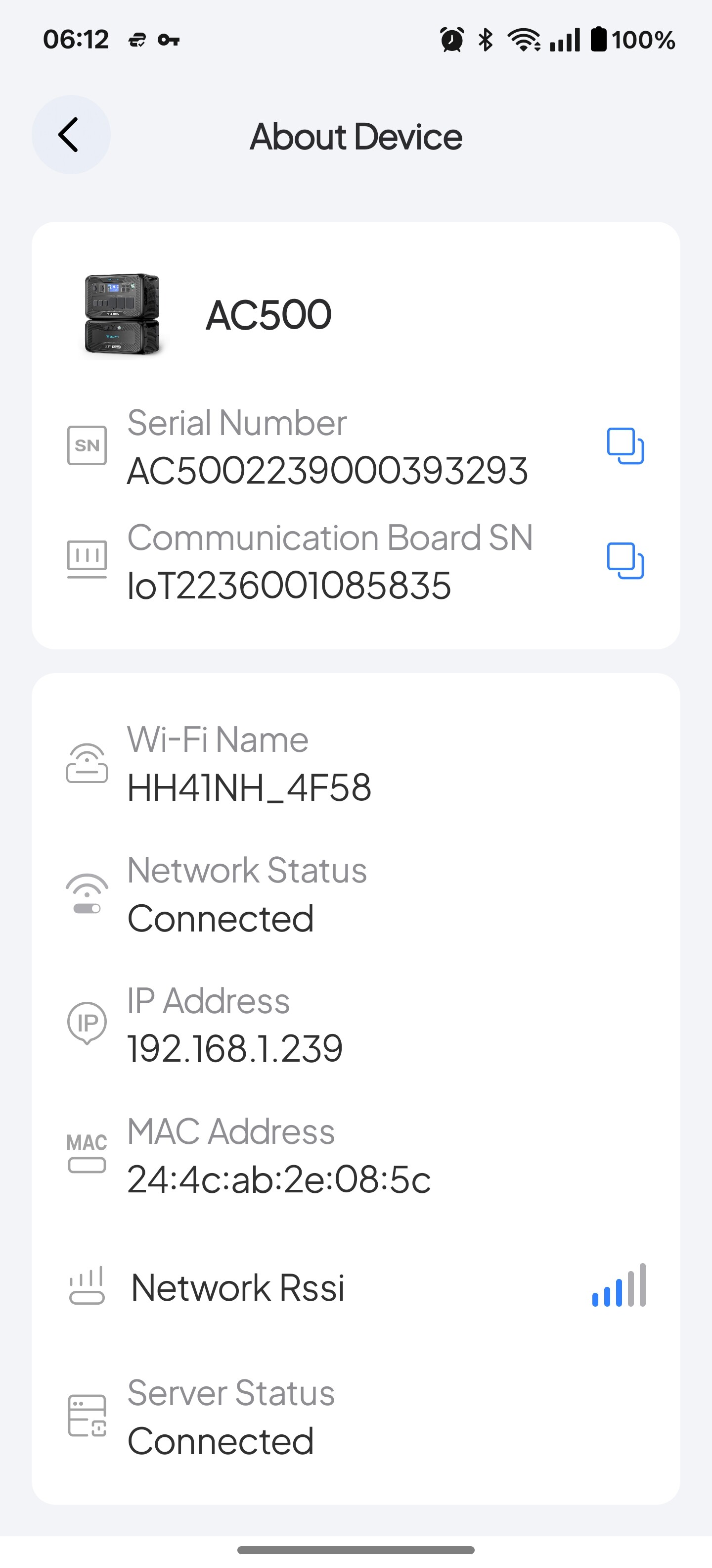

Hi @bviwahine, We truly care about the issue you’ve raised. Could you please share a screenshot of your UPS settings page, along with the SN code and firmware version of your AC500?
We’ll check to see if the issue can be resolved.
It won’t charge or recognize the grid in any configuration. I’ve tried single phase, dual phase, no solar connected, solar connected, nothing. The grid is not recognized.
I’ll have to send the ac500s firmware versions when I get home tonight as it appears the wifi needs updating.
Both ac500 have the same firmware
Hi @bviwahine, We have applied to upgrade your BMS, our IT department will push the latest version of firmware to your machine in 24 hours. Please upgrade it tomorrow.
Please only connect 1 B300 with the AC500 each time, and do not load any device when upgrading it.
After that, please do a complete cycle of discharge and charge to correct the SOC. The problem will be resolved.

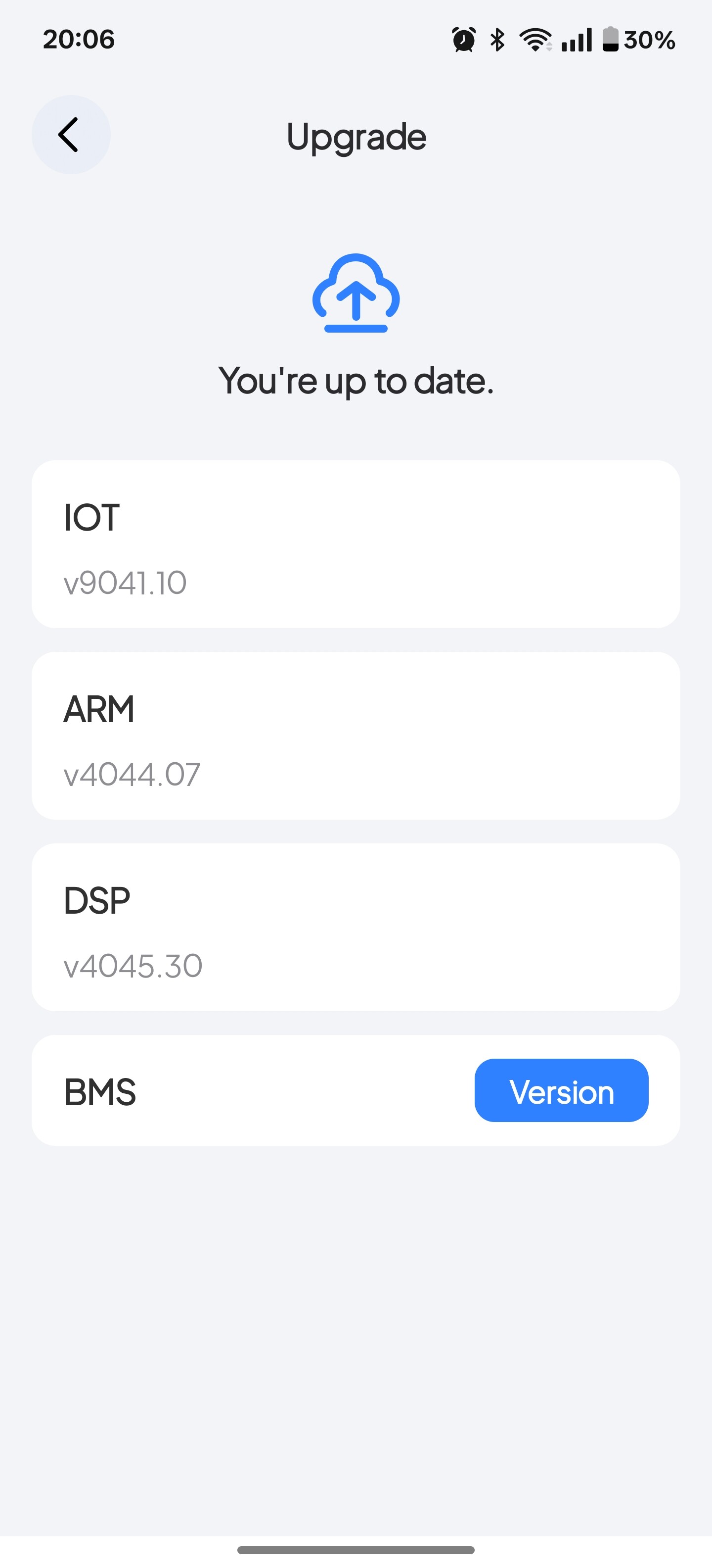

Hi @bviwahine, We have now pushed BMS v1022.14 and BMS v1067.13 to your two AC500 units.
Yes, each time please only connect one battery that needs BMS firmware upgrade during the upgrade process.
Hi,
I had no trouble with the upgrades. I did each battery individually and they were successful.
How should I do a complete cycle of discharge? I set the system to standard UPS, charged the batteries by solar, and let them deplete (the master depleted much quicker). The system still won’t charge from the grid. Please advise as to how to proceed or what I did wrong.

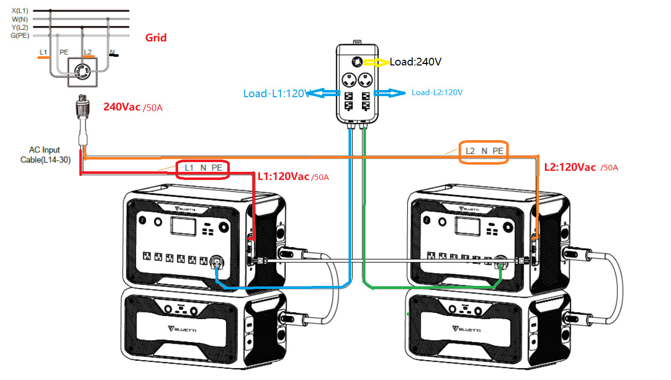

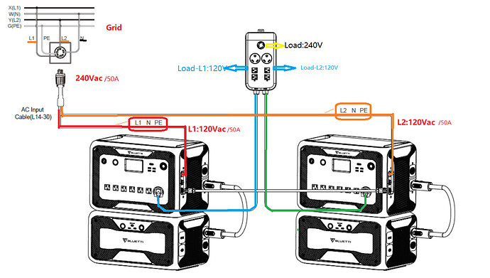

Since the AC500 can charge normally in single-phase mode, it indicates that the unit itself is free of faults. Please assist us with the step-by-step troubleshooting as follows:
  1. Refer to the connection diagram provided below and confirm that the connections are made in accordance with the diagram.
  2. Verify that the system’s split-phase output settings are correct. Set the two units as “Master” and “Slave” respectively.
  3. Disconnect the load connections.
  4. Connect the split-phase grid—L1-N (120V) and L2-N (120V)—to the two units.
  5. Check the unit’s LCD screen: tap the grid icon to enter the grid display interface. Does it show grid information? It usually displays as 120V/60Hz.
  6. Is there any fault alarm on the system?
  7. Are all loads connected directly to the unit’s output ports? Is there any newly added load that is connected to both the distribution box and the unit’s output ports simultaneously?
We look forward to your feedback.
